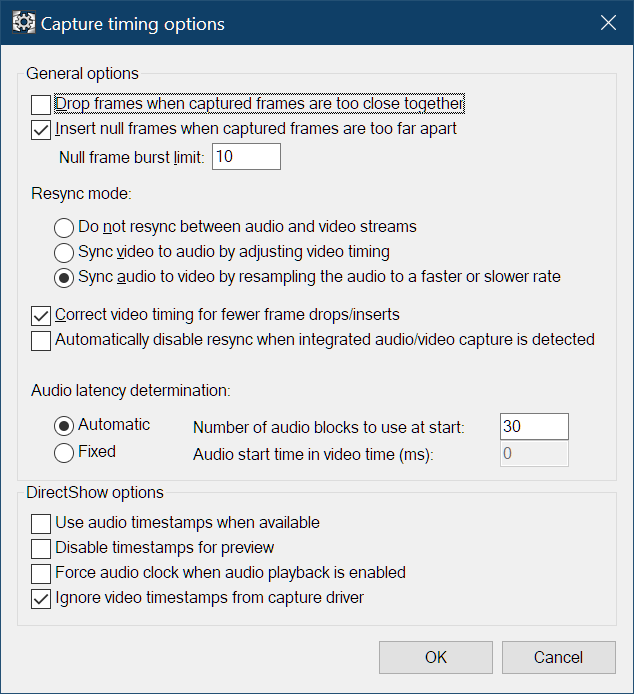

    I don't use version 1911, only the latest x64 build 2.1.3.667. I have frame dropping disabled in VirtualDub, so if something drops frames, it's the device, not the program (you can't set this in AmarecTV, it always drops more frames than VirtualDub).
    Frame dropping improves when TBC is enabled (but that's later), in VirtualDub it drops to around 0 (but not in AmarecTV), so as you can see my hardware is completely fine.

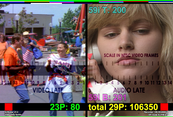

    Hi rgr, Bogilein, aramkolt. I have also "built" my own test pattern for A/V sync and field-fidelity using a few publicly-available sources.
    Then last week, I saw this interview: https://www.retrorgb.com/interview-with-video-preservationist-peter-b.html

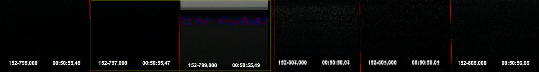

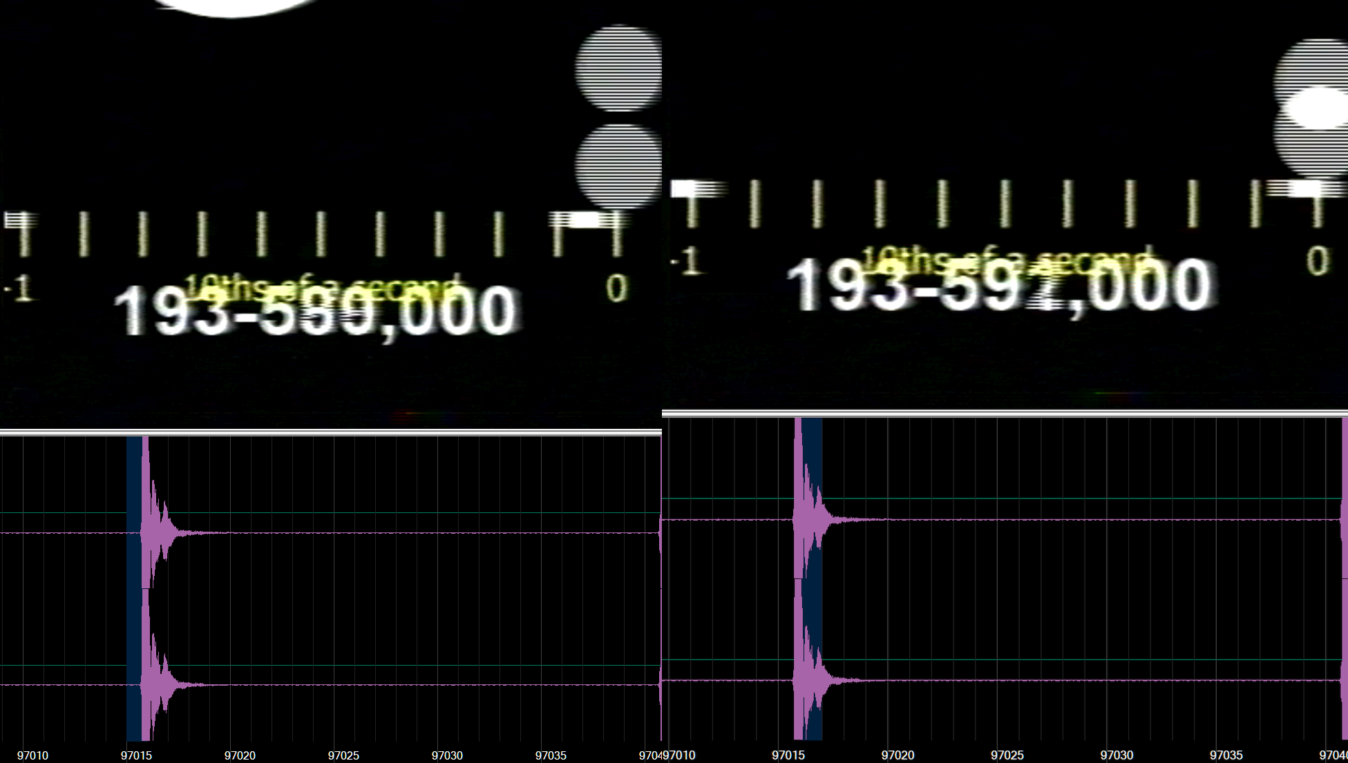

    All the “detectable issues” that show an image, are actual “timing interventions” that 4 different ADCs introduced. Ranging from 1000 to 12000 EUR from low-pro to broadcast-bling gear.
    The system allows to detect if /any-and-all/ images (fields/frames) arrive in the right order (time and top/bottom) – throughout any signal chain.

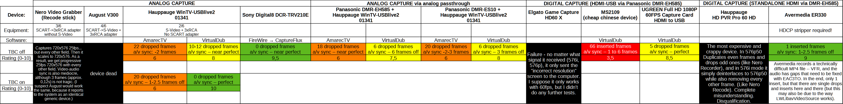

    The test procedure is described above, you can also see the screenshots -- these are 180000 numbered frames recorded on a VHS tape. It was enough to set the dump to a frame with a counter of 0 and move forward 180,000 frames (I checked every few to a dozen thousand). Then you can see that AmarecvTV's reports have nothing to do with reality.
    My tests confirm your own -- in contrast to Alwyn's experiences.
    In addition to post #23 which disproves the claim that AmarecTV does not record drops/inserts, I have just done a bunch of tests with a very bad tape. My conclusion is that AmarecTV and Vdub both report Inserts accurately, verified by going through the capture files in VDub with Shift ].
    All my captures were stabilised with either a Pioneer 645 or a ES10. I therefore conclude that the claim that both do not report dropped/inserts is invalid.
    In any case, every time my tape was stabilised and captured with ATV, there were no drops/inserts.

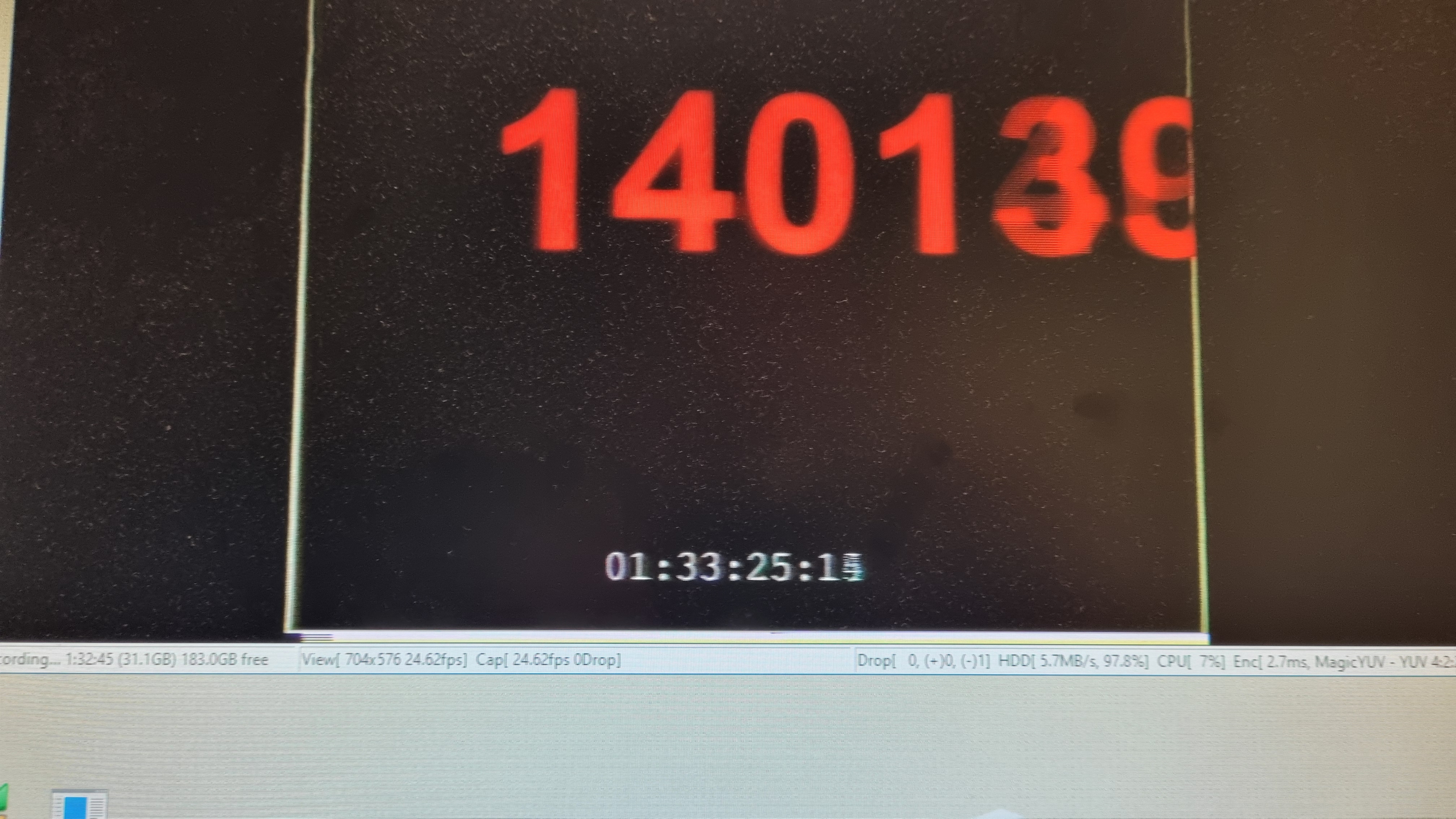

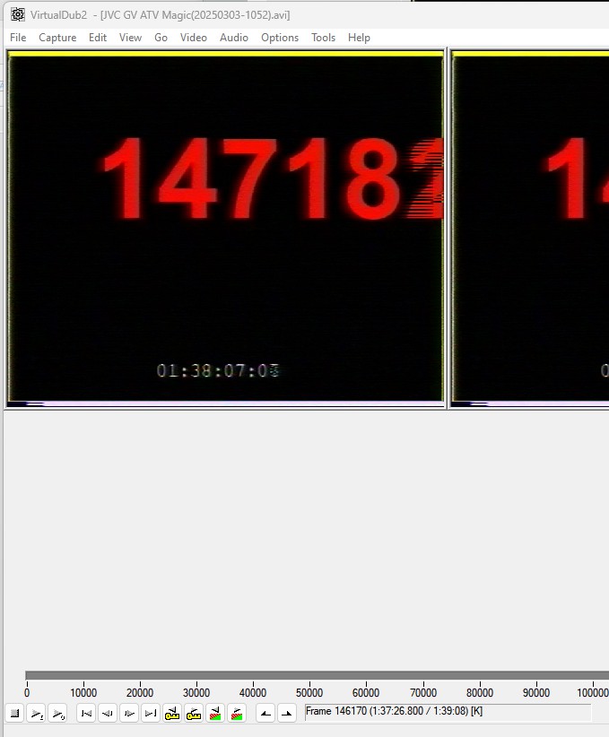

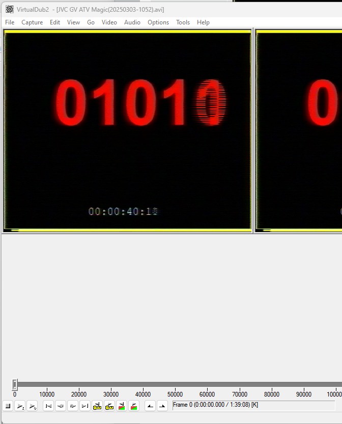

    Start:
    [Attachment 85887 - Click to enlarge]
    End:
    [Attachment 85888 - Click to enlarge]
    Screenshot of ATV towards the end:
    [Attachment 85885 - Click to enlarge]
    VDub found no dropped frames.
    ATV report attached.
    System: JVC 5700, IOData GV-USB2, AmarecTV into MagicYUV, Intel i5-750, Win 10 64bit, connected to the 'net
    Last edited by Alwyn; 5th Mar 2025 at 04:27. Reason: Updated the Start and End images to include the VDub frame count.

  6. Originally Posted by Alwyn View Post
    Originally Posted by Brad
    Now try without the stabilizer in-line and check whether AmaRecTV accurately reports drops/inserts. I mentioned the issue 9 years ago.
    Start:
    End:
    Some doubt here about the significance of this test:
    If the video content on the tape is the frame (or field) number on a static (e.g. black) background only, the average analog signal level is pretty constant over time. Means the luma+sync signal on the Y-wire does not put any challenge on the DC restoration and AGC of the receiving device, which would be critical for the device's sync pulse and vertical frame pattern detection capabilities (slicer). The test result for a static background may therefore be optimistic. For a more conclusive test I would suggest to superimpose the frame/field number onto a real (natural) video with the usual "wild" luma and chroma fluctuations. I suspect that it can make a (device dependent) difference.

    b) Hauppauge USB-Live2 --> VirtualDub2
    PERFECT -- 0 dropped frames!
    A/V sync -- perfect synchronization at the beginning and end of the test (attachment 1).
    Rating: 10/10
    I searched the entire AVI file from VirtualDub2 and found a single image glitch. The VCR couldn't read two frames, and they were replaced with adjacent frames, so both video continuity and synchronization were maintained (attachment 2).
    Using a VCR with TBC + Hauptpauge USB-Live2 + VirtualDub2 is the ideal combination for now, as is using a VCR without TBC and a miniDV camcorder (Sony Digital8 DCR-TRV210E) as an analog-to-digital converter and capturing via FireWire. Theoretically VCR with TBC and Hauppauge should be better due to the lossless quality, but that remains to be seen after comparing the captures.
Name:	TBC-Haupt-VDub-bad frames.png

    Originally Posted by aramkolt View Post
    Not sure how I'd put all the test features I'm seeing there in your screen capture though? Guessing it is probably a rather large file that is too big to post unless it's on repeat or something?
    I combined several different clips and added this test at the beginning and end:
    https://www.youtube.com/watch?v=ucZl6vQ_8Uo&list=RDucZl6vQ_8Uo

    Summary (attachment).

  22. My experience with Amarec:
    Seems that I never got in its report (log) any reported dropped frames, I only get occasional inserted frames. Checking the captured file in Vdub, the inserted frames - as reported in the Amarec log - are easily identified as duplicates. Stepping backwards and forward from there I sometimes find the associated non-reported dropped frame, sometimes not (or it is too far away), so there seem to be "orphaned" inserts for keeping A/V in sync.
    @rgr: Which version of Vdub were you using? and what were its settings?
  23. Member
    Aug 2018
    Wrocław
    x64 v2.3.0.845
    But I could also use a slightly earlier version.
    However, the capture module seems to have remained unchanged for years.
    I turned on the last option ("Ignore video timestamps") because of the UGREEN device -- with it turned off I had a lot of drops. Normally I had it turned off.

    I still have my doubts. I just did a short test using a dodgy VCR that has a very slow rolling motion, causing instability in the video. AmarecTV and VDub reported no dropped or inserted frames, with VDub reporting 2 inserts. No dropped frames were found in the AmarecTV video by the VDub checker; in VDub the two inserted frames were found by the checker.
    But, the frame count changed drastically every time the rolling instability was encountered. I therefore conclude that if the VCR/tape is putting out unstable video, which is then stabilised (in my case, by a Pioneer 645), the capture program will get clean, stable video with the instability baked in. When that video has a timecode, you'll see what looks like errors/drops, even though nothing of the sort has occurred at the capture point.
    So I surmise that, if there is a glitch in the tape which is then burned-in by a stabiliser, a test of this nature, comparing frames, will be invalid.
    I've attached the sample for the VDub capture.
