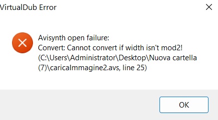

    FFImageSource("C:\Users\Administrator\Desktop\Nuova cartella (7)\1_E.E.-Hiolle_Narciso.jpg")
    ConvertToYUY2(interlaced=false)
    colorMatrix(mode="Rec.601->Rec.709")
    ColorYUV(levels="PC->TV")
    [Attachment 86327 - Click to enlarge]
    what can it be?
  2. 4:2:2 YUV video must be mod2 in width. So crop a pixel from the width, or add one.
  3. I'm a poor cat.
    In what way I have to crop a pixel from the width, or add one ?
  4. Use Crop() or AddBorders().

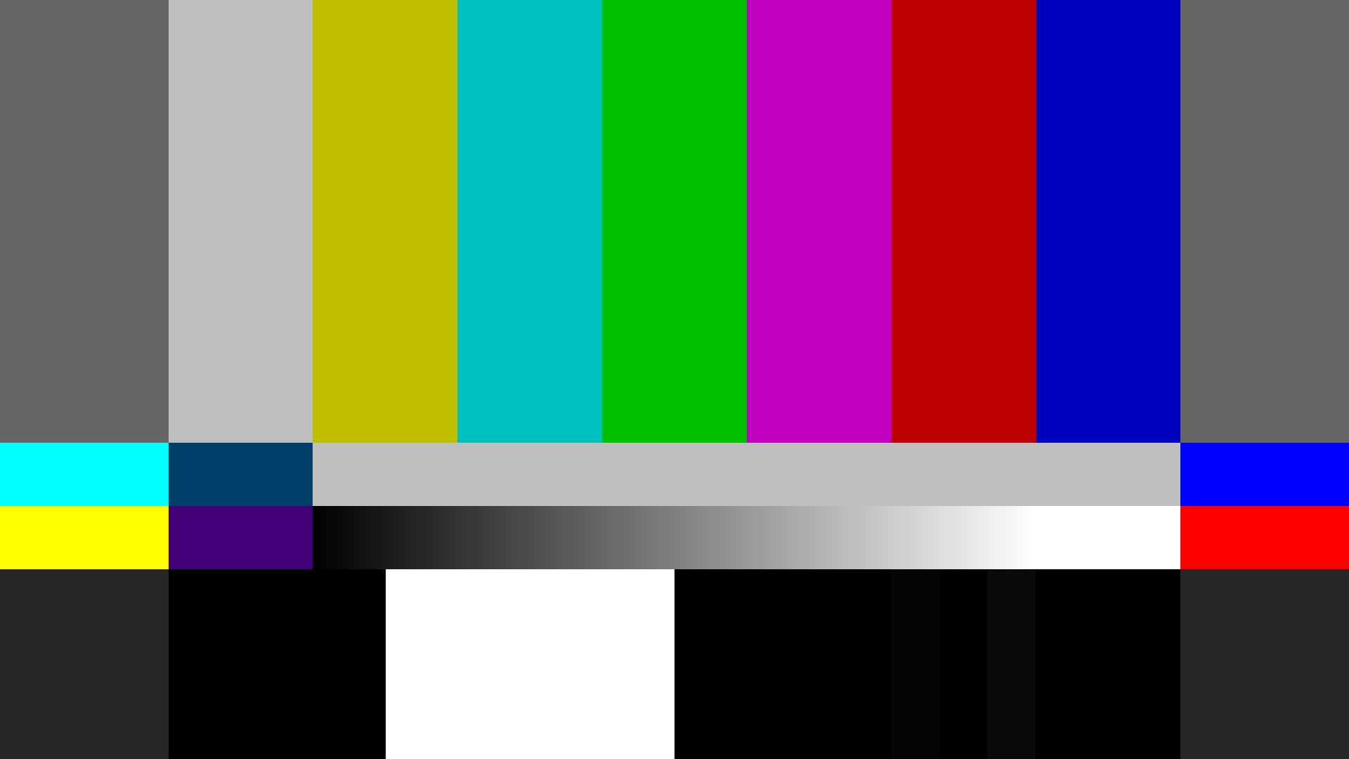

  11. Image
    [Attachment 86369 - Click to enlarge]
    I use
    ffmpeg.exe -an -y -i "C:\Users\Administrator\Desktop\Nuova cartella (7)\SMPTE bars .jpg" -vf scale=w=-2:h=1080:in_range=tv:out_range=pc,colormatrix=bt470bg:bt709,pad="width=ceil(iw/2)*2:height=ceil(ih/2)*2" -frames:v 1 -update 1 -q:v 1 -huffman 1 -intra_matrix 8,8,8,8,8,8,8,8,8,8,8,8,8,8,8,8,8,8,8,8,8,8,8,8,8,8,8,8,8,8,8,8,8,8,8,8,8,8,8,8,8,8,8,8,8,8,8,8,8,8,8,8,8,8,8,8,8,8,8,8,8,8,8,8 -color_range 2 v:\ref.jpg
    to generate a ref.jpg OK (levels ok)
    but If I try to use the same line but with the final output file ref.TGA
    I get that: levels of ref.TGA are different to the ref.JPG, even if the commandline if the same
    Can Someone explain to the poor cat if is there a way to get the same levels?
    [Attachment 86370 - Click to enlarge]
    thanks
