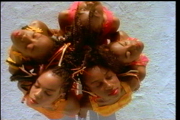

  8. Ok, here are some test captures.
    This is using the procamp defaults:
    set_adrift_default.avi
    This is with brightness and contrast adjusted to take up the entire 0-255 range and sharpness set to 0:
    set_adrift_level_adjust_sharp_0.avi
    I tried making a capture with the range 16-235, but it was super washed out so I decided not to include it.
    Here's a screengrab from the procamp default video:
    [Attachment 85811 - Click to enlarge]
    Here's a screengrab from the procamp adjusted/sharpness 0 video:
    [Attachment 85812 - Click to enlarge]
    And here's an Image Slider:
    https://imgsli.com/MzUzNDEy
    Let me know what you think! Thanks.

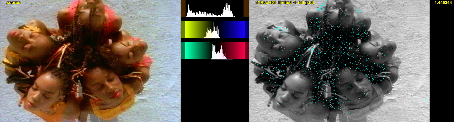

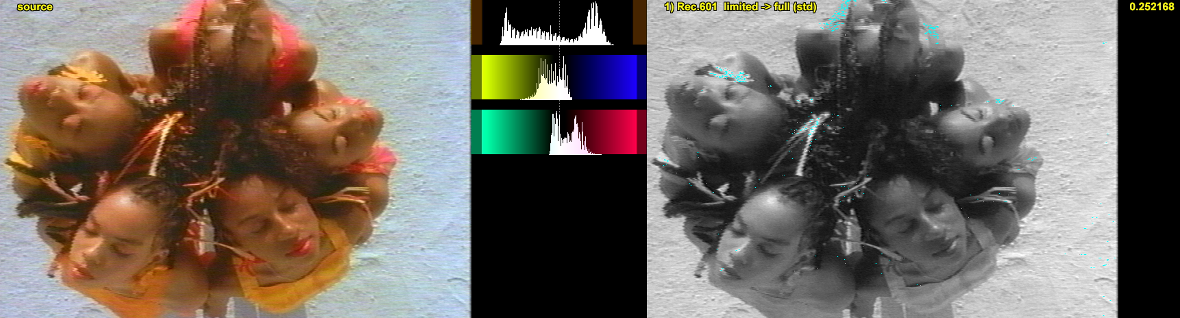

  10. Looking at the screenshots only (may look at the .avi later du to temporary network issues):
    The first looks ok. Few harmless out-of-gamut RGB pixels (cyan on the right) when decoding with the standard YUY->RGB conversion matrix. These will however "disappear" for TV playback using the limited->limited conversion equations. So nothing to worry.
    The second has less "bad (means clipped) RGB" even for the standard conversion but it looks a bit washed out - no surprise, luma swing shrunk too much (darks elevated).

  11. Network is back. So here your 2 versions (using the standard Avisynth Rec.601 conversion "YUV limited->RGB full"). The Cyan pixels on the right indicate clipped RGB (percentage as number).
  12. Captures & Restoration lollo's Avatar
    Jul 2018
    Italy
    As Sharc said, the second capture is washed out, because you streched the levels to unnecessarly fill the available range. This is not recommended, and you are going against the nature of the source (and potentially introducing gaps in the histograms, not in this sample).
    Once more, you act on the procamp just to stay inside the capturable range of your card (or to stay in 16-235 range if you prefere), and do all the rest in postprocessing (with caution, expanding too much will result in the same problem).
    Concerning the sharpness parameter I prefer the default, because in this sample (and also in general with the GV-USB2 and the USB-Live2) is not causing halos.

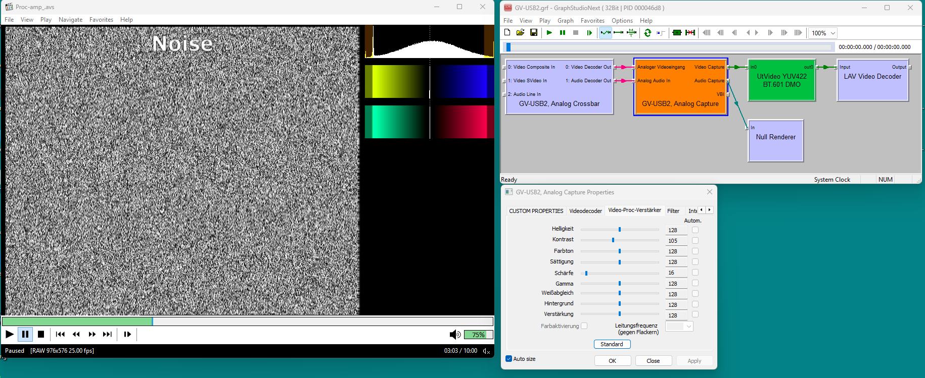

  15. One could also prepare a DVD with well defined YUV testpatterns, play it in the "passthrough" DVD recorder for example and capture it, or play it and visualize the levels/histogram in realtime via a filter graph (Graphedit) + script + SW player (PC).
    Something like this:
    [Attachment 85820 - Click to enlarge]
    Capture devices use at least 10bit ADCs, so its a matter of the manufacturers internal scaling how they map and position their "defaults" into the 0....255 8bit range, how they do or do not clamp or clip. Hard clipping at Y=16 and 235 is a "poor man's solution" for pseudo legalizing, IMO, and such hard clipping is difficult for compressing.

  17. Originally Posted by Sharc View Post
    So based on those videos you posted (thank you by the way), there's some black clipping at the beginning of both of my samples (below y=16) and some white clipping at the end (above y=235). Is that correct?
    It does appear that there is more clipping in the levels-adjusted sample than the default, and I agree that the default looks better and not as washed out.

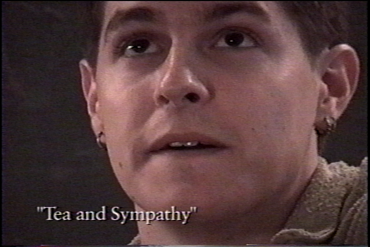

  18. Here's one more quick capture test.
    Brightness, contrast, and sharpness all set to defaults:
    [Attachment 85821 - Click to enlarge]
    Brightness and contrast set to default, sharpness set to 0:
    [Attachment 85822 - Click to enlarge]
    Here's the image slider: https://imgsli.com/MzUzNjU1
    I honestly cannot tell any significant difference between these two captures, although my eyes are getting pretty bad so others may see something that I cannot.
  19. Captures & Restoration lollo's Avatar
    Jul 2018
    Italy
    sharp 16 capture is little bit sharper (of course); look to the right eye while in the slider. The problem with excessive sharpness introduced by the cards is generating ugly halos. At first look is not the case here, and the difference is really marginal. Nothing to worry at first instance.

    This (non-typical) "artifical" video has a lot of out-of-gamut pixels (some of the "artwork" scenes nearly 100%!) which tend to get worse the more you boost the contrast and saturation, and the more one captures into the "illegal" levels range. Not a very suitable source actuallly to assess capture settings and quality.

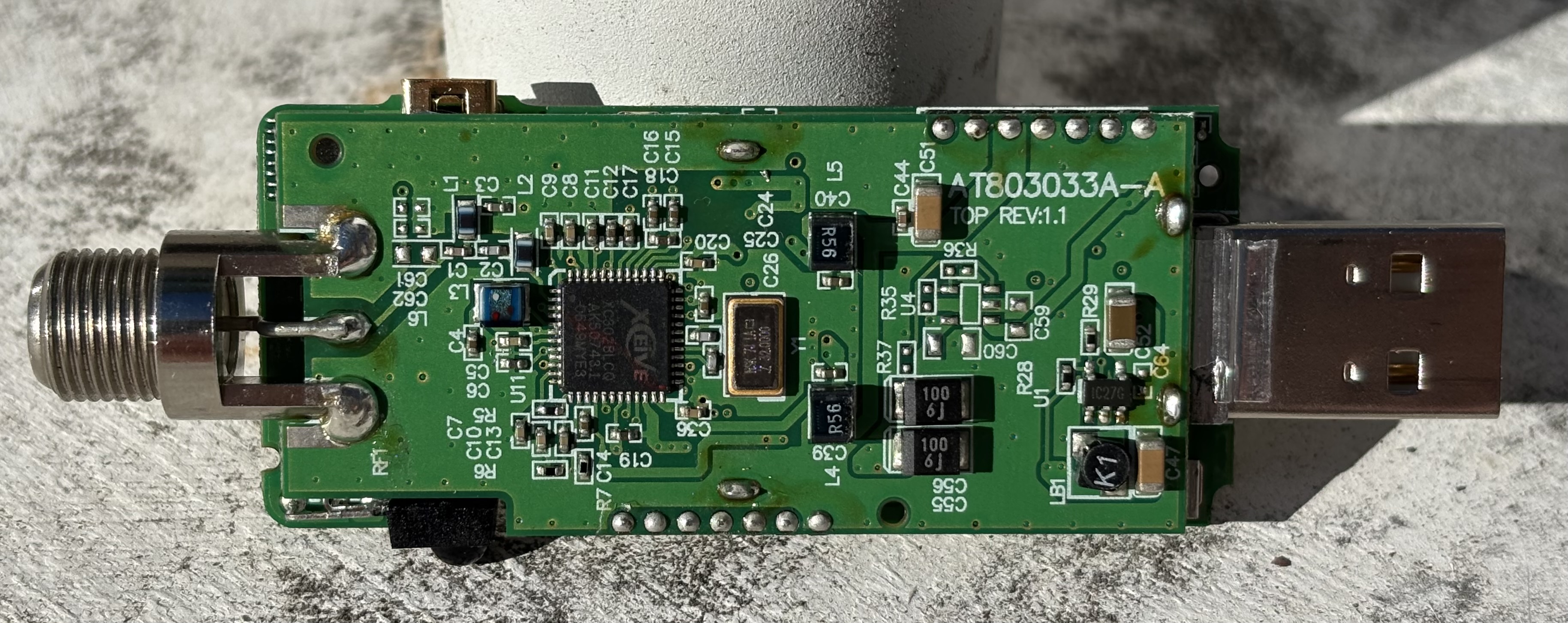

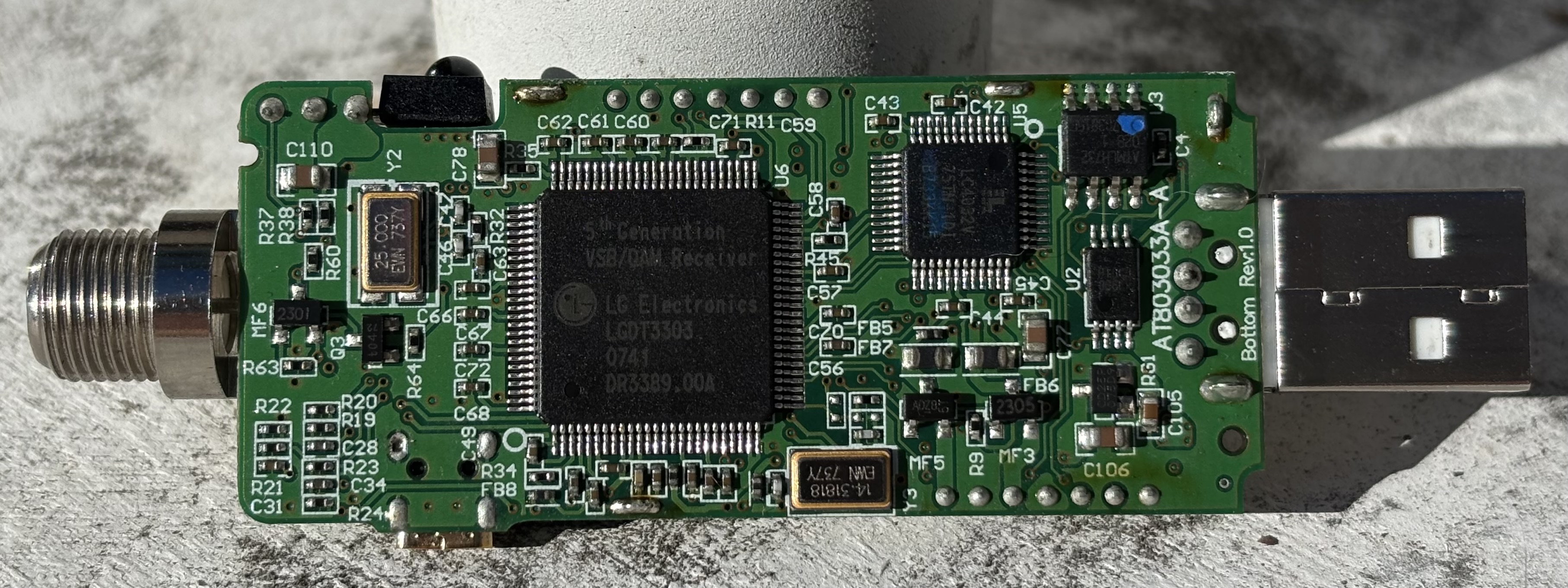

    I took my ATI USB 600 apart hoping to find a component that was scorched by the power surge and could be replaced, but it all looked fine to me, so I'll be selling it for parts. Apparently these units are getting very hard to track down and are now regularly selling for $150 on eBay in working condition. I am going to go a different direction and grab a few older VC500's off of eBay for cheap and see if I can figure out which of the various iterations is free of the AGC issues that some complain about. If I figure that out, I will let you all know.
    To close this out, I thought you all might like to see some high res pictures I took of the inside of my ATI USB 600 while I had it opened up trying to fix it. It's interesting to see what components were used to make this great little device.
    [Attachment 85851 - Click to enlarge]
    [Attachment 85852 - Click to enlarge]
    R.I.P. ATI USB 600
