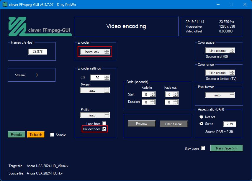

  7. If it should be x265, then you can use hevc_amf (AMD hardware) or hevc_qsv (Intel hardware) in addition to hevc_nvenc (nVidia hardware), both with or without hardware decoding support.
    Try them with clever FFmpeg-GUI, if the hardware support is missing, you will get an error message.
    [Attachment 85280 - Click to enlarge]
