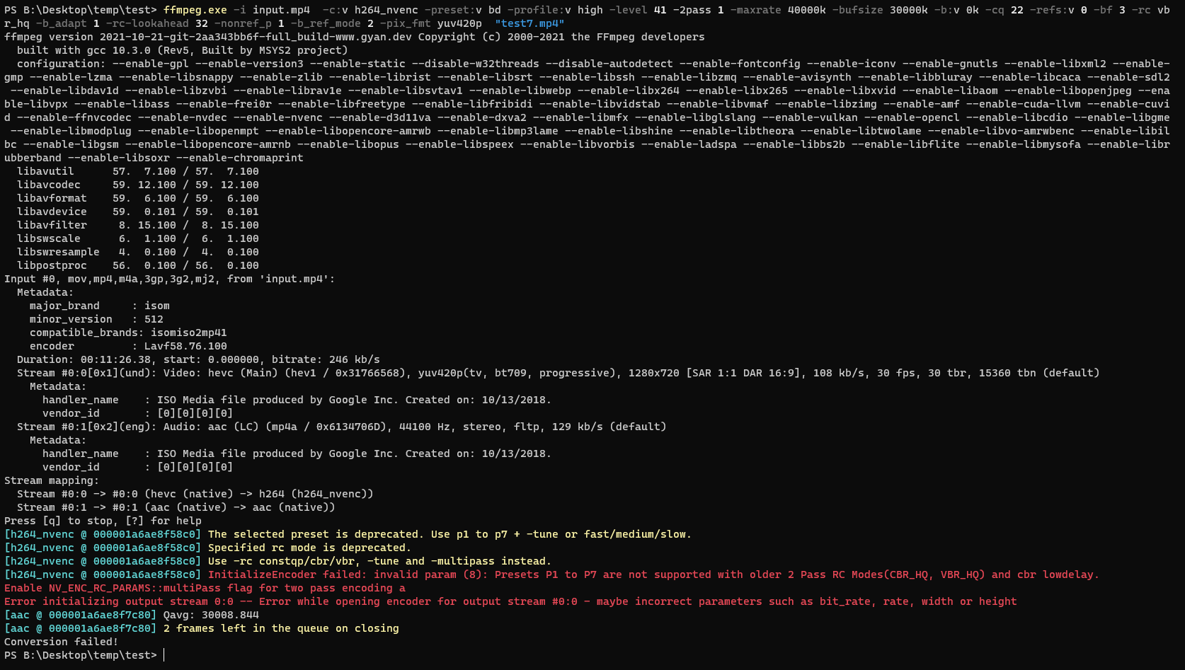

	did as instructed. no good.
 [h264_nvenc @ 000001a6ae8f58c0] The selected preset is deprecated. Use p1 to p7 + -tune or fast/medium/slow.
 [h264_nvenc @ 000001a6ae8f58c0] Specified rc mode is deprecated.
 [h264_nvenc @ 000001a6ae8f58c0] Use -rc constqp/cbr/vbr, -tune and -multipass instead.
 [h264_nvenc @ 000001a6ae8f58c0] InitializeEncoder failed: invalid param (8): Presets P1 to P7 are not supported with older 2 Pass RC Modes(CBR_HQ, VBR_HQ) and cbr lowdelay.
 Enable NV_ENC_RC_PARAMS::multiPass flag for two pass encoding a
 Error initializing output stream 0:0 -- Error while opening encoder for output stream #0:0 - maybe incorrect parameters such as bit_rate, rate, width or height
 [aac @ 000001a6ae8f7c80] Qavg: 30008.844
 [aac @ 000001a6ae8f7c80] 2 frames left in the queue on closing
 Conversion failed!
