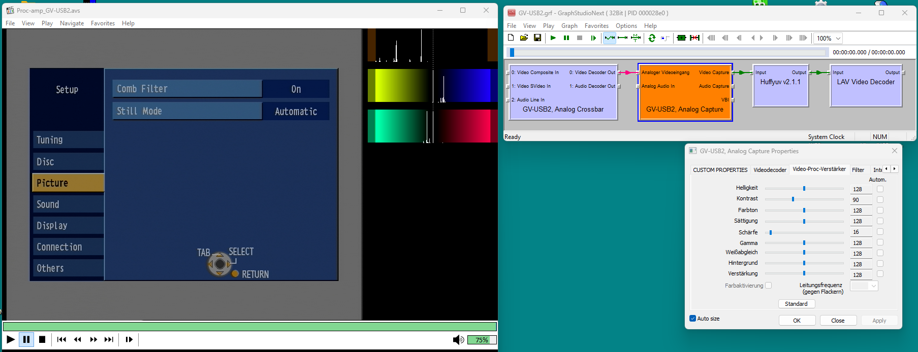

See here:
https://forum.videohelp.com/threads/401225-Histogram-for-Amarec-TV#post2614699
Example (capturing the menu of the ES15) with the histogram in real time, using
-MPC-HC
-Avisynth
-GraphStudioNext
-AmarecTV
(The capture device is GV USB2, similar should work with the USB-Live2. Instead of the histogram one can show the waveform monitor on the side or on top)
[Attachment 85058 - Click to enlarge]

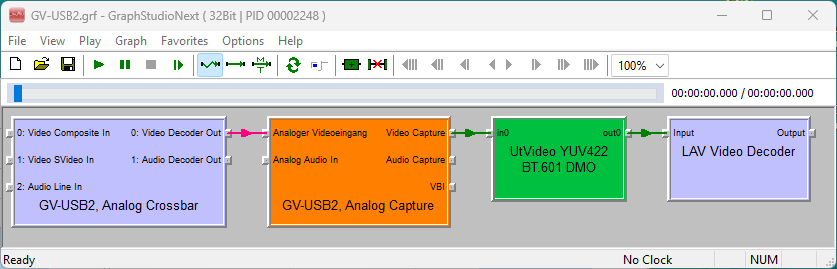

Sharc, what's your code for ProcAmp_GV-USB2.avs?Originally Posted by Sharc
Here we go:
Code:DirectShowSource("GV-USB2.grf",audio=false,framecount=15000) converttoYV16(interlaced=true) #convert to planar ## uncomment one of the 4 options below as needed: Histogram("levels") # Histogram on the side #Histogram("classic") # vertical Waveform Monitor on the side #TurnRight().Histogram("classic").TurnLeft() # horizontal Waveform Monitor at the top of the frame #Histogram("color2") #Vectorscope ConvertToRGB32(matrix="rec601") -
Thanks Sharc. Found LAV Video decoder on VH download site.
All 32bit. MPC-HC 2.3.6 portable, Lav Filters 0.79.2.20
Try this filter graph. Opens here in Vdub32 and Vdub64.
[Attachment 85068 - Click to enlarge]
P.S. You cannot run AmarecTV at the same time. This procedure is for real-time proc-amp adjustments only. Once the settings are done, save, close all this and start AmarecTV for capturing as usual. It will use those procamp settings.Last edited by Sharc; 24th Jan 2025 at 06:53. Reason: typos

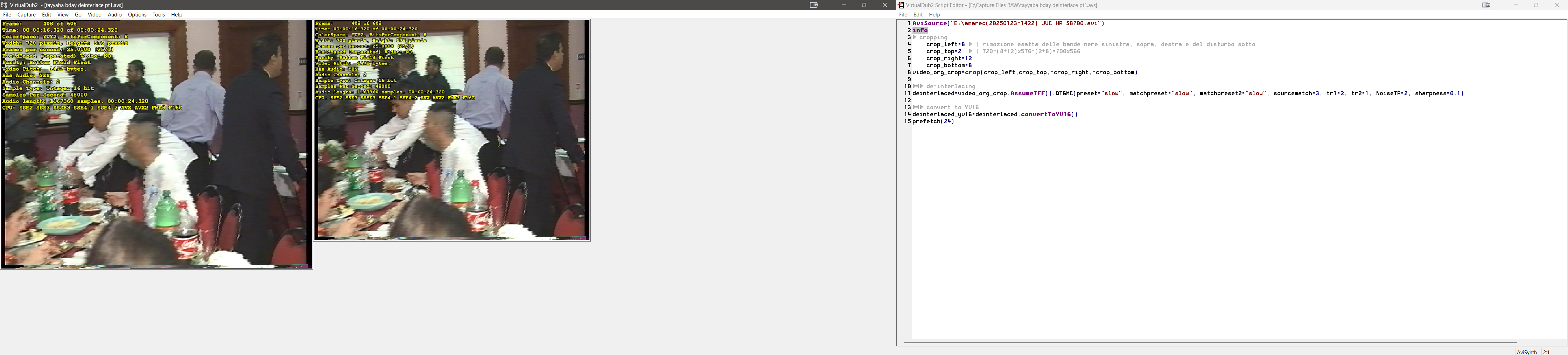

Got it Thanks, rgr. So in info it showing as Bottom field first but in my script I have AssumeTFF. Do I need to change this ?
See screenshot:
[Attachment 85238 - Click to enlarge] -
Change it to AssumeBFF and after a few frames you will see what setting is correct
