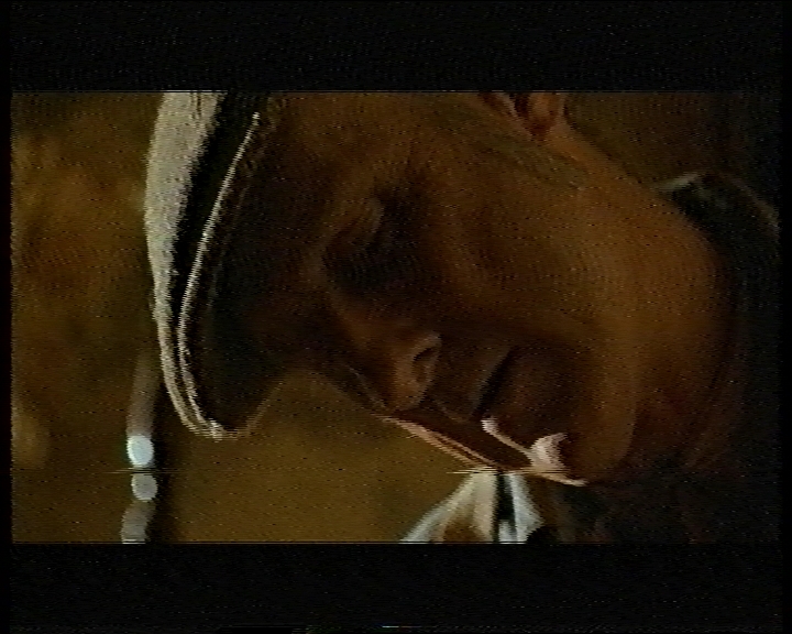

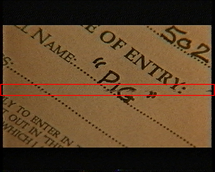

    today during capturing a tape I came across some horizontal line artifacts.
    [Attachment 85020 - Click to enlarge]
    I'm using a JVC S9500, and TBC was enabled. The VHS is "Babe" from 1996.
    The artifacts just last for around 1 frame and are occurring on different positions.
    Furthermore, it looks these artifacts are becoming more frequent, the further I'm into the tape. At the beginning they are seldom and at the end quite frequent.
    As this didn't happen with my previous test tapes, I'm wondering now what the reason is?
    Cheers

  2. If you have the TBC off, does it still do it? Also, if you recapture that same section, does that artifact show up on the same frame it did with the prior capture?
  3. Can you upload a video sample ?
  4. Capturing Memories dellsam34's Avatar
    Jan 2016
    It's called tape dropouts, There is nothing you can about it.

    See here. It is probably the tape.
    https://www.avartifactatlas.com/artifacts/video_dropout.html

  12. The dropouts are the least of the problems. First, there's a lot of horizontal time base wiggle. A line TBC like those on some Panasonic DVD recorders may help with that -- disable the VCR's TBC. Then there are vertical time base problems. The fields bounce up and down randomly. A better capture device might help with that. The Panasonic DVD recorder may help with that. Or a full frame TBC. And the video is very noisy. All this together make me think it was recorded at a very low tape speed. SLP?
    Note that the underlying video is progressive and could normally be field matched with TFM() to give 25p. But the vertical bounce is interfering with that.

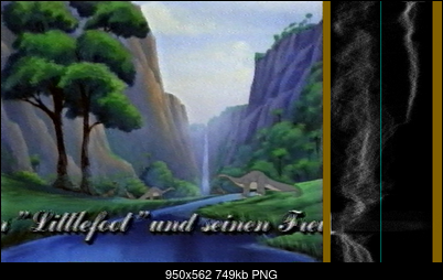

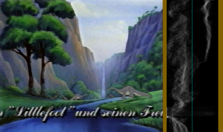

    I received the tape today, and capture with a JVC HR-S9500MS and a Hauppauge USB-Live 2.
    I confirm the problem is in the tape, because I see the same "instability" as the OP.
    Using other S-VHS VCRs does not help (HR-S9600 and HR-S9800). I do not have a Panasonic VCR with me at the moment to try a different brand.
    Unfortunately I also do not have with me my Panasonic ES-15 at the moment to check if it improves the vertical jitter.
    Here two samples of the raw capture:
    segment 1 s1.avi
    segment 2 s2.avi
    For what is worth, the following is a quick temptative of restoration

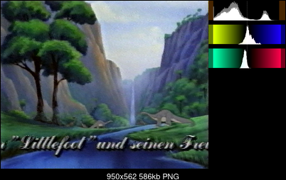

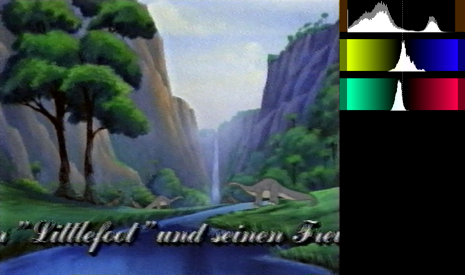

    did not touch the procamp; levels are ok (some accumulation on the blacks because the titles):
    Blind field restoration with QTGMC(preset="fast").SRestore(), attempt to reduce the jitter with StabMod() (not very effective), denoise with TemporalDegrain2(degrainTR=3) and sharpening with LSFmod(defaults="slow")
    result (no unfair comparison with the raw capture because field/frame architecture): step4.avi
    To OP: I will return you the tape in the next days
