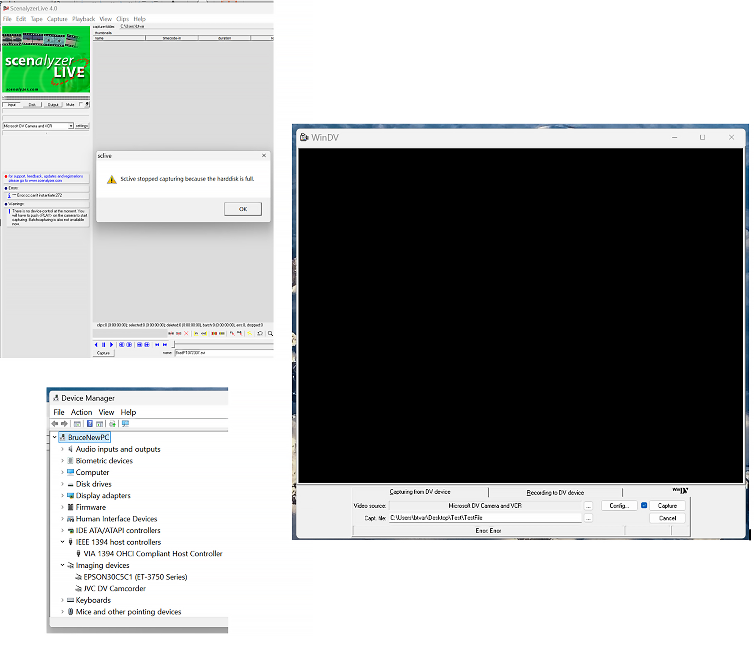

    Kansas City, Missouri
    Neither WinDV or ScenalyzerLive 4.0 will capture any video. Both produce errors. Nor do they display any footage in the apps. My camcorder is able to be seen in Device Manager. I followed Alwyn’s guides for both these apps. See Image Below:
    [Attachment 84252 - Click to enlarge]

    That Scenalyzer result could be promising. The "disk full" message is a known issue. Have a look right down the bottom of my Scenalyzer page here. One option is to capture to another drive.

  25. I cant help noticing SCenanylser stopped because disk was full. Have you checked your disk space?
    Sometimes it gives misleading messages or wont save to certain drives. Try another drive.
    Yes, that annoying issue comes back from time to time.
    See this topic for some suggestions:
    Scenalyzer reports full disk
