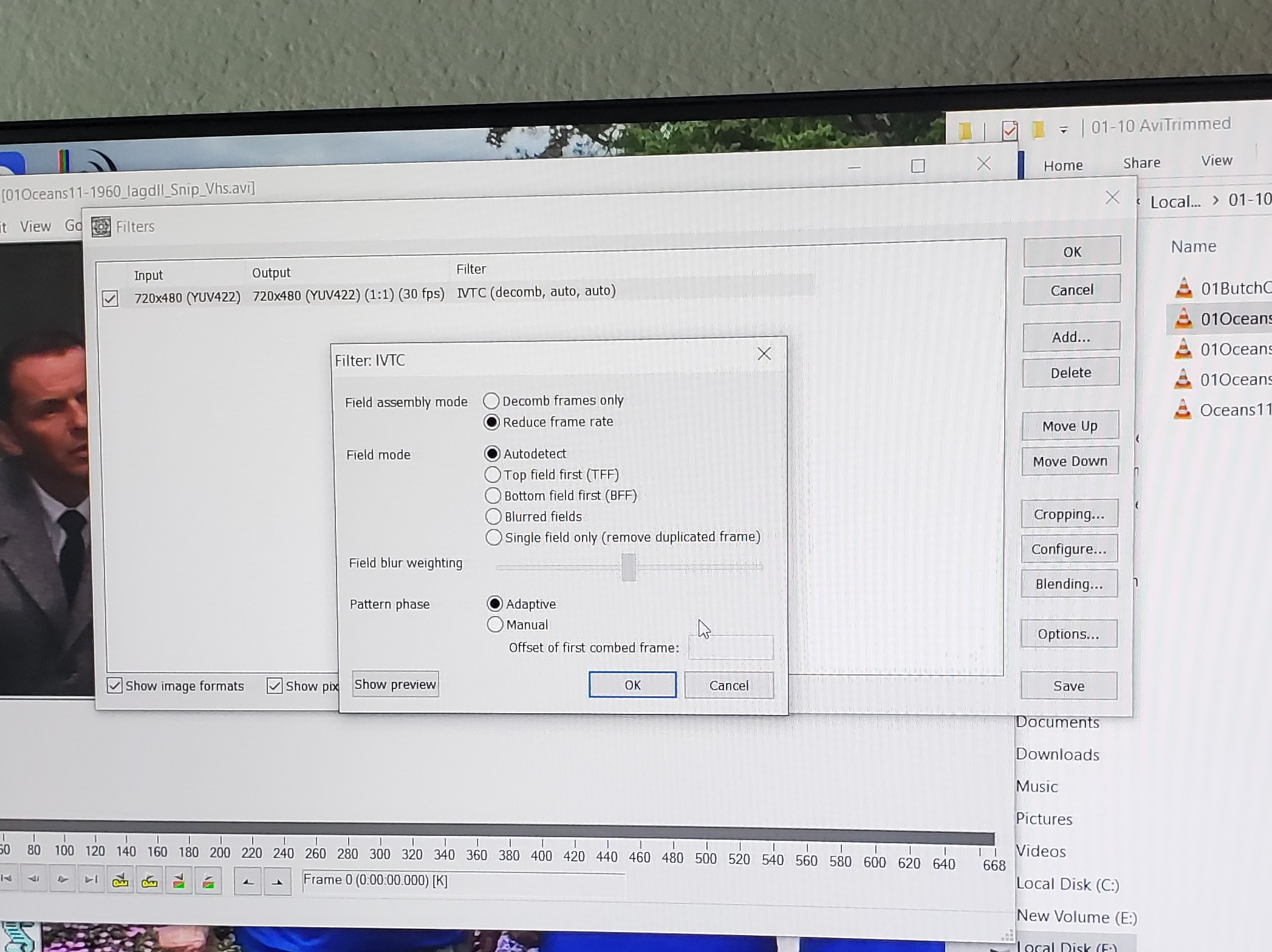

    Where is this information gleaned from “(orphaned field 731 in the source, IVTC to place a combed frame)”?
    I opened up Vdub2, poked around, and what I see according to Vdub2 the scene change happens at frame 365@12:179 to frame366@12:212. I do not know where to look for “(field 731 in the source)”?

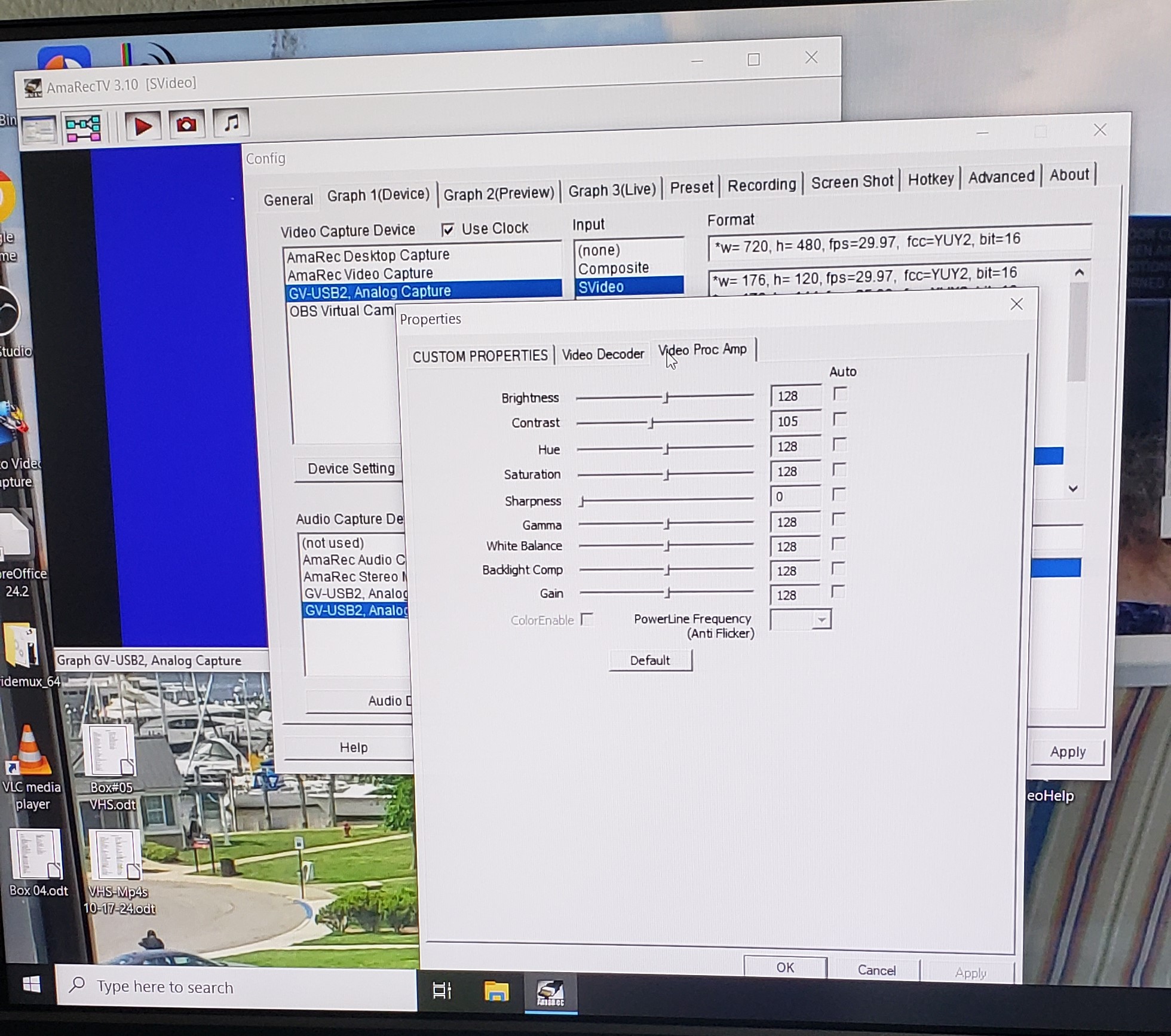

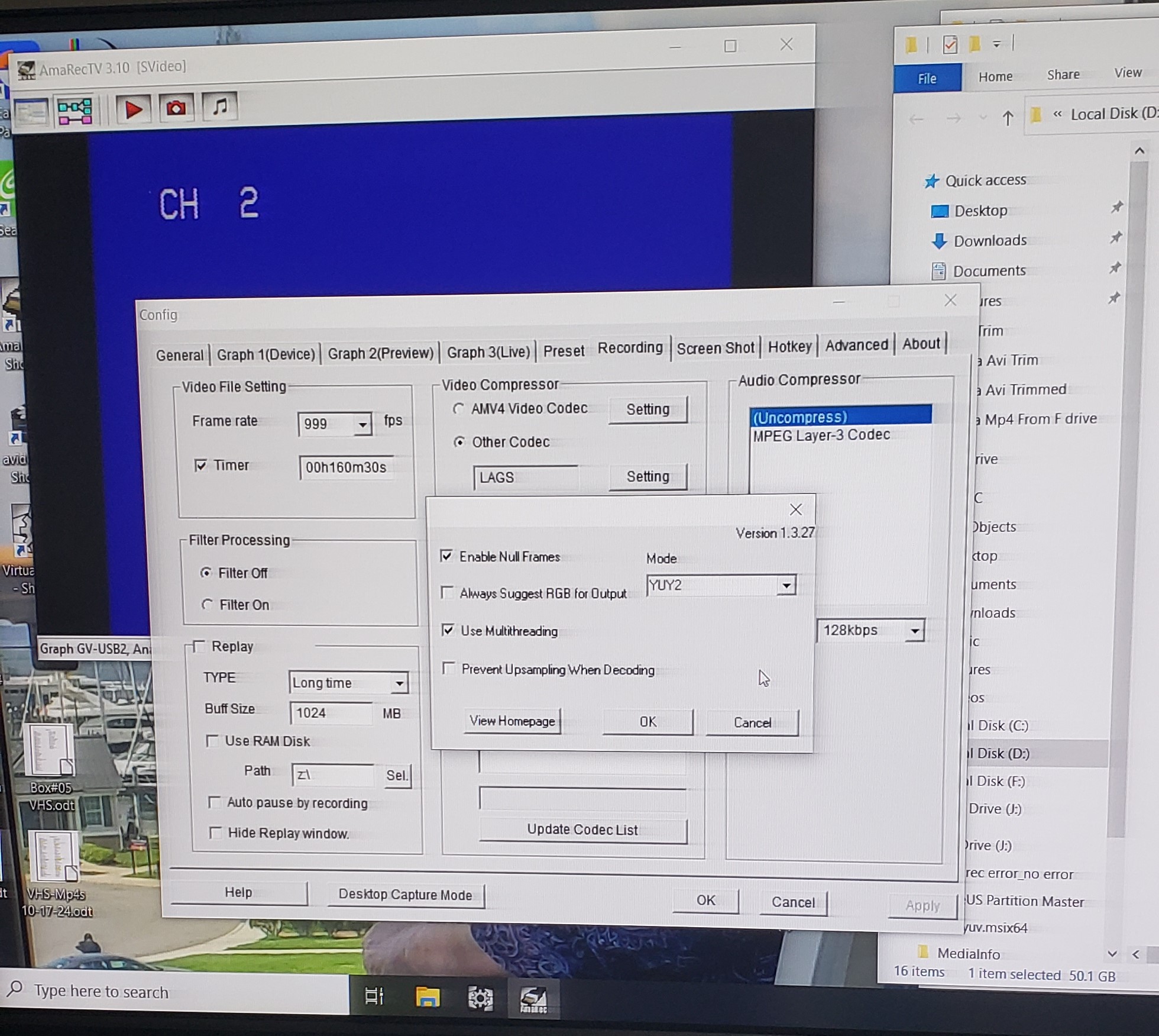

    I do use Lagarith. I was a die-hard huffyuv fan until a fellow traveler suggested I try Lagarith (https://forum.videohelp.com/threads/416452-AmaRecTv3-10-Win10), been using it ever since. As far as I know, as well, Vdub2 did not come with Lagarith. My copy of Lagarith came with the I-O Data GV-USB2. Lagarith then became a codec option for me in Vdub2, but never used until recently. Not sure what “buggy” means? I’ve had no negative experiences with Lagarith, as far as I know.
    The attached is/are the Lagarith setting that I’m using.

    It might vary slightly on what decoder you are using, the AVI driver (either using official lagarith, or vdub lagarith), or caching input driver. If you use file=>file information it will report what vdub2 is currently using.
    The following numbers are with the caching input driver:
    In vdub2, with the IVTC filter using the AVI, it would be frame 292. Notice the aliasing artifacts in the fingers, hair, clothing. Compare to the frame before.
    If instead of the IVTC filter, if you deinterlace using bob, double frame rate, top field first - Essentially you're examining fields (or scanlines) resampled as a full size frame. The field count is now same as the frame count . The field is 731 . If you go backwards, and examine there will be a 3 repeat : 2 repeat or 3:2 cadence to the fields. That is 3:2 telecine. The cadence is interrupted after 731. There is a single field from a new film frame, that is missing it's "partner" field, because the next frame is the next scene.

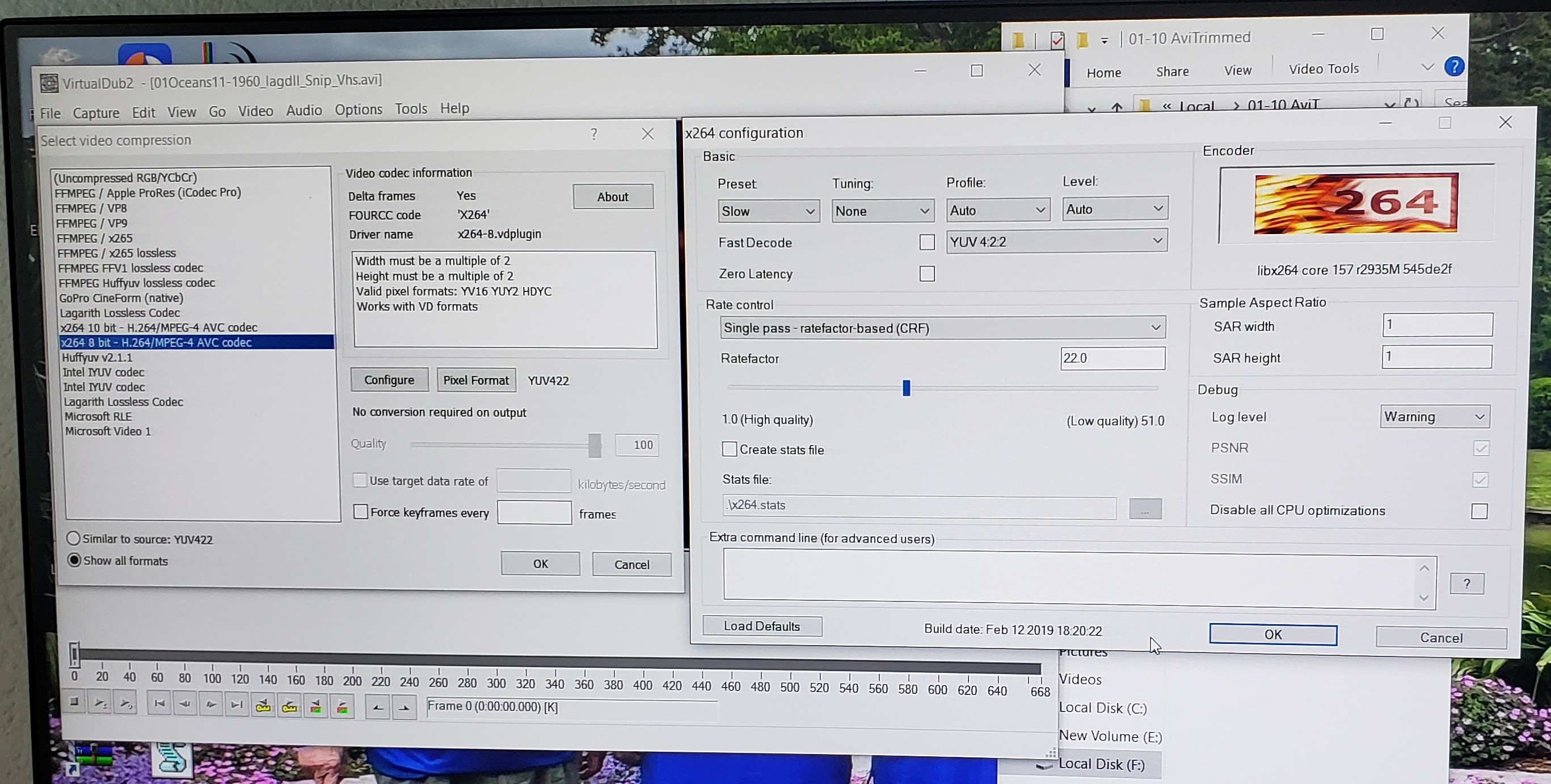

    I gather that “set the AR in the encode”, is in reference to an external filter that needs to be installed in or made available to Vdub2? If so, I haven’t a clue how this is done, yet.
    Yes , if you're using the bundled vdub2 x264 , there is a section for SAR - sample aspect ratio for width and height. There are many threads discussing what SAR means, vs. DAR - I won't repeat it here

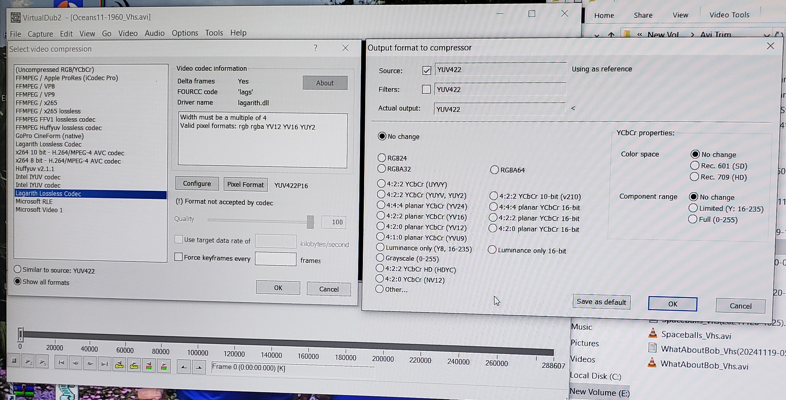

    Buggy means various problems.
    If in the plugins64 folder, you have a Lagarith.vdplugin file, that is the bundled version . The fourcc is "LAGS". The fourcc for the official version is "lags", lower case . You can use mediainfo (view=>text) to show the codec id and fourcc tag. Your AVI file uses "LAGS", so it's using the non official version
    One of the problems in your case is returning RGB in some software , some decoders - this causes potential problems including chroma issues, clipping values . Another is sometimes a framecount discrepancy - the lagarith official version is more consistent. Your video has either 2067 or 2065 frames depending on what decoder is used. Another potential issue is lagarith null frames - only the official decoder supports them. For example, lets say you expand your toolkit, learn some avisynth filters using AVISource , or perhaps import into a NLE - these will have the RGB issue with the non official version. If you're not careful in what you do, there are going to be problems
    Mediainfo reports "LAGS" for both VDub Lagarith versions here. AmarecTV only uses the official version (provided it is installed, of course), and Amarec lagarith captures also display as "LAGS" in MediaInfo.
    You're correct - I mistakenly thought mediainfo could distinguish the fourcc. In the vdub2 compression menu - the fourcc is upper case "LAGS" for vdub lagarith (Lagarith.vdubplugin), and lower case "lags" for official lagarith (lagarith.dll)

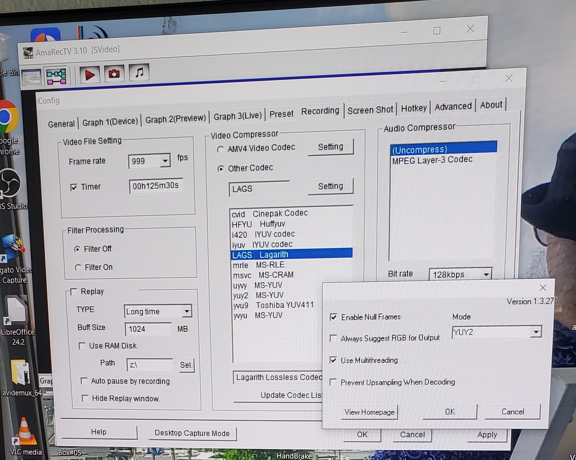

    If AmarecTV uses official version, it's still buggy (perhaps for other reasons) - that's why I suspected it was the non official version , because you can see similar buggy behaviour with the bundled lagarith.
    For that video sample, eg. lagarith decoder using AVISource returns RGB32 and different frame count 2067 with 29.97fps . ffms2 returns YV16 2065 frames and 29.941 fps.
    Just a follow up for this - if you examine with other tools like avinaptic2, the fourcc for official lagarith is
    FourCC                      lags/LAGS
    But the vdub lagarith is
    FourCC                      LAGS/LAGS
    If you look at a hex editor (vdub/vdub2 has one), there is also the difference "lags" vs "LAGS" (You can see it in the first few rows). Perhaps it was some older version of mediainfo that showed the difference, or maybe my memory is bad
    "02FirstNight_NoTbcNoStable_UsbNoSharp_Pana_Vhs.av i" shows up as LAGS/LAGS - which is the non official lagarith version
    Anyways the point I brought it up is the "LAGS" vdub2 bundled version has potential for problems. This has been mentioned in several threads, people have various problems with the bundled version
    And if amarectv is using official lagarith, there are some other issues going on, assuming that sample was stream copied properly

    For your final workflow, if you crop it, you still would need to either resize it to square pixel equivalents; or adjust the SAR. Otherwise the display AR is incorrect - eg. circles become ovals; people look to fat or too thin
    Setting the SAR does not affect any of the actual encoded pixels or values - it just affects how a player adjusts the playback (it's "stretched" or "squished" to the proper AR on playback)

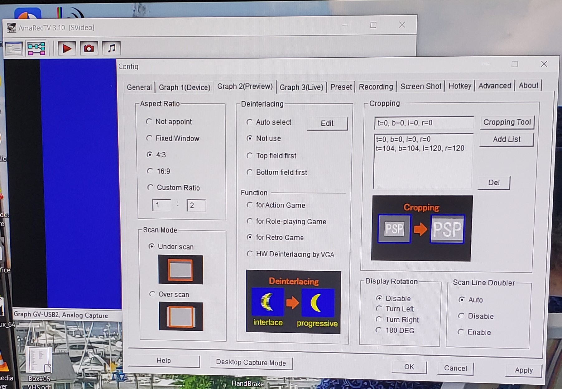

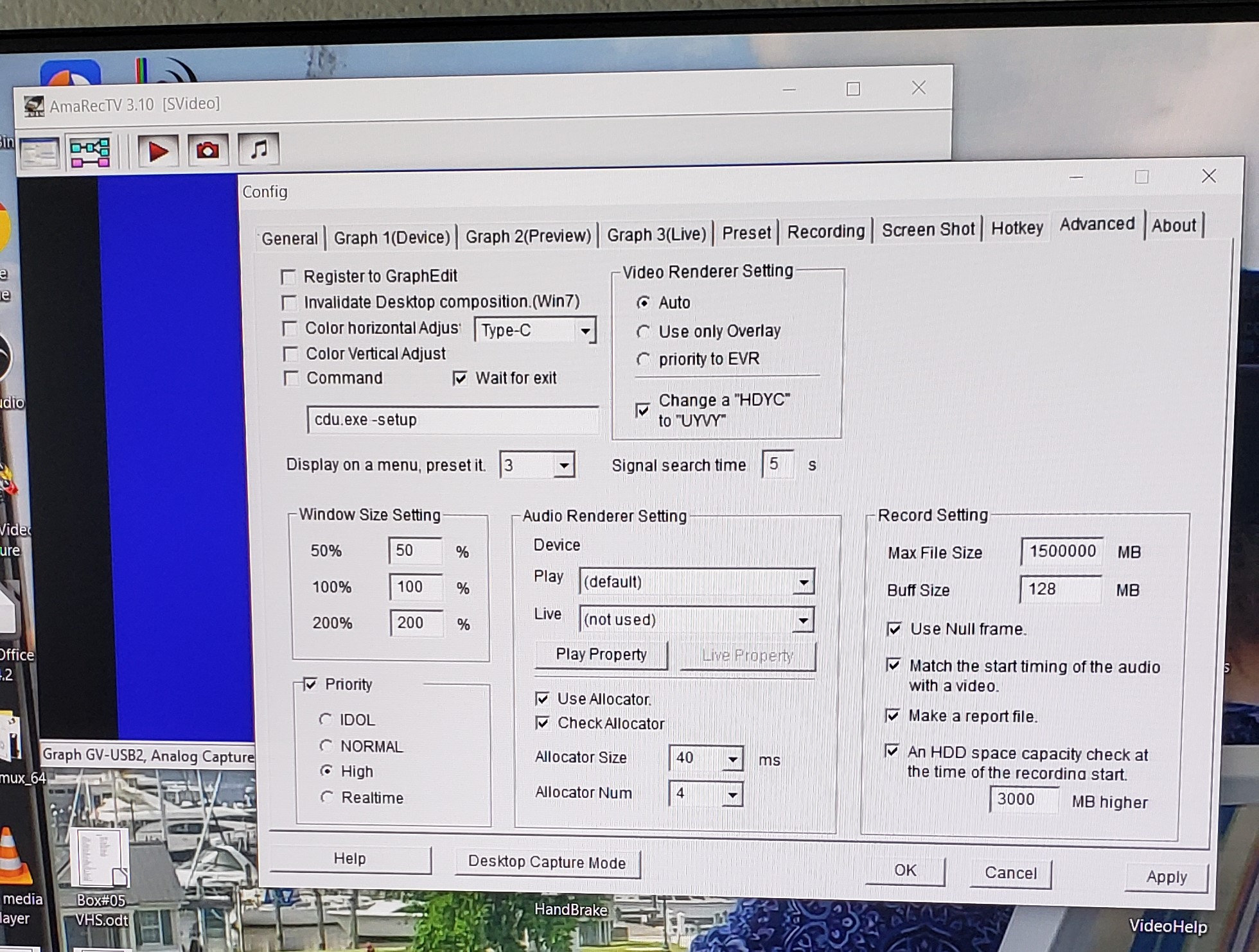

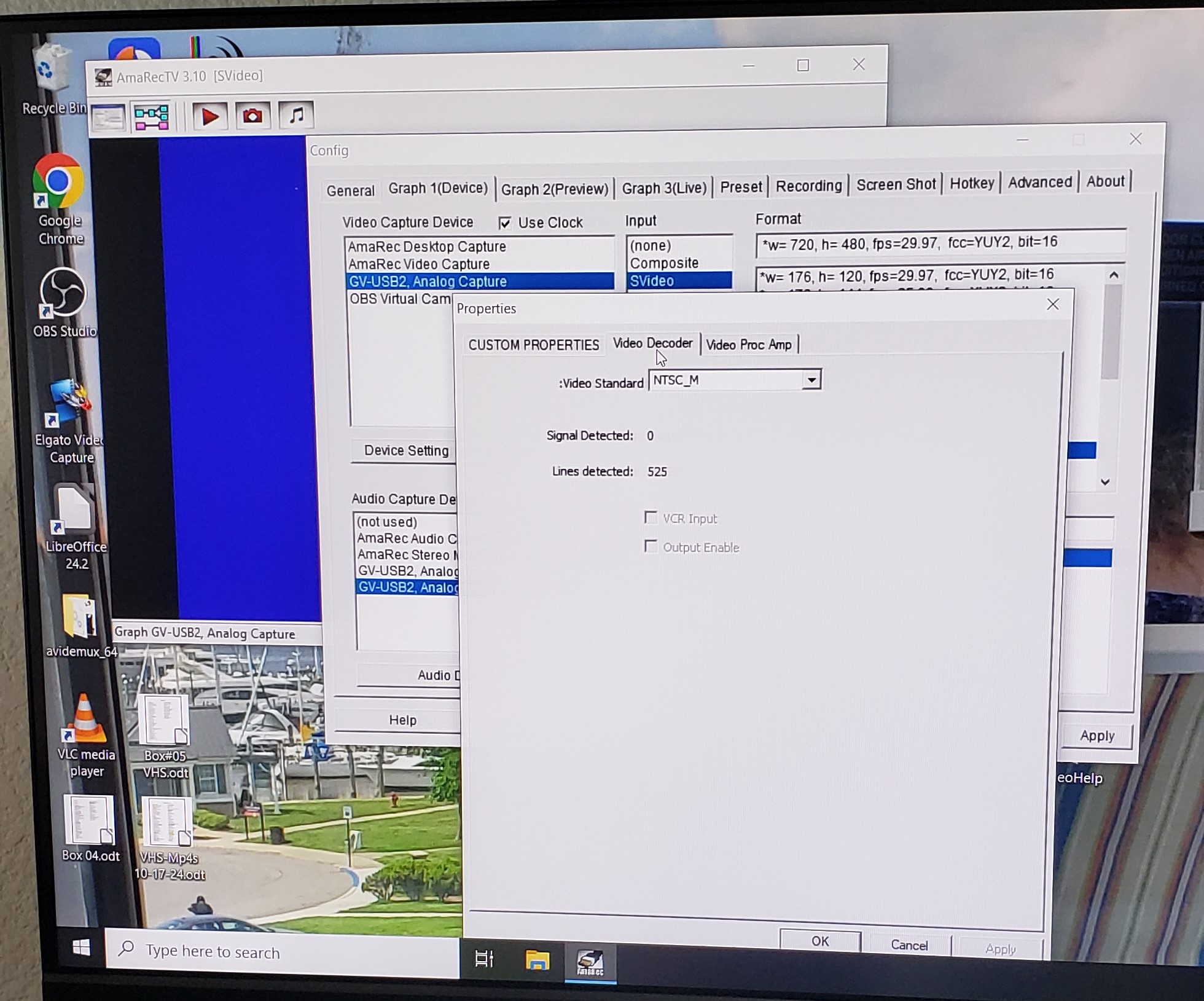

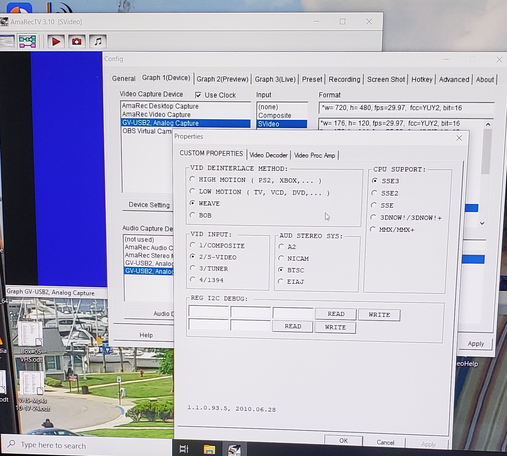

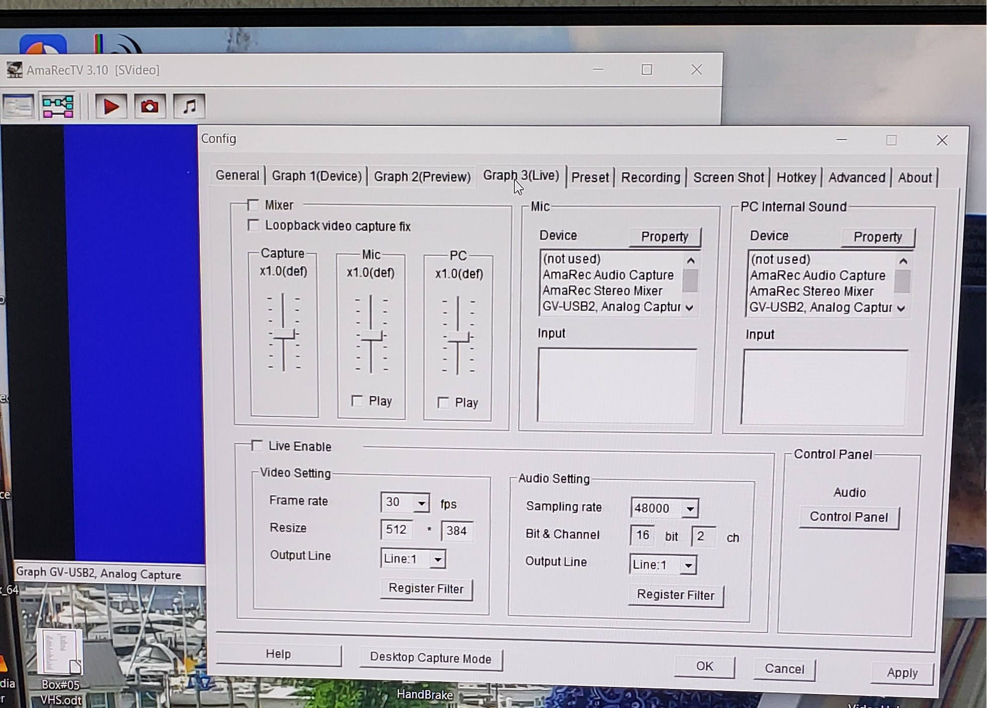

    I must be missing something. The attached are the settings used for the accompanying video files.
    Won't be doing any cropping anytime soon, I will have to put up with the audio noise until I get more tools in my tool kit,

  17. There is a duplicated frame 292-293 in the AVI. That causes 01Oceans11-1960_lagdll_SnipIVTC_Vhs.mp4 to have a duplicate 233-234 post vdub IVTC
    The MP4 is missing the SAR setting, and if it was for a end distribution format, normally you would use 4:2:0
    I don't use AmaRecTv , maybe others can help with those settings

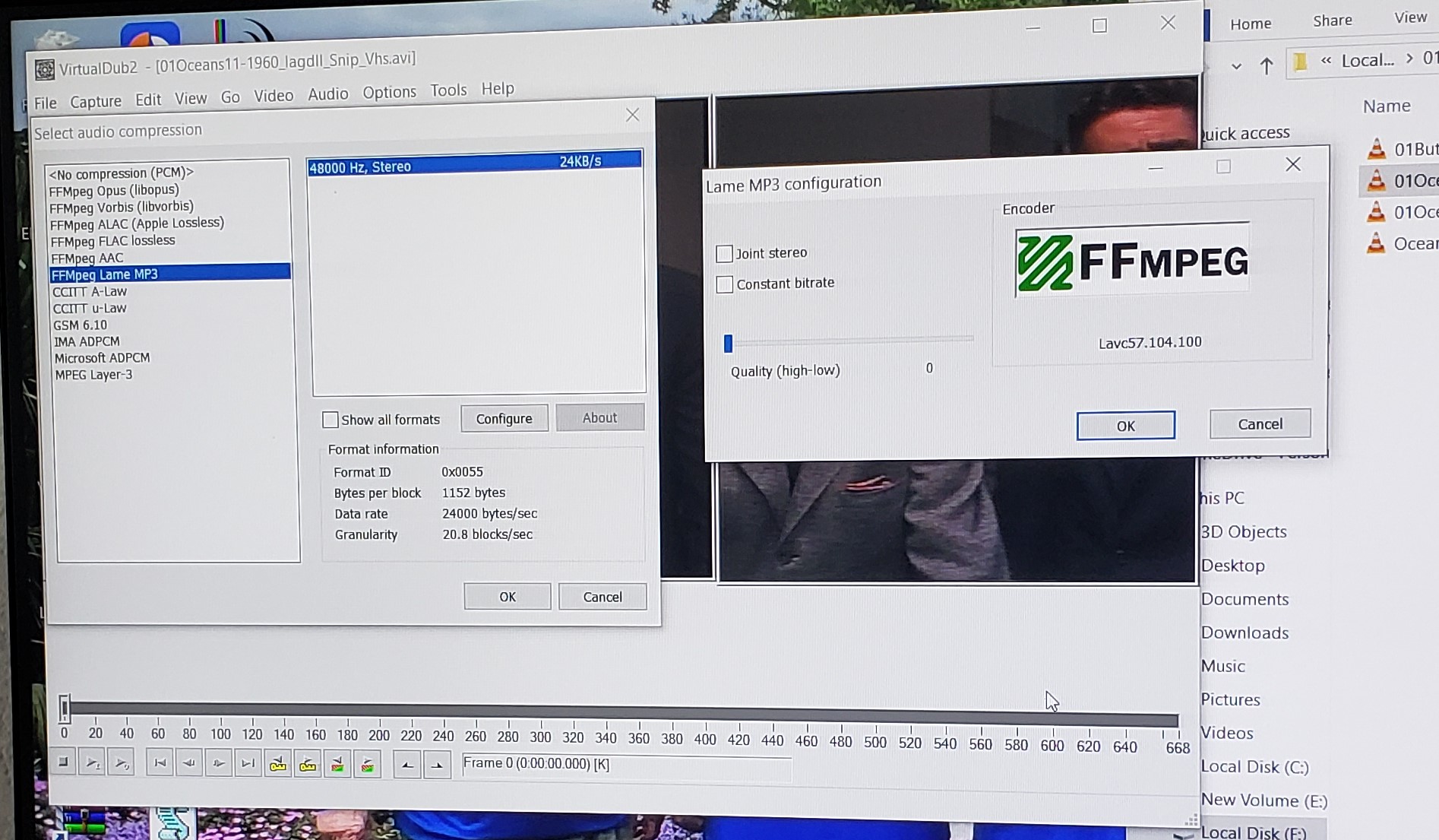

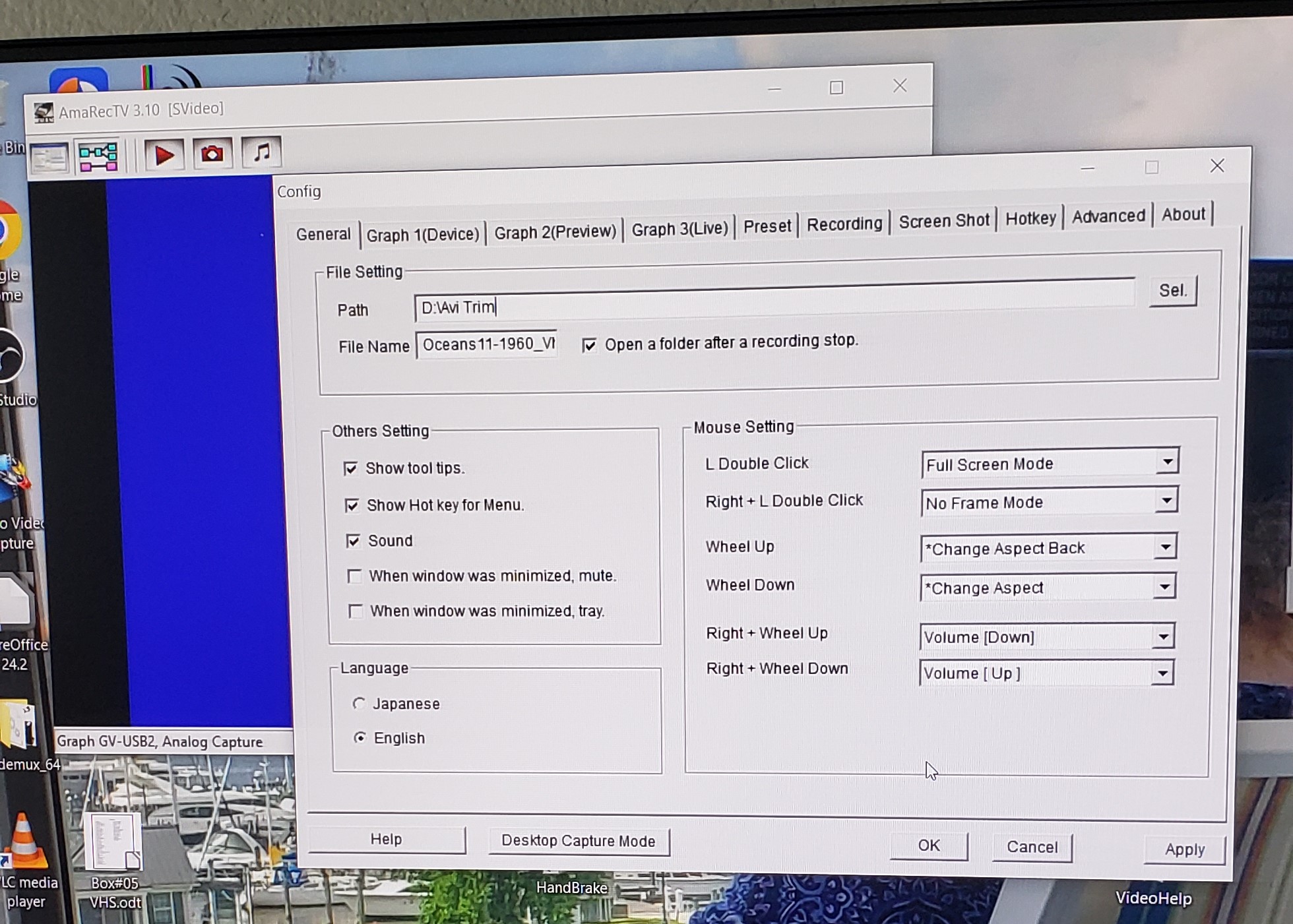

    Re the top two images, if those are your Save As settings for the snip AVI, you should just use Video>Direct Stream Copy. Set up a short range (30sec) with the left and right arrow-buttons on the timeline and then do a "Save Video". You'll then get a exact copy of the original AVI. If I'm reading PDR's post correctly, you should set up the snip start frame to not be over the frames showing the interlacing.
    For the H264 exports, I use AAC as IIRC I read somewhere it is more efficient that MP3 ie better quality for the same bitrate.
    For AmarecTV audio, I use GV-USB2 "Analogue Capture". Not sure why, but it works OK.

    “For the H264 exports, I use AAC as IIRC I read somewhere it is more efficient that MP3 ie better quality for the same bitrate.
    For AmarecTV audio, I use GV-USB2 "Analogue Capture". Not sure why, but it works OK.”

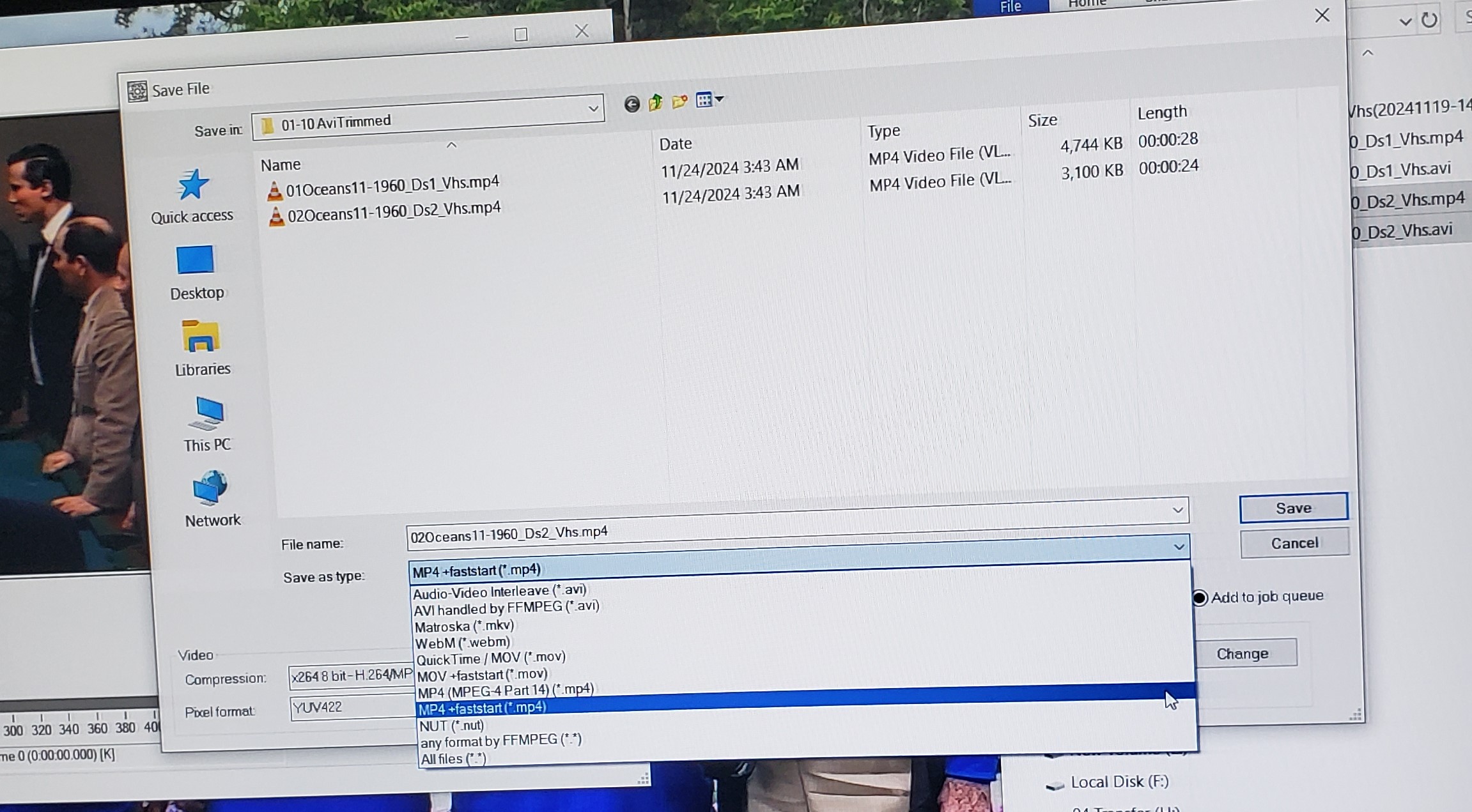

    Thank you for the heads up. Also, how do you “save as” (please see attached)?
    Yes, I use MP4 Fast Start for MP4s.
