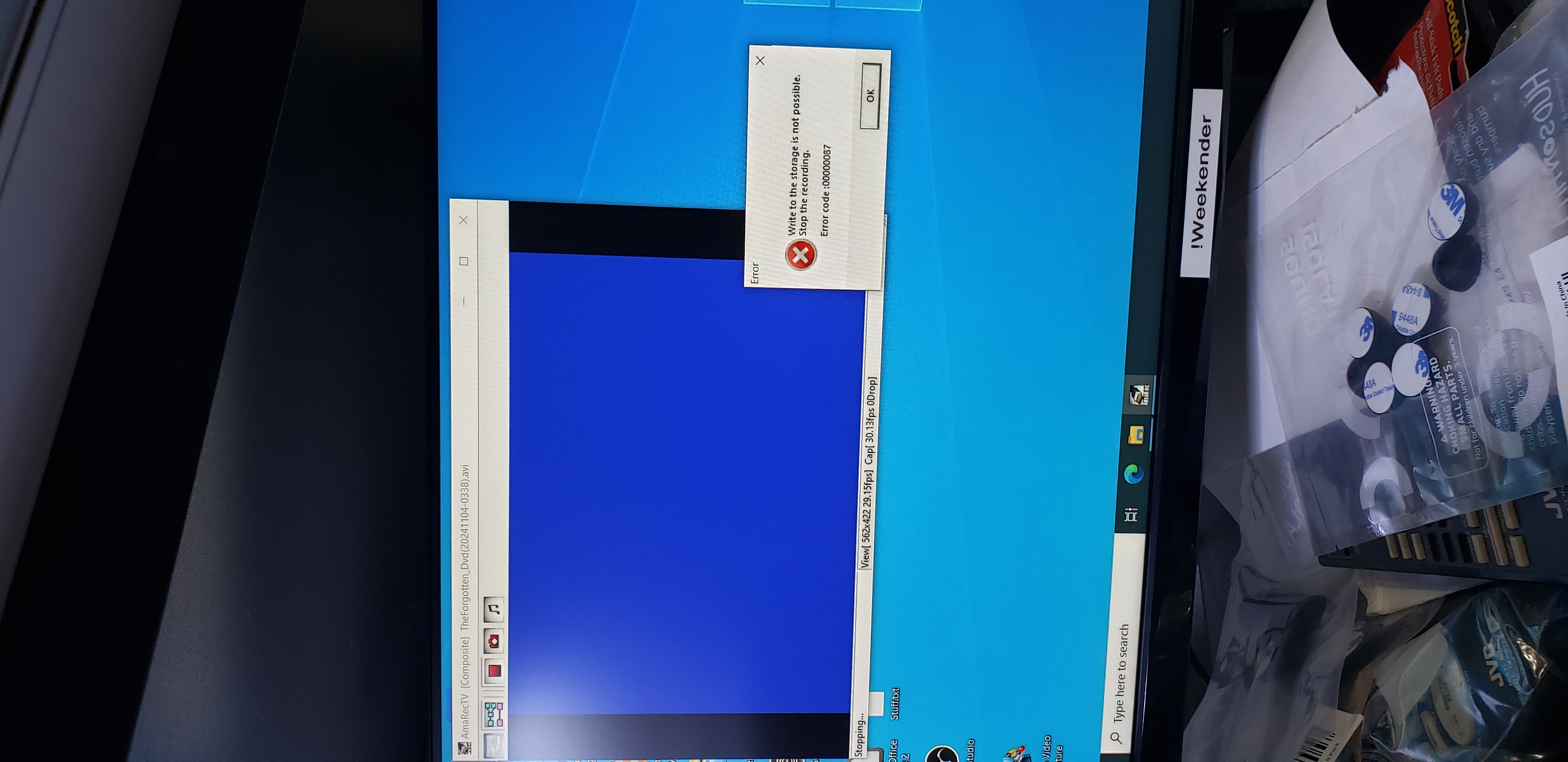

    Of late, when I stop the capture using AmaRecTv3.10, I've been getting this error "Write to storage is not possible. Stop the recording. Error code 00000087". So, latley, I've just been just re-capturing the same file over again with no error the second time. This error only rears it's head on occasion, not every time.

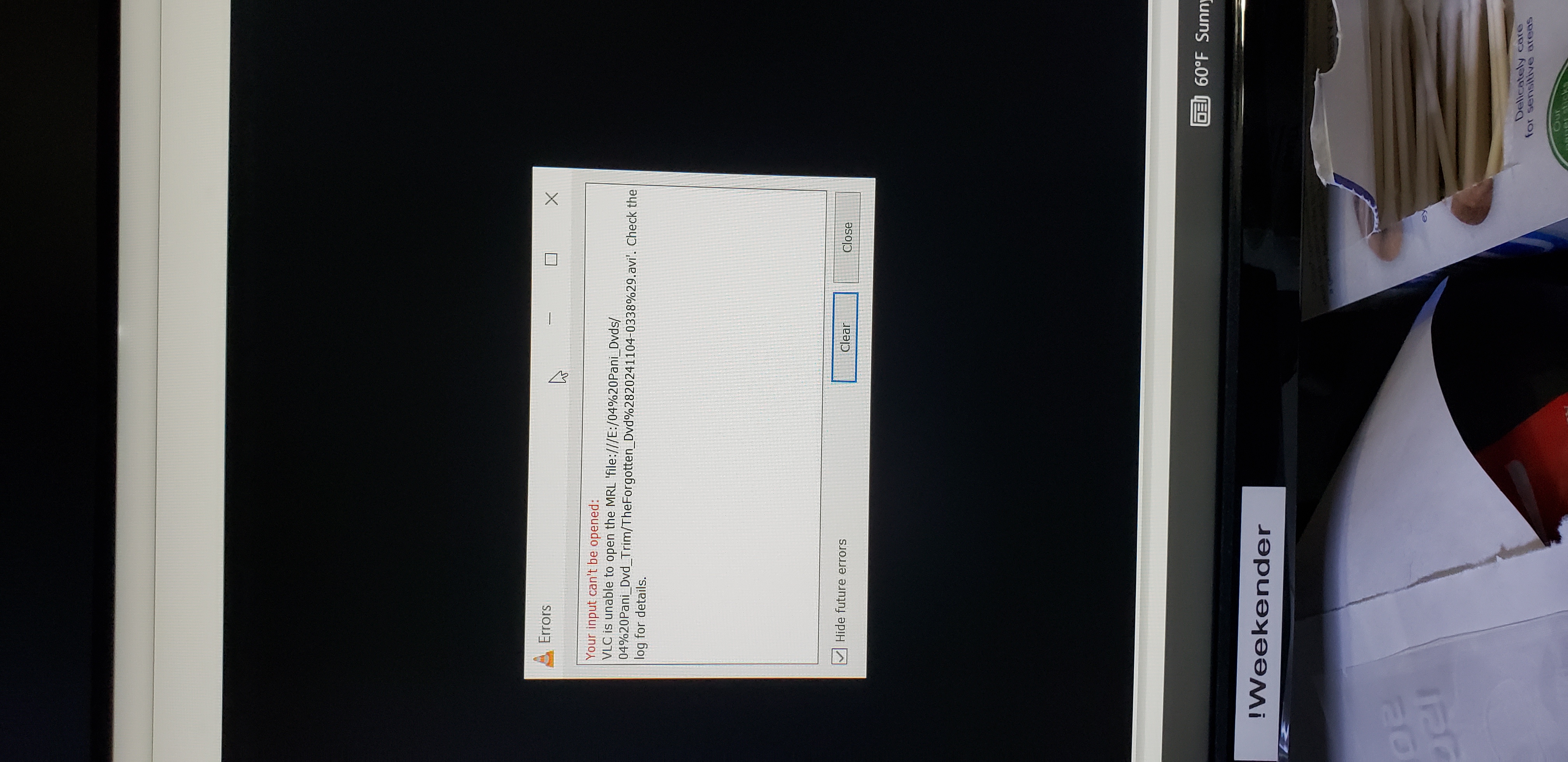

    Then when I try to play the error(ed) file in VLC I get the attached errors.
    Do I need to un-install and re-install the I-Data USB capture card? Regedit?

    The capture was interrrupted so the index within the file was never created - hence the messages in VLC.
    Are you short of disk space? What capture codec are you using?

    I have had this happening occasionally too, that is/was on a Windows 7 system.
    Not sure why/what I was doing exactly at that time.
    You can then try to load the avi into Virtualdub and let it rebuild the index, that worked for me a few times to recover a capture.

    "As the problem always seems to occur when you manually STOP the capture i don't believe it is a problem with the storage itself but something with ending/closing the file where something goes wrong."
    You may have something there. The error does not always happen when I manually stop the the capture, but often enough for me to try and run it down. I'll start letting the AmaRecTv timer run out and see if solves my error 87 nemesis.
    "As i mentioned, it happened on me too occasionally with AmarecTV, and that is on a Windows 7 system.
    But sure not as frequently as you seem to experience."
    Time will tell. Windows 10 has it's challenges as well, when it comes to capturing. You either love it or hate it.
    "Possible AmaRecTv3 behaves better when using another codec?"
    Will see. Lagarith is now my new go to codec.

  26. @ The_Doman...
    I do believe you solved my 00000087 error.
    I do have a habit of stopping the VCR and AmaRecTv when the capture is complete, and before the VCR has had a chance to rewind. Lesson learned, will not do this in the future.
    Thank you, and to all of you who have takin the time to respond,

  28. Member The_Doman's Avatar
    Feb 2004
    Netherlands
    Intresting, but I don't understand exactly how you (possibly) have solved the problem now?
    Starting and stopping captures in between i also do very often, specially when testing/trying out settings or skipping unneeded parts of video.
    Rewinding a tape should logically have nothing to do with it.
    But possible having a stable/unstable image (no signal/end of tape noise etc.) on your capture device can have an effect on how AmarecTV reacts to it?
    Also different capture devices can react different when there is no clear/stable video signal present.
    Here i regularly feed all my video trough a Panasonic DVD recorder (as "surrogate TBC"), so the video signal is always perfectly stable during playback/no signal/tape noise or other disturbances when i use my Dazzle DVC100 with AmarecTV or Virtualdub.
