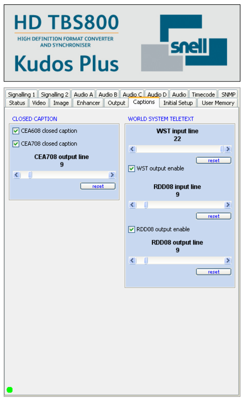

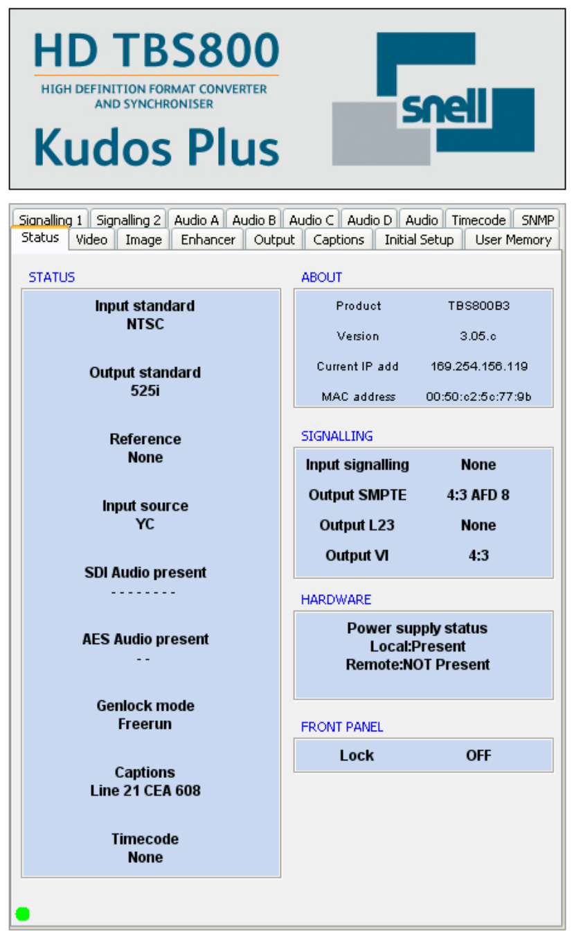

    I'm trying to figure out if caption is carried over to the digital captured files, I use the Snell & Wilcox TBS800 capture device that gives the option to output the caption, however I'm not sure what type of output is mentioned in the manual, Is it SDI or analog output only? So how do I check if the captured file contains digital caption? Do lossless files carry any metadata at all? if so how do I pass that over to encoded files or uploading to a platform like YouTube?
    The TBS800 does detect the caption and display the scan line containing it, If I stop the tape or play across commercials the caption turns into "None", As you can see from the screenshots I enabled all type of captions and teletext but as I said I'm not entirely sure if SDI is considered as an output as mentioned in the manual, I'm attaching a lossless sample captured from a caption section on the tape as well as the user manual here if anyone can interpret it better than me.
Name:	Screenshot 2024-11-04 234403.png

  2. You can see the caption on the top few lines of the .avi. The frame is 486 hight instead of the usual 480 for NTSC.
  3. As pointed by Sharc - captions are located on area normally not active video (such as VBI lines) - to keep such signals your capture size must correspond to not only active video lines but also those normally not used to carry video signal. If you can capture video from line for example 6 and store such samples as video signal then you have RAW coded data lines alternatively your capture device may extract such data from invisible lines and save them as associated with capture data metadata or as separate file.
    Being on your side (seem you are seriously dedicated to capture) and if you have space then i would search for TEKTRONIX VM700 - this is state of the art video signal analyzer so you can not only monitor your setup but also perform real video measurements (and quickly address your questions).
    This is probably overkill but still something you may consider seriously - i worked a lot with VM700 and from my perspective this machine cover all you need and much more on regular SD signal. Nowadays it is not so expensive as i see on ebay.
    That's not what I'm asking, My question was, does the caption data get transferred from the analog scan lines to digital metadata like the ones in Blu-ray or mkv files?
  5. Originally Posted by dellsam34 View Post
    Then answer is no - your SDI can pass VBI from input to output - in some cases you can select line where such data are reinserted - to capture those data you need capture VBI lines and later use tool that can extract data from signal and offer it as for example txt file.
    Probably ffmpeg offer such parser for close captions also there is dedicated group of utilities https://github.com/zapping-vbi/zvbi
  6. Capturing Memories dellsam34's Avatar
    Jan 2016
    Oh okay, So the TBS800 does not have the capability to extract and embed the data into the file's header, This means that it can only create caption or teletext lines from SDI into analog out with special caption or teletext consoles like this one, Although in that video he is using the analog input/output version, not the digital input/analog output version.
    But the question still remains, what if the TBS800 is indeed outputting caption and teletext data over SDI and the ingest software is ignoring it, What if there is a software out there like some pro NLE that can detect that data in the SDI stream, I know for a fact that SDI is not just video and audio, it include other data like timecode, signaling, HDCP ... etc. so caption and teletext and other proprietary messages and barcodes should be part of that data.
  7. Originally Posted by dellsam34 View Post
    This is how i understand provided by you manual for TBS800 - there is no detailed description there except rather brief information.
    This is also inline with SDI functionality - just digital video interface.
    Normally such data are located in area not used to transport video so obviously device with SDI input need to have some form of data extractor - if your capture device is able to capture not only active video lines but also those VBI's then extraction should be not difficult - they will be accessible as RAW video and can be sliced and extracted.
