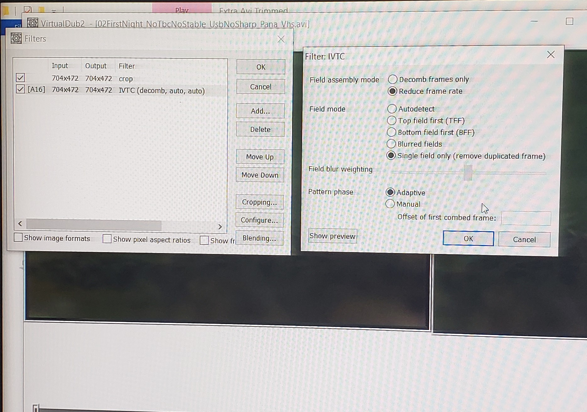

  24. For vdub's IVTC - don't use field mode: "single field only"; use "autodetect"

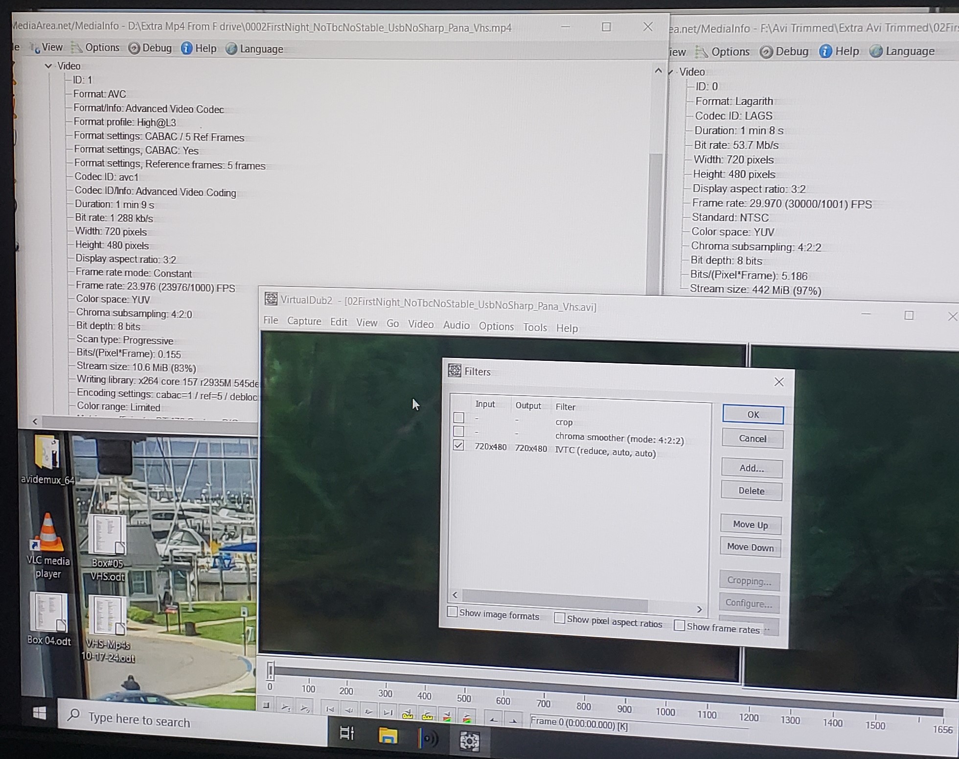

  25. @poisondeathray...
    As requested

  30. Much better and about what you expect post IVTC for that capture
    There is an orphaned field in the source at a scene change around 12 sec (field 731 in the source), causing vdub's IVTC to place a combed frame . Unclear if that dropped field was in the source (eg. could have been from post telecine edit), or a capture issue, because it's right at the scene change
    Other housekeeping issue is to set the AR in the encode, instead of "square pixels" . The other option is to resize to a square pixel format
    The capture uses lagarith, but I think the bundled one with vdub2. The bundled one is a bit buggy and returns RGB in some programs, including vdub2 itself when using the AVI driver (if you have lagarith installed). If you open the AVI directly, video => decode format it shows RGB32 (at least for me) ; or video => filters => enable checkbox on the left hand bottom "show image formats" , then add a "null transform" filter, it also shows RGB32. If you use the caching input driver, or ffmpeg input driver, it should return 422. If you use AVISource in avisynth , it also returns RGB32. There have been other issues with the bundled implementation. I would stick with official lagarith if using lagarith, or use something else like huffyuv or ut video
