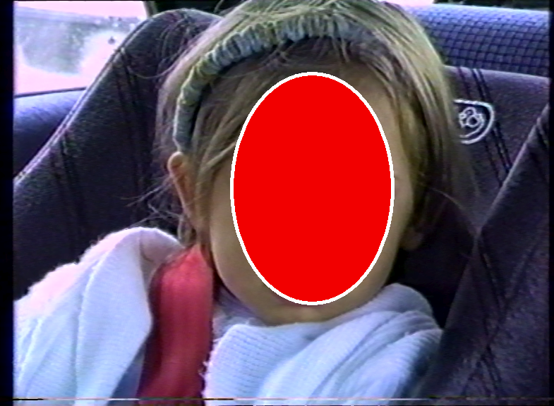

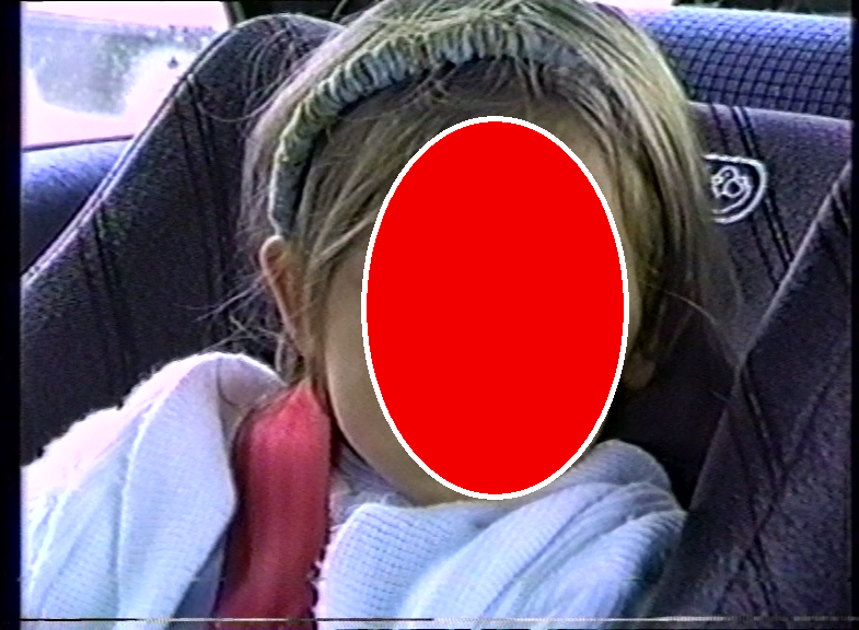

    After playing a few tapes I noticed what you can see in the screenshots below. Why is the image from JVC J672 (composite output) so good compared to Philips VR1100 (JVC S7600)?
    J672 in Edit mode, S7600 (svideo) does not have such a setting, so I can only turn off 3DNR.
    (B.E.S.T turned on on both machines)
    https://imgsli.com/MzA3NzAy

  26. Video Restorer lordsmurf's Avatar
    Originally Posted by rgr View Post
    I've copied a couple of tapes with TBC and in the vast majority of cases it causes the image to shake
    You VCR is probably bad. Not the model, not the brand ... your exact VCR.
    [I]After playing a few tapes I noticed what you can see in the screenshots below. Why is the image from JVC J672 (composite output) so good compared to Philips VR1100 (JVC S7600)?
    That J672 image is not good. It has really aggressive false (over)sharpening. Look at the hard black line on the left side (from our perspective) of the child seat. The world doesn't have black crayon outlines on everything. If you want to sharpen, do it better in Avisynth from the original unmolested video.
