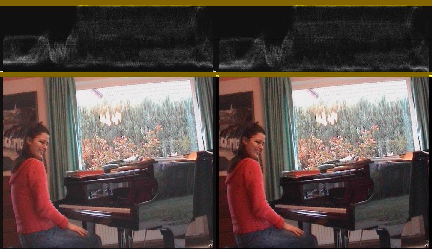

    @Bermuda1, off the records: The darks are elevated (left). I would reduce them by about 16 notches (right). The black piano should be close to Y=16, means just above the lower brown bar in the waveform monitor. You can do it in post processing.
    [Attachment 82498 - Click to enlarge]
    Re. waveform monitor see jagabo's tutorial here:
    https://forum.videohelp.com/threads/340804-colorspace-conversation-elaboration#post2121568
    In case you are using the histogram for proc amp or level adjustments don't be fooled by the black side (or top/bottom) bars of the capture. Crop them off for the histogram.
