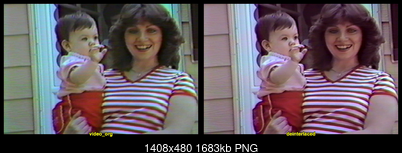

    Here a comparison between your script and the same where QTGMC is used in lossless mode (the original frame is untouched), in order to apply MCDegrainSharp() on a progressive vdeo, as it should be; at the end the video is interlaced back so it will be as you like. See how more details are preserved: https://imgsli.com/MTUzMDYw
    Here the script, small (but decisive) modification to yours:

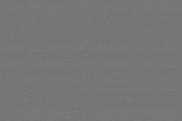

    frame 196 - frame 197 (different):
    [Attachment 69088 - Click to enlarge]
    frame 197 - frame 198 (identical, just a little noise difference):
    [Attachment 69089 - Click to enlarge]

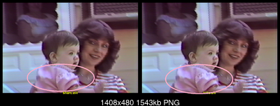

    Well well, just take another frame, e.g. #375 and compare the wood panel structure above the boy's head and the boy's sleeve....
    Also, take into account that QTGMC applies some extra sharpening of its own. Both methods have their pros and cons.
Name:	Screenshot 2023-02-06 093310.png

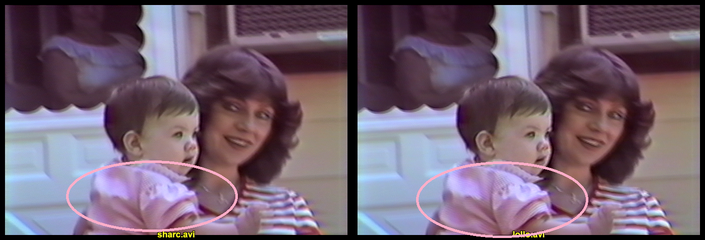

    Well well, just take another frame ...
    Done. Even in that particolar frame I see less artifacts (and no more details) for QTGMC lossless approach (the wood and the right sleeve of the baby): https://imgsli.com/MTUzMTM1
    For all the rest of the frames there is no match.

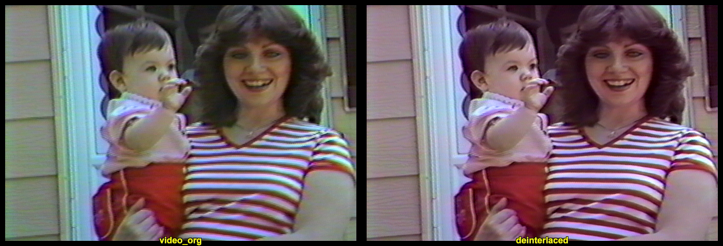

    Not in lossless mode in the primary frame that you keep after processing. Do this experiment on your own:
    video_org=AviSource("<finename>.avi")
    deinterlaced=video_org.AssumeTFF().QTGMC(lossless=1)
    interlaced=deinterlaced.AssumeTFF().SeparateFields().SelectEvery(4,0,3).Weave()
    ### check difference between original video and original video after QTGMC_lossless and re-interlacing ###
    difference_video_org_interlaced=Subtract(video_org, interlaced).Levels(65, 1, 255-64, 0, 255, coring=false)
    stackhorizontal(\
    subtitle(video_org,"video_org",size=20,align=2),\
    subtitle(interlaced,"interlaced",size=20,align=2),\
    subtitle(difference_video_org_interlaced,"difference",size=20,align=2)\
    ### check difference between original video separated fields and original video after QTGMC_lossless and re-interlacing separated fields ###
    #video_org_sep_tff=video_org.AssumeTFF().separateFields()
    #interlaced_sep_tff=interlaced.AssumeTFF().separateFields()
    	# equivalent to
    	#deinterlaced_sep_sel403_tff=deinterlaced.AssumeTFF().SeparateFields().SelectEvery(4,0,3)
    #difference_video_org_sep_tff_interlaced_sep_tff=Subtract(video_org_sep_tff, interlaced_sep_tff).Levels(65, 1, 255-64, 0, 255, coring=false)
    #stackhorizontal(\
    #subtitle(video_org_sep_tff,"video_org_sep_tff",size=20,align=2),\
    #subtitle(interlaced_sep_tff,"interlaced_sep_tff",size=20,align=2),\
    #subtitle(difference_video_org_sep_tff_interlaced_sep_tff,"difference",size=20,align=2)\

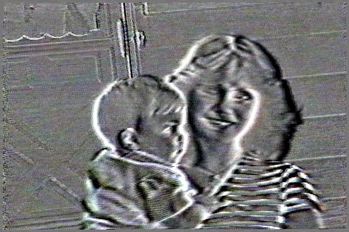

    Stairstepping diagonals? Do you watch the interlaced frames on a progressive monitor and complain about the combing?
    [Attachment 69104 - Click to enlarge]
    unless you remove the whole field, all of the interpolation deinterlacers (like yadif2 for example) tend to leave jagged lines

  21. Captures & Restoration lollo's Avatar
    Jul 2018
    Italy
    Not really, a simple not optimized QTGMC() is not too bad (for the vertical white lines fine tuning is needed)
    deinterlaced=video_org_st_sl.QTGMC().addborders(10,10,10,10)
    stackhorizontal(\
    subtitle(video_org.SelectEvery(1,0,0).addborders(10,10,10,10),"video_org",size=20,align=2),\
    subtitle(deinterlaced,"deinterlaced",size=20,align=2)\
