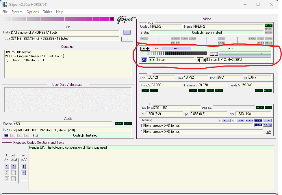

    Info about GOP Structure in GSpot (for mpeg2 only, like .mpg or .vob)
    See "Structure" in https://en.wikipedia.org/wiki/Group_of_pictures
    g corresponds to N.

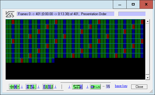

  18. Yes, the N=12 to the right of |I| <--> |I| is the GOP length. If you press the VGS button to the left of the circled area you will get a dialog where you can see the frame types and other information:
    [Attachment 82415 - Click to enlarge]
    Red blocs are I frames, green blocks are B frames, blue blocks are P frames.
