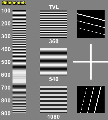

    The purpose is to not degrade the full progressive frames. When you deinterlace a progressive content frame, you essentially reduce the resolution in half.
    In theory, it would be
    -vf fieldmatch=combmatch=full,bwdif=deint=interlaced
    https://ffmpeg.org/ffmpeg-filters.html#fieldmatch
    This should field match 25p sections , returning the full quality 25p frames, and for sections that are interlaced, they will be flagged, and bwdif will deinterlace only those flagged sections only as to not degrade the progressive sections
    Sometimes you have to adjust thresholds and settings, and preview, readjust. For example , it might miss a small interlaced overlay. Or it might be too aggressive and degrade a progressive section
    It's less ideal with ffmpeg. It's easier to do with avisynth/avspmod or vapoursynth/vsedit, where you can preview more easily and adjust for proper settings. Yes you can use ffplay or mpv to preview ffmpeg pipe, but it's not as easy, scrubbing is less straight forward, more difficult to make adjustments and get feedback
    Also, for those interlaced content parts, and you go to 25p, you discard half the information in those parts (single rate deinterlace) . Interlaced content would be properly displayed at 50p, because 50 moments in time /sec are represented by interlaced content
    EDIT: the default mode in ffmpeg for bwdif is send_field, but for yadif is send_frame. So set bwdif to mode=0 for 25p
    -vf fieldmatch=combmatch=full,bwdif=mode=0:deint=interlaced

    Yes - the way "deinterlacer" is being used in this context - is interpolation of missing scan lines using some algorithm.
    A deinterlacer applied to progressive content basically throws away 1 of the fields of the pair, and tries to reconstruct the missing field . Essentially you're cutting the spatial resolution in half . For interlaced content , you start with missing fields in the first place, so applying a "deinterlacer" is no problem for interlaced content. For progressive content, deinterlacing degrades the image. The higher the quality the starting content, the more visible the degredation. Also the finer the lines, certain patterns and angles (straight lines), the more deinterlacing artifacts (jaggy lines, aliasing) are produced by typical algorithms (you discarded 1/2 the information, something has to give).
    In this case that's "wasted work". I already know the source is progressive. Take the odd lines from one field, the even ones from the second, interleave them and that's it, that is the full resolution frame. There's no need to analyse the picture at all, since the pattern is exactly known beforehand.
    Sure, if you have 100% progressive content, then you didn't need to start the thread. Do nothing. You're done.
    But it can be field shifted (misaligned fields), they can be broadcast like that too. If you just do what you said, it would look combed. You have to re-align, that's part of what field matching can do
    Also, the analysis is to see which parts have interlaced content, which is why I presume you started this thread. So progressive parts are weaved, interlaced parts are filtered with bwdif (or whatever)
    The sources clearly have both progressive and true interlaced parts within them. Viewing unfiltered, this is visible as combing in some parts, but not others. Sort of like watching a movie where the movie itself is progressive (BR or DVD rips for all I know), but some stuff in commercial breaks is not, and sometimes - subtitles are interlaced and present as combed.
    ^ so you don't have 100% progressive content, and/or it could be field shifted in some parts
    Ideally, progressive content gets weaved with aligned fields (you're calling it "interleaved"), interlaced content gets deinterlaced double rate, so that becomes VFR. Everything plays how it was intended. If you watch a UK drama, it gets displayed at 25p, but the commercial of football (soccer) match gets double rate deinterlaced to 50p by your TV. Motion is smooth for that commercial.
    I'm looking for something that would restore the full progressive frames from the telecined parts - something that would do it quickly.
    Like I said, just bwdif alone DOES do a good job basically performing just "ivtc", but it is PAINFULLY slow.
    There are many that would say you are butchering the progressive parts with bwdif... just saying. Maybe you don't care or don't notice the problems. It does partially depend on what you started with, and the type and quality of content.

    Here is an exerpt from a test chart, it's an APNG, it should animate in most browsers
    The full vertical resolution is recovered by field matching, while it's about half for bwdif and yadif. Yadif you could argue is slightly less. Both deinterlacers worsen the diagonals and cause ringing/edge enhancement on the plus pattern (bwdif worse for the edge enhancement)
    fieldmatch PSNR 98.965271 dB
    bwdif PSNR 28.689996 dB
    yadif PSNR 28.157285 dB
    Weaving 2 fields that belong to the same frame, forms the full quality progressive frame - is essentially field matching (the searching for , and combining of matching fields of the same frame if they are misaligned).
    BUT deinterlacing such as bwdif, yadif - NEVER weaves 2 fields belonging to the same frame cleanly in motion. The defining characteristic for all "deinterlacers" (the way they are defined here and many video forums) is that they use some algorithm to interpolate the missing field (that is dropped for progressive content). Some look to adjacent fields farther than 1 away to fill in the information (temporal). Field matching is not deinterlacing (the way "deinterlacing" is defined here)- field matching recovers basically all (~99%) the actual resolution because both original fields are matched, but deinterlacing never does . Deinterlacing is generally closer to ~50%
    Yadif and bwdif have a check for spatial, and temporal (motion). If you have no motion, ie. repeated frames, a static image - bwdif actually does well, it weaves the fields as you should. The "W" in BW is weave. It stands for "Bob Weave". That's what a proper motion adpative deinterlacer is supposed to do, one of the selling points of "interlace" in the first place: Full progressive resolution when there is no motion. The amount or magnitude of motion and spatial differences triggers more areas to be deinterlaced, thus more artifacts appear in scenes that have higher motion, compared to lower motion. It's true that the interpolation used by yadif and bwdif are smarter than just discarding a field but it's still worse than field matching in the context of progressive content.
    But as mentioned earlier, whether or you can "see" the difference depends on your eyes and the type of content. When you deinterlace progressive content - lower frequencies , coarse details are less adversely affected than higher frequency , finer details. The higher the quality, the finer the details of the source (higher effective resolution) the more likely you 'll see the problems when deinterlacing progressive content. On the test chart exerpt, if you look at the lines <500 , they are barely affected, just some aliasing and along diagonals. Many "HD" sources are low quality, soft to begin with and do not have remotely close to 1080 actual effective resolution. They might be closer to 600 or 700 lines to begin with. For those, you might not notice as much degredation. Also content differences - lines, angles, diagonals, like fences , buildings will will generate aliased flickering deinterlacing artifacts in motion. ie. Motion artifacts, buzzing lines. Test charts usually have high contrast edges, but the source content might be more organic and hide the deinterlacing artifacts. Certain angles might be handled better or worse with certain algorithms. Many threads posted on this forum deal with handling the artifacts created from deinterlacing progressive content.
