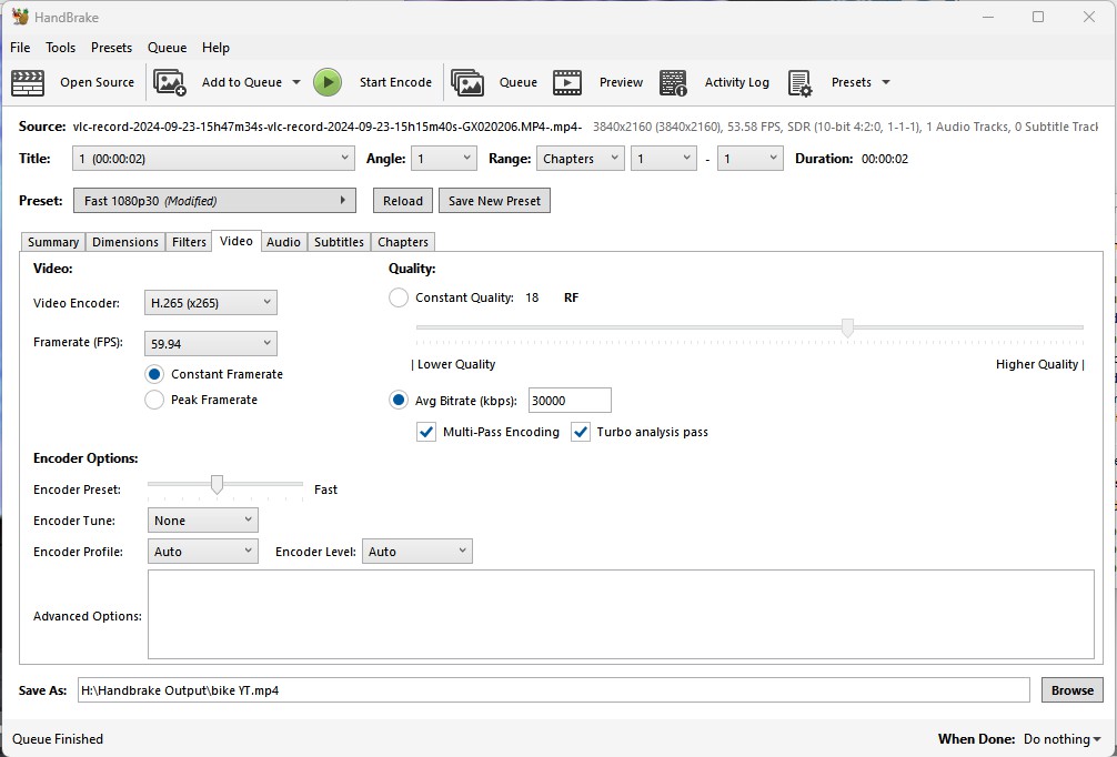

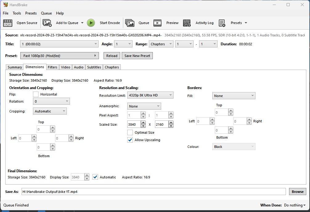

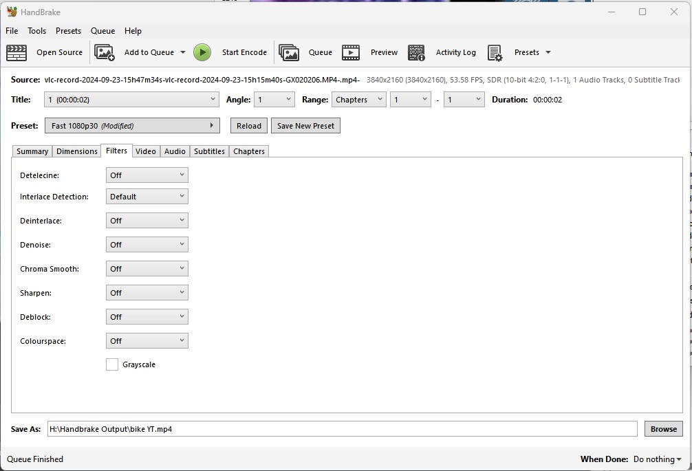

    @twinax, if you can't get AVIDemux to work, you can recode it with Handbrake. It's quite straightforward for this.
    For your video for YT, set it up like this:
    Setup:
    [Attachment 82467 - Click to enlarge]
    Dimensions tab
    [Attachment 82463 - Click to enlarge]
    Filters tab
    [Attachment 82464 - Click to enlarge]
    Video tab
    [Attachment 82465 - Click to enlarge]
    Note: I have chosen 30,000kbps as a reasonable bitrate for YT. If you're not happy with the YT quality, you can increase it. The video you posted for us has a BR of 108,000 but IMO that doesn't need to be that high for YT. Do some experimenting to find a good compromise between quality and upload time.

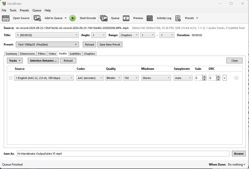

    Audio tab
    [Attachment 82466 - Click to enlarge]
