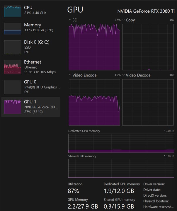

  1. Hi folks, need your help please.
    • I set Handbrake to NVEnc 264 + Very Fast 480p to encode a 4Gb mp4 file.
    • Windows 11 is set for Handbrake to use NVidia GPU.
    • CPU is cooled with 360mm Arctic Liquid Freezer.
    • Task Manager shows that the GPU, not CPU, is working to encode the video (see pic).
    But the CPU is still burning away at 90 Celsius and running at 81% utilization.
    Am I missing any settings? How can I cool down my CPU further? Thanks!
    [Attachment 79537 - Click to enlarge]

    I just did a quick test: NVec H264 to 576p very fast, my 3060ti was on 100% and my i7 was on ~40%.
    Your CPU load does seem high for an NVec encode, but the temp is the worry. Does it get that high normally?
    I'd be checking the cooler app to see the liquid temp is going up as well. If it's not, the cooler might be defective.

  5. Thanks for the replies! Liquid cooling works well.
    I wonder though why my CPU load is 80%. Read elsewhere that some of the encoding work (eg audio, demux) is still done by the CPU even though it is on NVEnc.
    Unfortunately my Win11 doesn't show "Processor performance boost mode". Odd. (Tried to change my RegEdit to try make it appear, but it didn't work.)
    I need to keep my Turbo Boost as I need the CPU to upsample music files, which requires heavy duty computing.
    On a separate note, I changed the Handbrake setting to NVEnc 265 (instead of 264). CPU temperature cooled a bit to 70+C ... still sort of high, but better than when I set it to NVEnc 264.
    As a bonus, the file size with 265 is also about 10% smaller

  7. The problem is the GPU encoding is so fast that the CPU is working hard to keep up with the other processing (video decoding, filtering, audio decoding, audio encoding). I don't know if Handbrake has an option to use GPU decoding. Or if your source is suitable for GPU decoding.

  9. There could be other reasons, why your CPU is at a high usage.
    Handbrake will use by default the decomb filter to check, if your video is interlaced or has artefacts.
    Many of the handbrake video filters are used by cpu only. This could be the reason for the high CPU usage.
