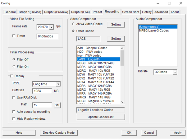

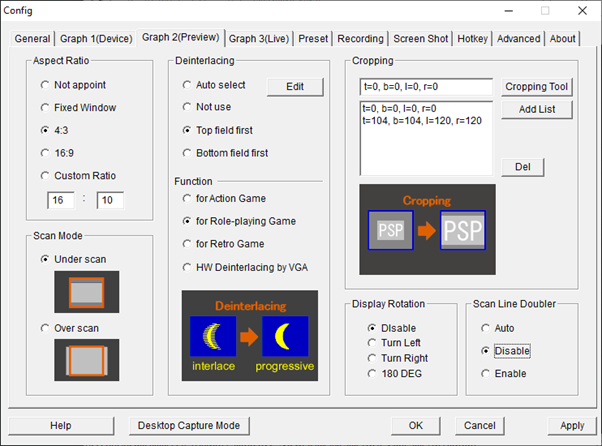

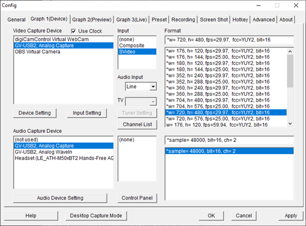

    I was hoping someone could let me know if this workflow is good for capturing VHS via Amarec in great quality. Like many others I've had issues with Vdub, specifically audio sync, which makes it a no-go.
    My hardware setup is: Panasonic NV-SVB10 -> S-Video -> GV-USB2 -> Windows 10 PC -> Amarec
    These are my Amarec settings:
    [Attachment 82347 - Click to enlarge]
    [Attachment 82348 - Click to enlarge]
    [Attachment 82349 - Click to enlarge]

    - Amarec shows deinterlacing is TFF there, not off.
    - In VLC, use Yadif 2x as the mode.

    The "Deinterlacing" setting in Graph2 (Preview) tab are only for AmarecTV display windows, and has no effect on capture.
    Set "Frame rate" in "Recording" tab to 999, to force the frame rate of the capture card rather than defining it in software.
    Enable "Make a report file" in the "Advanced" tab, to keep trace of inserted and dropped frames at software level.
    Your setings are OK, many others (including myself) use HuffYUV rather than Lagarith, but that's fine.

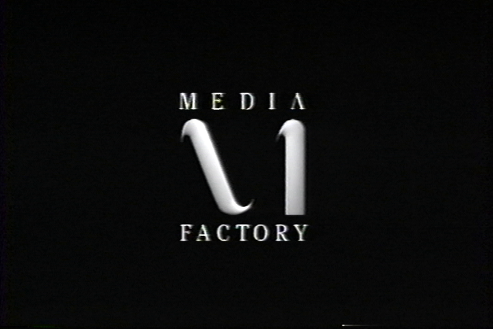

    I just had a look at your video double-rate deinterlaced and it's not interlaced, it's Progressive Segmented Frame. Every second frame (was a field) is basically the same as the last, so you have pairs of frames. So you should not use QTGMC on it (at least, the clip you gave us in the first post.
    To "fix" that, just do a AVISynth/TFM() on it.
    So, in your script, replace QTGMC with:
    TFM()
    TemporalDegrain2(degrainTR=3) #change the "3" to lower the noise reduction; BTW this hash symbol signifies non-executable notes in a script.
    I know nothing about LSFMod so somebody will hopefully chime in on that.
    You may need extra DLLs for those; AVISynth will spit a warning at you if needed.

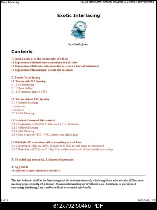

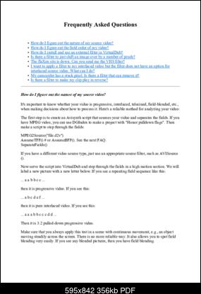

    First of all you have to understand the nature of your video, some very basic stuff here:
    more complicated here:
Name:	Exotic Interlacing(English).pdf
    search the forum for other examples

    To summarise the AVI clip in post #1:
    -It's 29.97 Progressive (or Progressive Segmented Frame) and it doesn't need anything done to it, deinterlacing-wise, certainly not QTGMC. I've seen TFM being suggested for PSF but it doesn't make any difference to this video.
    -It benefits from Temporaldegrain2(degrain=2); note the denoising of the green shading towards the end.
    -I can't see any edging benefit with LSFMod.
    So my script would be:
