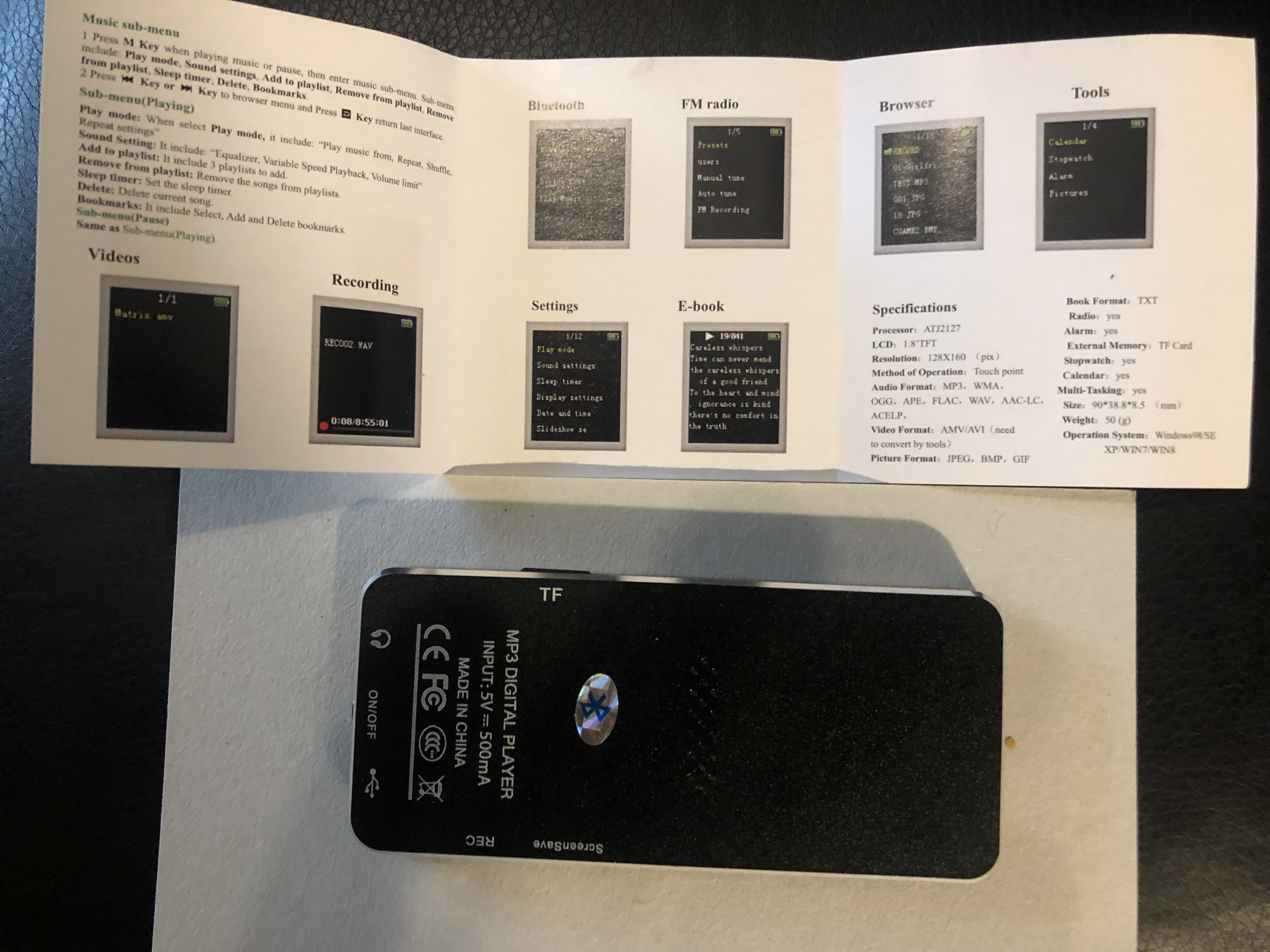

    I attach photos of the front and back of the Player and of it's very brief user manual. I don't think there's much here that's helpful, but I include them as I have been asked for them
    Bill

  16. @ BillS719,
    This one I used different ffmpeg code & different codec.
    I don't know what is going on with the pictures you posted.
    The are correct in the post but when clicked to enlarge they are upside down.
    Makes reading them a bit difficult.
