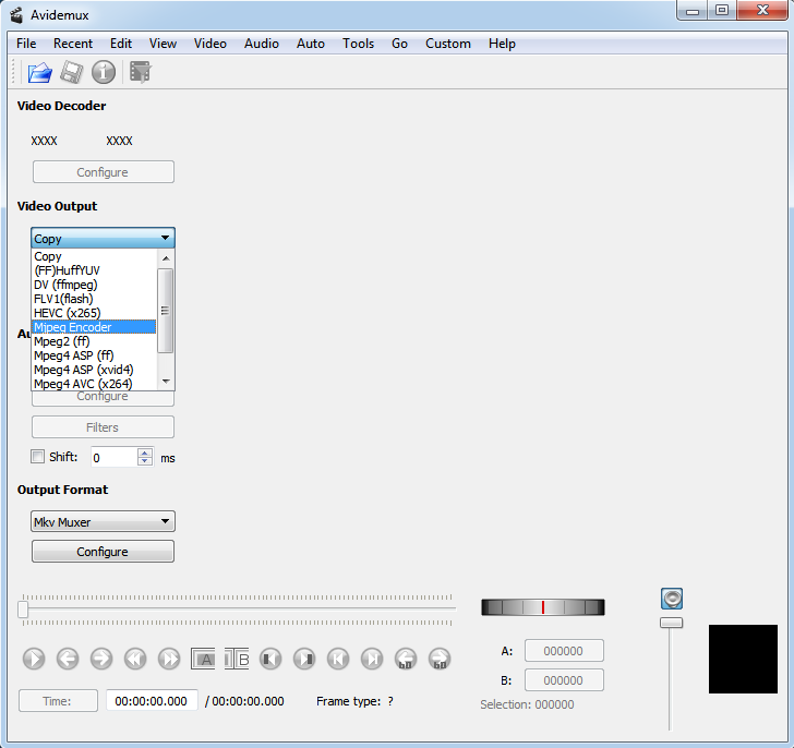

    I downloaded avidemux but also don't see any option for mjpeg video.
    It's on the Video Output pulldown:
    [Attachment 51208 - Click to enlarge]

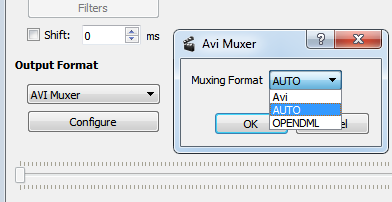

  15. Go to the Avi Muxer's configuration dialog. Try both AVI and OPENDML. AVI is the original AVI spec (file size limited to 4 GB), ODML is the extended spec.
    How big your file gets depends on the quality chosen in the MJPEG codec.
    Dec 2019
    Denver
    I don't see ODML or Open DML as an option anywhere. Could you show a screenshot?
  17. Select the AVI Muxer, click on the Configure button. Use the Muxing Format pulldown:
    [Attachment 51216 - Click to enlarge]

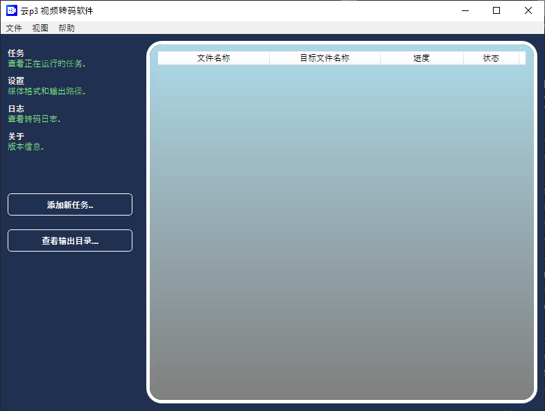

  29. Originally Posted by abeelandig View Post
    Here's the one off my micro SD card. I never used it in the end so don't know how well it works:
    https://forum.videohelp.com/attachment.php?attachmentid=82035&stc=1&d=1725784752
    PwConverterSetup(1.0.2).exe 66.556KB
    CRC32: 55CF6E59
    Thanks for this file. My MP3 player is a similar model, but it directs after-sales service to wodgreat.com, which doesn't exist anymore.
    The file you uploaded is the only thing that has worked for me to convert videos to my MP3 player.
    One issue is that the language is in Chinese. I translated an image of the program's main screen.
    Original (Chinese)
    [Attachment 84528 - Click to enlarge]
    Translated (English)
    [Attachment 84529 - Click to enlarge]
    Clicking the Chinese version of the "Add A New Task" button allowed me to select the video file that I wanted to convert.
    Oddly, the converted file was a mirror image of the original. I resolved this issue by mirroring the original in Adobe Premiere. This resulted in the converted video being mirrored back to its original intended format.
