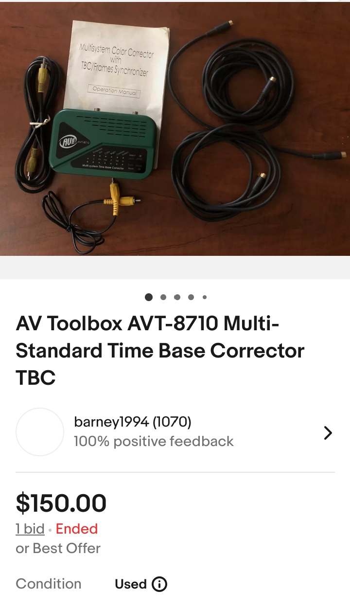

  13. Originally Posted by lordsmurf View Post
    What people often mean is that they can't find a TBC for the price of a cheeseburger, because they have odd notions (and based on nothing) about what quality AV/photo gear costs. If that's you, then correct, no TBCs exist.
    AVT TOOLS
    Green sold for the price of a "cheeseburger"
    [Attachment 82173 - Click to enlarge]
  14. Video Restorer lordsmurf's Avatar

    Originally Posted by VHSvideocapture View Post
    AVT TOOLS
    You apparently don't know how eBay's "best offer" works.
    - For that AVT-8710, eBay sold listing says "Best offer accepted".
    - The starting auction list price was for $150.
    - It could have sold for $1000 or more, and probably did.
    - And yet, eBay will end the listing with $150 shown as the "sale" price for auctions. The number is crossed out for fixed-price listings.
    eBay also does not show returns, and which there are many for AV gear (because many of the sellers are liars and idiots). That seller put "Sold As IS with no returns", but the text is meaningless. That seller is a verified idiot from that alone. In most cases, it means the person has no idea if it even turns on, and is a month+ long eBay nightmare waiting to happen.
    I'm not sure how much it went for it could have been $400 but someone bought a TBC from ebay took the risk when you keep advising against it, could it be because you have a conflict of interest in this?
    ebay seller sells the AVT tools 8710.green say for $1000 and Lordsmurff sells the same TBC for $2000, obviously the buyer will go with the cheaper option, this is why you often come up with caveats oh don't buy TBC 1000 from ebay faulty caps ebay sellers lie about replacing them buy from me. Don't buy the TBC 3000 it has had changes to production only I know what to lookout for when it comes to TBC 3000, the ebay ones are all bad you will be waiting your money.

    FYI, the reason that I started to refurb gear for others (and yes, sell it to them, it ain't free), is precisely because I started to see how pitiful eBay had become for acquiring gear. Literally 80%+ of all VCRs there are now trash, most TBCs are botched in some way (flawed chips, failed DIY repairs, incomplete, etc), and the capture cards are jumbled up without boxes/docs (ie, versions).
    "Obviously" nothing. There is a vast difference between a fully refurbished item, that comes with full support for usage -- and some dipstick on eBay that doesn't even know what it does. At some point, "in for a penny, in for a pound", it's about peace of mind. $1k to a total random unknown isn't the same as $2k to a known known.
