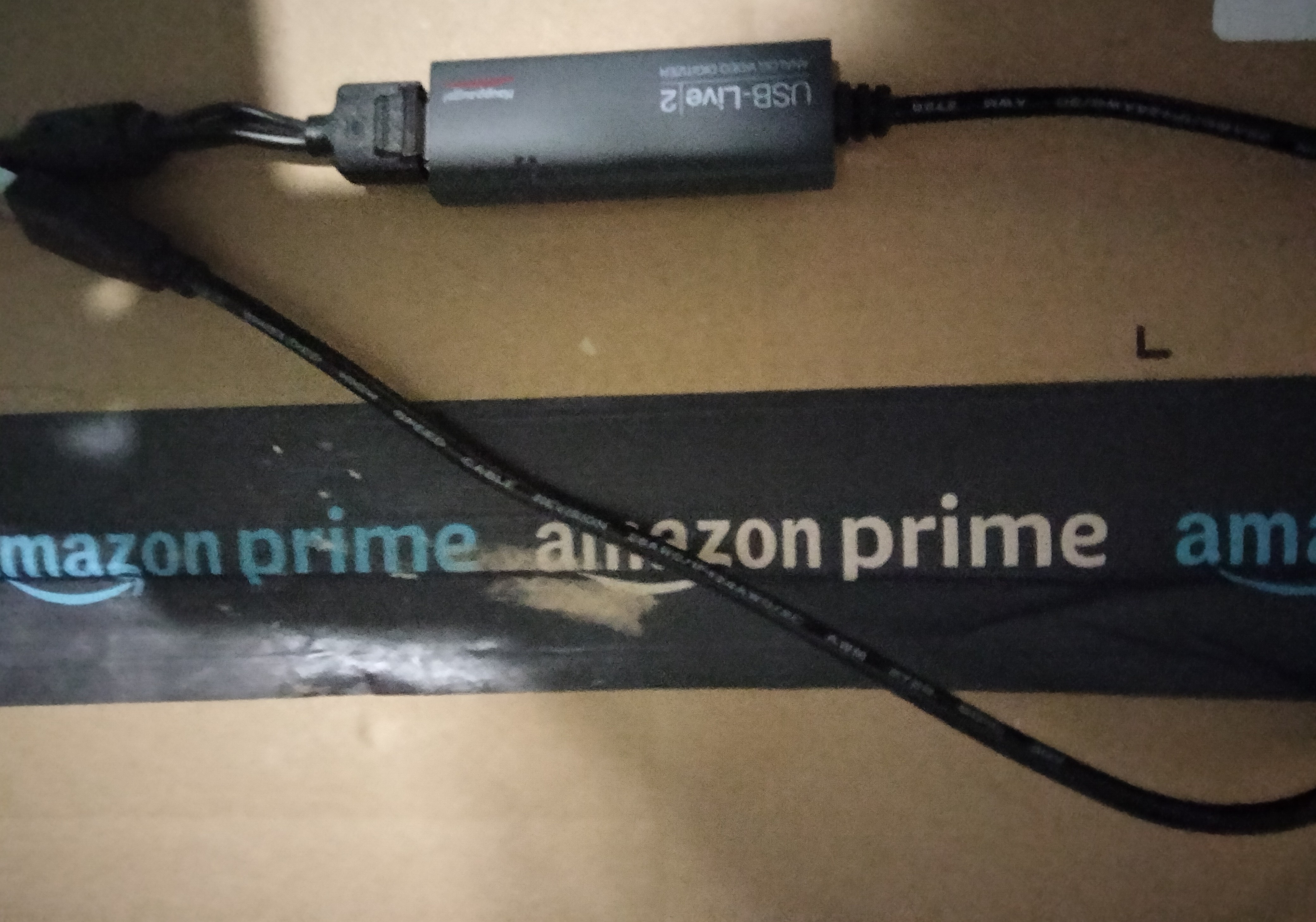

    1- diamond vc 500 2- hauppage live usb-2
    3- io data gv-usb2

    Yes
    Does it suffer from AGC issues like diamond VC500
    Not in my tests which I have made for various scenarios
    Which JVC HR VCR is the best?
    The one which gives the best results for your tapes. Generally, a S-VHS model with internal TBC is preferred. A mediocre sub-par model in good working condition may perform better than a worn "top" model in poor working condition though, from the x-th user, x-times shipped .... The question for "best" cannot be answered - what is the "best" car, "best" Ford model?
    What if I only have lower quality model?
    Well, lower quality probably, what else? In tendency more glitches, wiggling, rollovers, less details, .....The differences may be subtle though, it also depends on your tapes. You have to try and see what you get.

    User lordsmurff says all the time in many posts that diamond changed production and so did the hauppage live USB 2 also popular he seems to hate both of these cards he is a senior member here
    The Hauppauge USB-Live 2 had no production change, period. Do not trust "opinions" not confirmed by facts and evidences; and my friend lordsmurf is not a reference (blu smurf, I wrote you're my friend, ok? )
    VC500 has been proven to feature AGC issues in the past from some users, not from other others. Then is prone to have AGC issues.

    I have this one already
    See picture am sending you.
    When you say happy are you getting perfect results or are you getting some minor issues like jumping?
    Are you using any kind of TBC or Panasonic ES15 as pass through?
    I bought it from Amazon Image
    [Attachment 75586 - Click to enlarge]

    So JVC HR9500 with Panasonic ES15 which I have
    and hauppage live usb-2 which I also have picture posted
