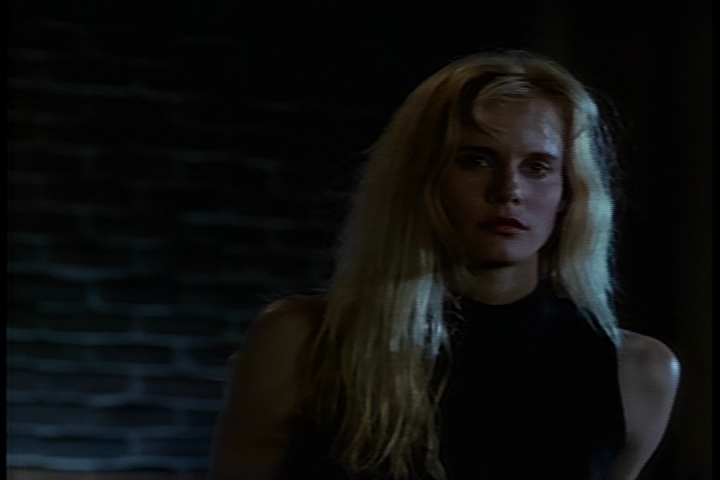

  12. Turns out that BOB is not that bad. But sharpen with FFT3DFilter work better after reinterlacing.
    Now getting back to the clip from my first post - after taken care of the chroma bleeding, I'm still trying to fix halo/ghost issue.
    With FineDehalo it's look better, but I still have one bright halo/ghost.
    [Attachment 82903 - Click to enlarge]
    Is it possible to get rid of that line without degrade picture too much furter?

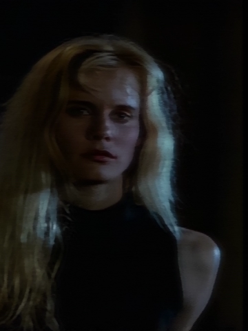

  14. Thanks, jagabo!
    Maybe I do something wrong with dehalo_alpha (or with edge mask), since don't got much improvement using it?
    Spline36Resize(width/2, height)
    emask=mt_edge(mode="prewitt", thy1=0, thy2=255, U=2, V=2)
    Overlay(last, dehalo_alpha(rx=2.0, ry=1, BrightStr=0.8, DarkStr=1.2), mask=emask)
    Spline36Resize(width*2,height)
    But I got much better results from FineDehalo (although don't eliminated this bright line completely).
    FineDehalo2(hconv = "-1 -1 1 1 40 1 1 -1 -1", vconv = "-1 -1 1 1 40 1 1 -1 -1", showmask=0)
    FineDehalo(rx=2.0, ry=1.0, thmi=60, thma=128, thlimi=50, thlima=100, darkstr=1.2, brightstr=0.8, showmask=0, contra=0.0, excl=true)
    [Attachment 82954 - Click to enlarge]

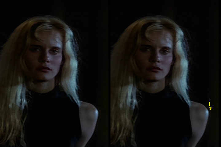

  15. You used a different rx value than jagabo suggested.
  16. Originally Posted by Selur View Post
    Well, rx=7 was suggested for no downscale-upscale involving. And it not look good.
    Overlay(last, dehalo_alpha(rx=7, ry=1, BrightStr=0.8, DarkStr=0.8), mask=emask)
    [Attachment 82956 - Click to enlarge]
    With downscale-upscale
    [Attachment 82959 - Click to enlarge]
    I tried rx=3.5 too
    Overlay(last, dehalo_alpha(rx=3.5, ry=1, BrightStr=0.8, DarkStr=0.8), mask=emask)
    [Attachment 82960 - Click to enlarge]

    emask = Spline36Resize(400, height).mt_edge(thy1=10, thy2=10).mt_expand().mt_expand(mode="horizontal").Blur(1.0).GreyScale().nnedi3_rpow2(2, cshift="spline36Resize", fwidth=720, fheight=height)
    dh = Spline36Resize(400, height).dehalo_alpha(rx=3.5, ry=1, BrightStr=0.0, DarkStr=0.8).Spline36Resize(width, height).Sharpen(0.5, 0.0)
    Overlay(last, dh, mask=emask)
  22. An even more selective edge mask would be:
    emask = Spline36Resize(400, height).mt_edge(mode="-1 2 -1    -1 2 -1   -1 2 -1   6").mt_expand().mt_expand(mode="horizontal").Blur(1.0).GreyScale().nnedi3_rpow2(2, cshift="spline36Resize", fwidth=720, fheight=height)
    It only detects vertical edges.
