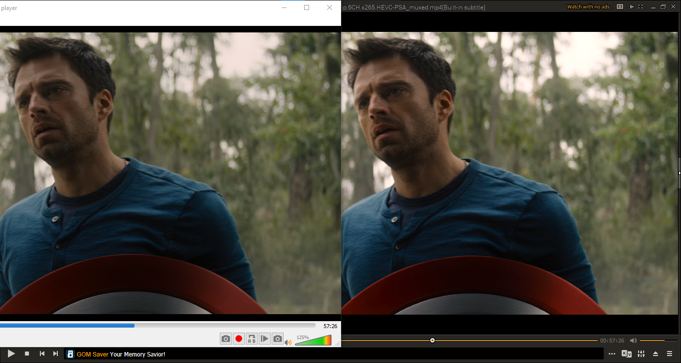

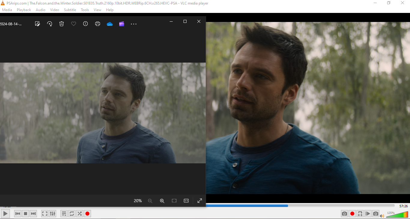

    I had a problem once and this forum helped me resolve it really quickly, so thats why I'm asking here for help again. I have a problem with VLC player but more accurately the colors of the screenshots I take with it. I use VLC as my main video player, because it rarely glitches, plays all kinds of video formats and it's really easy to take screenshots with it. However recently I started having a problem with that, because even if the colors while playing the video are normal, when I take a screenshot they are really dull with almost no saturation.
    [Attachment 81446 - Click to enlarge]

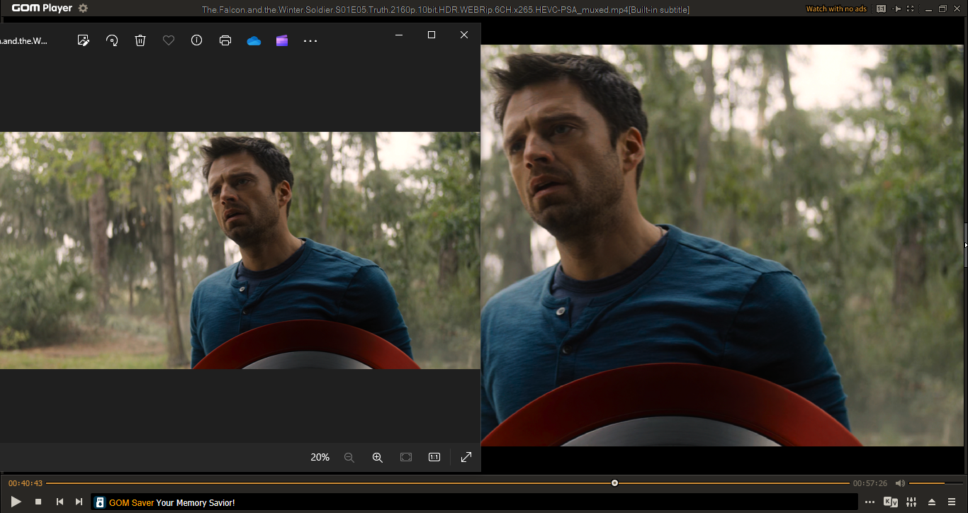

    Now I also use GOM player sometimes so I decided to check if the result will be the same with it, but it wasn't. With it, the colors of the screenshot are the same.
    [Attachment 81447 - Click to enlarge]
    So apparently the problem is with VLC because even whille playing the video the colors compared to GOM are a bit different (in GOM the colors have a the slightest bit more saturation).
    [Attachment 81450 - Click to enlarge]
    So the question is what eactly might be the problem with VLC and how to solve it. I don't know if it'll help, but just in case here's a mediainfo report of the video I used for the example:

  2. This video was encoded in a wrong way, missing the necessary HDR to SDR settings.

  4. Color primaries, transfer characteristics and color matrix should be BT.709.
    Google for a way to change this colorspace tags without reencoding, with ffmpeg and the -bsf filter.
    I'm out, so i can't help you further now, but at my return the next days I'll come back to you.
  5. Here you go:
    ffmpeg -i "C:\Downloads\TV Shows\The.Falcon.and.the.Winter.Soldier.SEASON.01. S01.COMPLETE.2160p.10bit.HDR.WEBRip.6CH.x265.HEVC-PSA\The.Falcon.and.the.Winter.Soldier.S01E05.Truth .2160p.10bit.HDR.WEBRip.6CH.x265.HEVC-PSA_muxed.mp4" -bsf:v hevc_metadata=colour_primaries=1:transfer_characteristics=1:matrix_coefficients=1 -color_primaries 1 -color_trc 1 -colorspace 1 -color_range pc -c copy output.mkv
    This will convert all colorspace tags to BT.709.
    No recoding occours, just streamcopy and therefore fast.
    Your source file remains untouched, the new video is created in the ffmpeg.exe folder.

    Thank you for the advice, I'll try to do that (even if I have a problem with figuring out ffmpeg), but I still think the problem is somehow with VLC player and not the video itself, because with GOM player everything's normal. Still, thank you so much.
