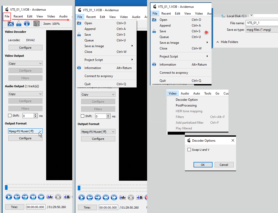

  4. @alwyn - THANK you so much! I really appreciate it.
    Downloaded AVIDemux and installed it, went through all the steps in your tutorial. It is easy and clear. Super.
    However, at the very very end (last paragraph) - "That’s it, now do a Save As..." there is no 'Save As' only 'Save'.
    and I regret I do not an option to save as MP4.
    But.. no doubt I am doing something wrong.
    The DVD is reduced from 4.3GB to 1.5GB, poor quality I am afraid.
    I do not care about the size. Video Mastering Works produces about the same size, roughly 4.2-4.3.
    Is there a way to improve it?
    Also how to have subtitles displayed?
    Sorry for all the questions.
    [Attachment 81268 - Click to enlarge]
    May 2005
    Australia-PAL Land
    Ooops, yes, you're right, the option on the file menu is "Save". All the settings you have there are correct: basically, Video>Copy, Audio>Copy (with the track you want) and then select MPEG PS Muxer.
    I'm not doing anything with the Video menu on the Configure button.
    When you hit Save, in the next box, the Save As Type should be MPEG and when you hit the Save button, within a couple of minutes you'll have all the VOBs joined up with no recoding. If the DVD was full, you'll get an MPEG similar size and it will be the same quality as the DVD.
    Unfortunately, this method does not bring across any subs; nor does DVDVOB2MPG as far as I am aware.
    MakeMKV will rip DVDs directly into MKV format with the MPEG 2 codec unchanged; it might bring the subs.
    Added: you can do a quick check on the saved file: open it in AVIDemux and go File>Information. If you're not seeing MPEG as the Codec 4CC, the VOBs have been recoded.
    Added2: I've updated my website to make that "Save" clearer, and also added a note about the subtitles.

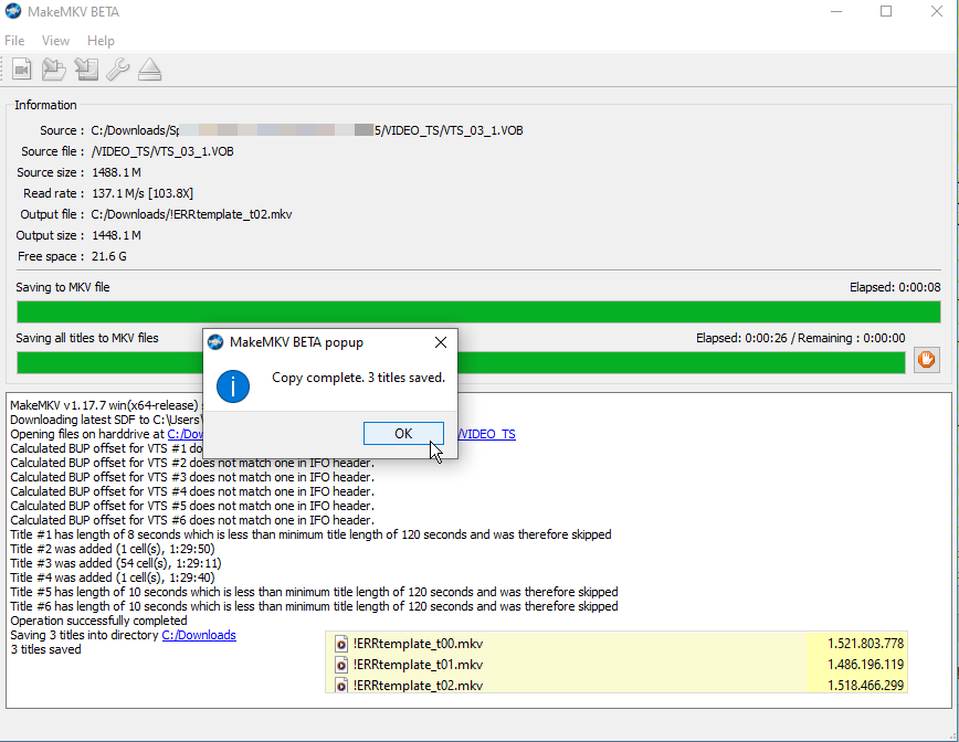

  8. Sorry for my late reaction.
    Thank you all for the responses. Super.
    Let me try MakeMKV and get back on this.
  9. Bad luck...
    MakeMKV - Only got three "!Errtemplate" files
    [Attachment 81287 - Click to enlarge]
    Can not find a working solution on Internet.
    The only solution I found is naming file {NAME1} but that did not work.
