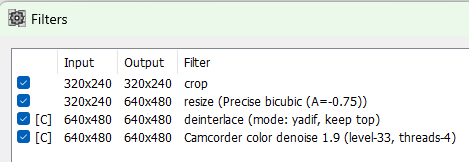

    Hello again!
    Installing and configuring AviSynth+ wasn't easy, but I didn't give up Ultimately, there were two solutions left on the battlefield:
    1. VirtualDub2 with filters as below
    [Attachment 81431 - Click to enlarge]
    2. AviSynth (supported by VirtualDub2) and a script by Sharc as above (I only changed the model from 25 to 54 - the difference is not really noticeable, I wanted to check if the higher model would improve anything)
    From both points, I exported files in VirtualDub2 without any compression and then loaded them into the Filmora video editor and converted them to mp4 at 30 fps.
    The undisputed winner is solution 2. while the image itself is of similar quality, the smoothness of the display is much better than in the first point. Filmora probably can't convert from 15 to 30 fps that well. I enclose here both final movies.
    Perhaps it would be possible to add a 15->30fps filter to the first point, but that's probably due to something external.
    Unfortunately, I encountered a problem - the second point gave me a video without audio... Do I have to process them separately in this method and then somehow join them? I don't hide the fact that it would add a lot of work to me because I have a lot of movies to convert.
    Regards!
    May 2005
    Australia-PAL Land
    Re the VDub process, you shouldn't be deinterlacing; it's already Progressive as far as I can tell. You're probably taking out good frames, making the motion jerkier.
    If you set up the deinterlacer in VDub, choose Double Rate Top field first then step thru the video, you'll see movement on every second frame. That means it's Progressive already.
    I might have that all wrong, of course, so in that case I will be punished by you know who. But I can cope.
