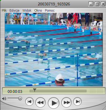

  1. I found a lot of family movies in my old Kodak DX6340 digital camera. Unfortunately, none of the editors (Filmora, Davinci, Movavi, MovieMaker) or any player (except Apple QuickTime Player) can display them correctly - the bar always appears on the right and at the bottom: Image
    [Attachment 81187 - Click to enlarge]
    I spent many hours looking for the reason and it seems to me that it is because:
    - Kodak used H263 as the codec
    - H263 codec has a native (one of many) resolution of 352x288 (does not support 320x240)
    Kodak in its camera specifications: link 1 states that the videos are 320x240 and that is how they are played when I connect the camera to a TV with a cable or when I play them on my computer using QuickTime Player: Image

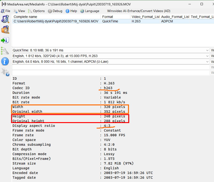

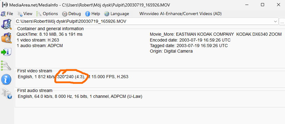

    - The MediaInfo application gives the same size: Image
    [Attachment 81189 - Click to enlarge]
    - And now the most important thing: MediaInfo gives the following data: Image
    [Attachment 81190 - Click to enlarge]
    With/Height = 320/240, Original Width/Original height = 352/288, Display aspect Ratio = 4:3 So, when I try to open this MOV in movie editors or players - those applications look at the wrong parameters. They should look at 320/240 and 4:3. And they look at 352x288 (additionally - it is not 4:3!) so then they artificially draw this black bar on the right and at the bottom.
    Is there any way to force the appropriate interpretation on the MOV header? For example, by modifying this header somehow? If anyone would like to see it on their own, I am attaching this MOV file: https://drive.google.com/file/d/1u77e-S2UZN7-2WAzSbkmo32EtkJ7Ikw4/view?usp=sharing

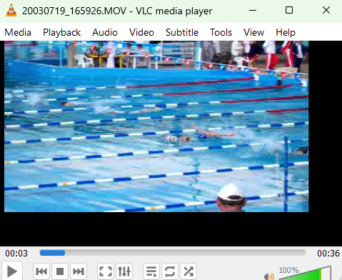

    May 2005
    Australia-PAL Land
    Those black bits are burned into the file. You can see this when playing it it VLC Player. While it's playing, drag the right side in; you'll see the video shrinking. That's because the black border on the right is part of the image.
    You'll have to crop away the bottom and right-side bars and then re-encode as 4:3. Here's my attempt with VirtualDub2 into 640x480. Pretty jittery!

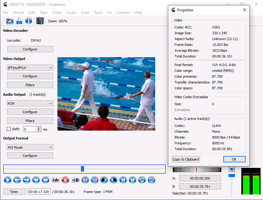

  4. Member The_Doman's Avatar
    Feb 2004
    Netherlands
    It opens also correctly with Avidemux.

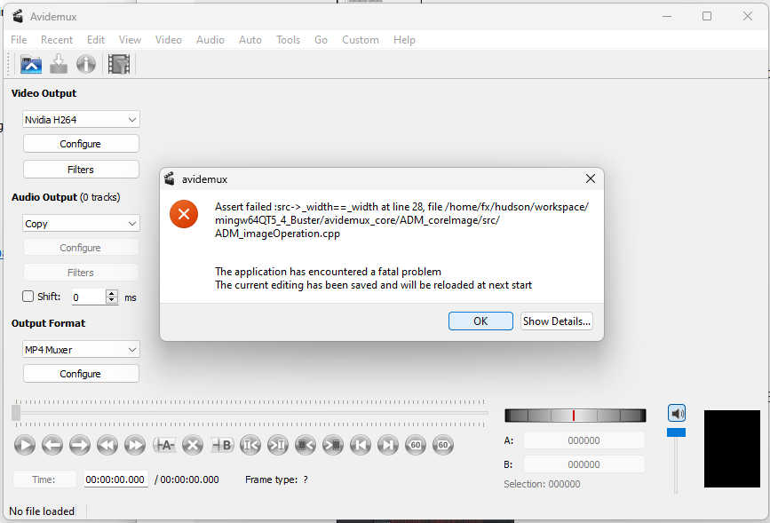

    But with (all?) the later Nightly builds it crashes directly when opening.
    The codec/resolution combination is confusing many programs it seems.
    With Avidemux 2.8.1:
    [Attachment 81237 - Click to enlarge]

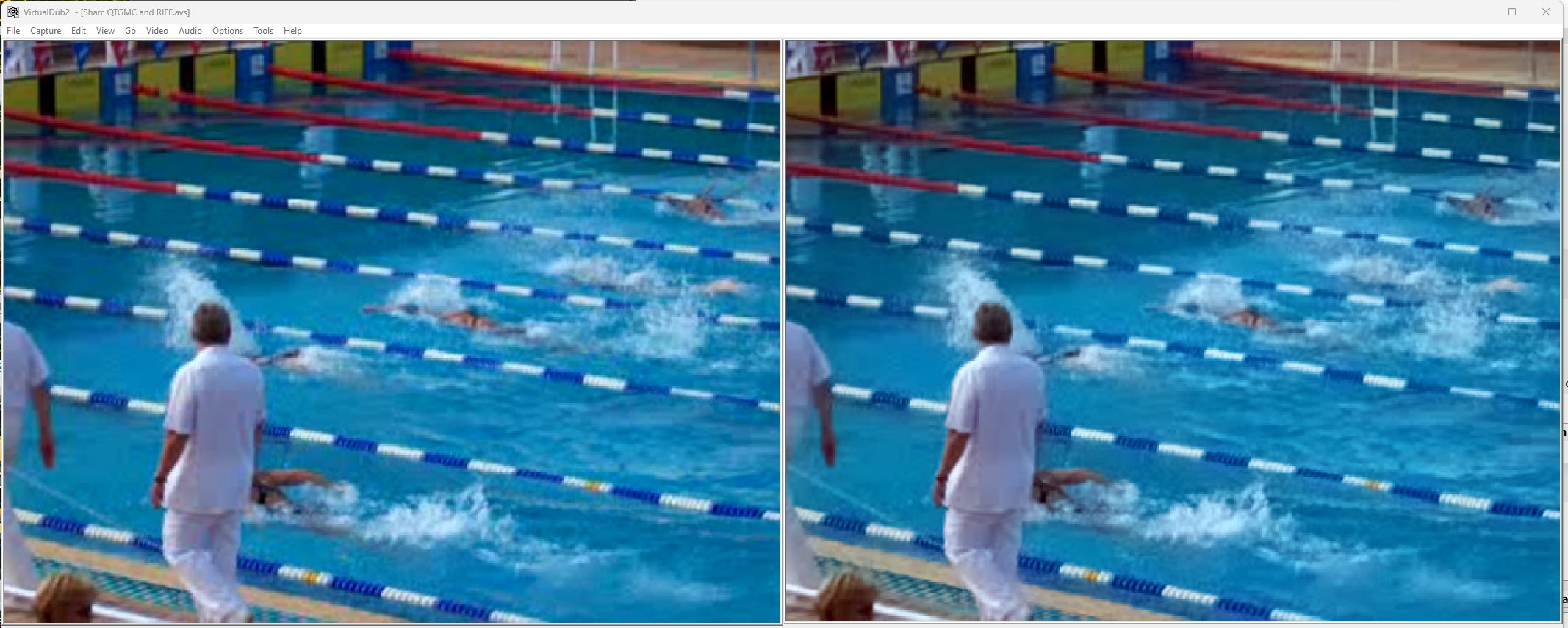

    And add VDub's Camcorder Colour Denoise (set on 240). Observe far pool deck around the ladder.
    [Attachment 81242 - Click to enlarge]

  13. Originally Posted by The_Doman View Post
    This is a milestone for me on the way to saving my family movies!
    I opened my movie in AviDemux and set the "Copy" options and then saved it as AVI and - that's it! Thank you very much for this tip!
    I assume that the "Copy" option does not recompress the movie (as I wrote earlier, I want not to add more detail losses to the movie).
    I will also have to read up on whether AviDemux can work in batch mode because I have a lot of these family movies.

  23. Originally Posted by abramq View Post
    With copy to AVI the right/bottom bars remain.
    With the settings from your picture the videostream is cropped and reencoded to HuffYUV, and the audiostream to pcm.
    So no milestone and no magic.
    Many other video editors can do the same.
  24. Member The_Doman's Avatar
    Feb 2004
    Netherlands
    Those settings in the Avidemux screenshot were shown as an example.
    It then will of course re-encode to HuffYUV but there was no cropping needed.
    A direct copy to Avi will work, but most/all player/codecs still fill the resolution to the H263 352×288 (a.k.a. CIF) format it seems.
    It is a really annoying codec format.

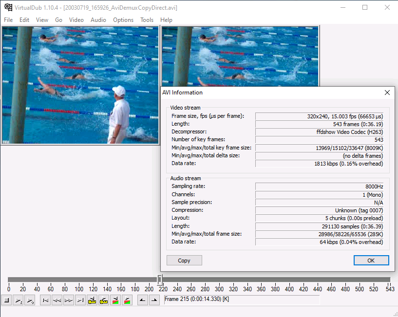

    But with my older Virtualdub (1.10.4) and the ffdshow codec it opens the avi with the correct resolution, but with a warning about the audio codec.
    [Attachment 81266 - Click to enlarge]
  25. Member
    May 2005
    Australia-PAL Land
    I agree with ProWo, AVI with AVIDemux isn't a viable option; for example, Magix now won't open that audio or the AVI video.
    If the OP has a heap of them to convert into something editable, I think Sharc's method with batching would be the best; Handbrake will do batching but not to AVI+PCM. Placebo H264 could be used to edit.

  29. Originally Posted by ProWo View Post
    Right, mea culpa I wanted to test all the suggestions from this forum as soon as possible and I must have looked in the wrong place. I was also misled by AviDemux, which always showed the movie on preview without black frames.
    Anyway, after setting HuffYUV, the black frames disappear However, while Filmora opens this file, media players show an error about an unknown codec)
  30. Originally Posted by Alwyn View Post
    I can't open MOV file in VDub
    Are you using Virtual Dub 2?
    Sorry, my fault, I was using ver 1. Now, in ver 2 I can open it. Thanks!
