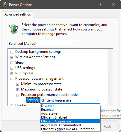

    I posted this here before.
    If you want to reduce the CPU temperature you can try to adjust the Turbo boost settings to less aggressive or even turn it off.
    Those settings are normally hidden in the Windows power scheme settings but you can enable them.
    Reddit: Important Update To PROPERLY DISABLE Boosting
    Ctrl.blog: Disable processor boost mode to prolong your battery life
    It is mainly referred to Laptops to prevent overheating/fan noise but it works just as well for desktops.
    First try to adjust the Turbo boost mode to "efficient enabled" or "efficient aggressive" and see if this helps?
    [Attachment 79551 - Click to enlarge]
    How to cool down CPU while encoding with GPU
    Originally Posted by Arctic View Post
    Yes, it works now! Thanks. Changed to "Efficient Aggressive".
    CPU load now 70+% (down from 80+%), on NVEnc 265 10-bit
    CPU temp is 70+C... I'm more comfortable with this level.
