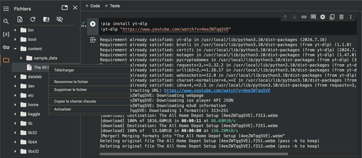

I could suggest doing it on google colab for free (ironic to download google videos hosted on google servers using google servers
(File can be downloaded in /content/)HTML Code:!pip install [url=https://www.videohelp.com/software/yt-dlp]yt-dlp[/url] !yt-dlp "YOUR VIDEO URL"
[Attachment 80786 - Click to enlarge]
Or on a cheap VPS too. -

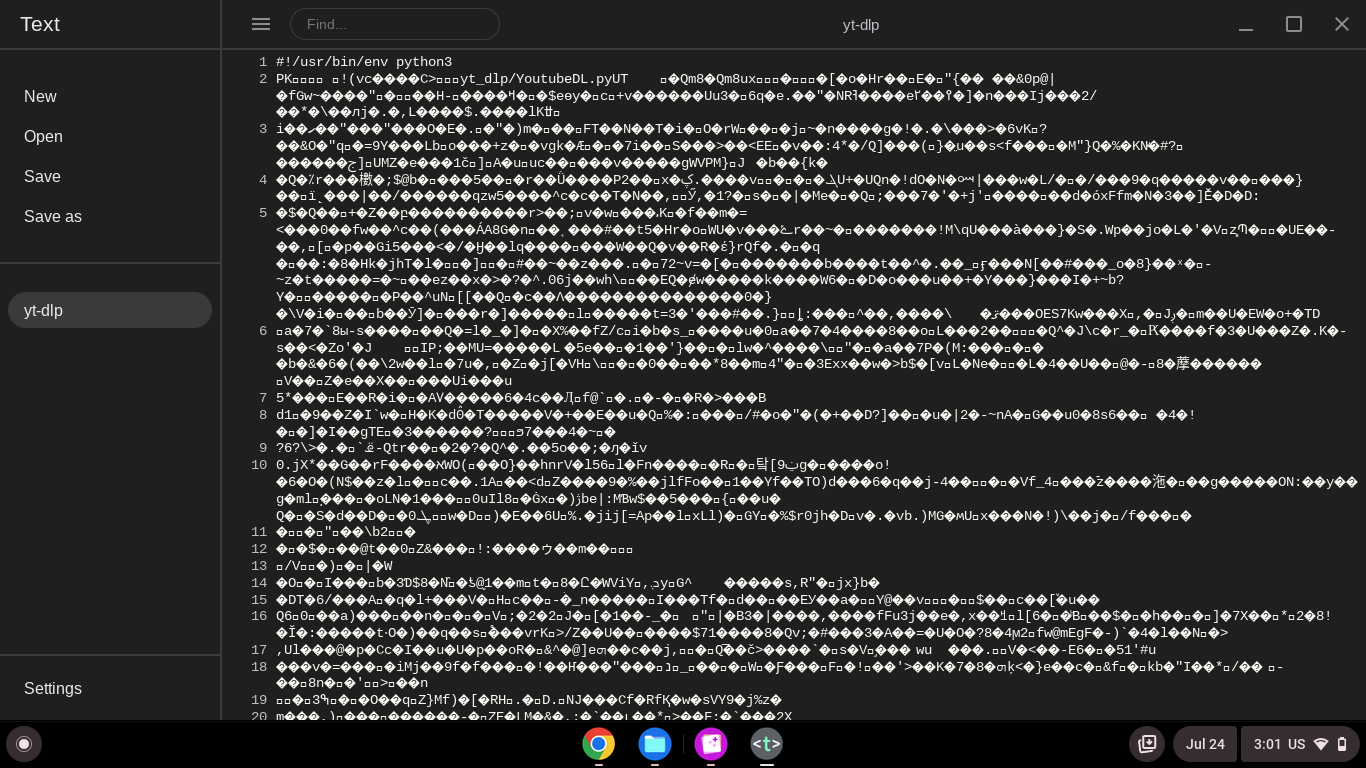

So when I try to download/install yt-dlp on this page https://www.videohelp.com/software/yt-dlp clicking the Linux one, it puts a file on that says it is 27.3mb. When I click it to open it just loops back to the same file page to save it again. When I save it again, it says there is already a file with this name.
When I try to download from the other link you posted, thank you!, here https://github.com/yt-dlp/yt-dlp?tab=readme-ov-file#installation clicking the Linus version
it puts a 2.8mb file that looks like this:
[Attachment 80915 - Click to enlarge]
Any guidance would be very much appreciated. At week three and haven't figured it out yet on this machine for this week's class recording expiring tomorrow https://facim.org/encounters-with-ken-recording-308935/.

Feels Good Man, you are very kind. Thank you third time, truly. Regarding IDM, is that another thing like yt-dlp or is that something that helps to install yt-dlp?
I am slowly starting to wonder if with the Inspect way I was able to do having stopped working and not being able to find any information as to why and if there
is a workaround anywhere, including this forum so far, if I am just going to have to let it go. The strange symbols in the screenshot above when I tried to install yt-dlp seem to indicate to me that it isn't going to work on this chromebook maybe. I haven't given up all hope yet, but am planting the seeds of befriending the death of being able to have a little more time to watch this weekly class before it is taken down each week.
