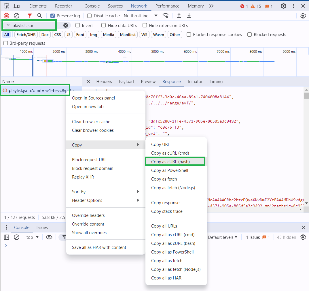

Did you enter the .json URL from the network tab? That error means that the program got a status code that isn't 200. try editing the script by adding your headers from curlconverter in the send_request method. Copy the request as cURL in your browser as POSIX/bash and paste it on curlconverter.com

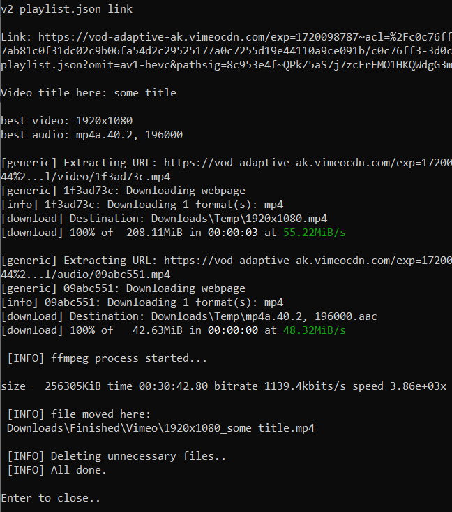

[Attachment 80416 - Click to enlarge]
Code:import subprocess import requests import shutil import os import re # 'yes' for auto best selection or 'no' for manual selection auto_best = 'yes' dirs_to_cr = [ 'bin', 'Downloads/Finished/Vimeo', 'Downloads/Temp' ] for directory_path in dirs_to_cr: os.makedirs(directory_path, exist_ok=True) temp_dir = 'Downloads/Temp' if os.path.exists(temp_dir): shutil.rmtree(temp_dir) yt_dl = '.\\bin\\yt-dlp.exe' ffm = '.\\bin\\ffmpeg.exe' yt_dl_file_exists = os.path.isfile(yt_dl) if yt_dl_file_exists: pass else: print(f"The file {yt_dl} does not exist.") print(f'inside bin directory, put these files: \n yt_dl.exe\n ffmpeg.exe') ex_it = input('Press Enter to exit....') exit() print(''' v2 playlist.json link ''') link = input('Link: ') try: bef_v2 = re.findall(r'(https:.*exp.*hmac.*)/v2/playlist', link)[0].strip() except IndexError: print(' [ERROR] this is not a v2 playlist.json link!') ex_it = input('\nEnter to close..') exit() video_title = input('\nVideo title here: ') headers = { 'accept': 'text/html,application/xhtml+xml,application/xml;q=0.9,image/avif,image/webp,image/apng,*/*;q=0.8', 'user-agent': 'Mozilla/5.0 (Windows NT 10.0; Win64; x64) AppleWebKit/537.36 (KHTML, like Gecko) Chrome/126.0.0.0 Safari/537.36', } resp = requests.get(link, headers=headers).json() video_data = [ { 'id': re.match(r'(.*?)-', video['id']).group(1), 'width': video['width'], 'height': video['height'], 'video_res': f"{video['width']}x{video['height']}", 'video_link': f"{bef_v2}/parcel/video/{re.match(r'(.*?)-', video['id']).group(1)}.mp4" } for video in resp['video'] ] audio_data = [ { 'id': re.match(r'(.*?)-', audio['id']).group(1), 'codecs': audio['codecs'], 'bitrate': audio['bitrate'], 'audio_details': f"{audio['codecs']}, {audio['bitrate']}", 'audio_link': f"{bef_v2}/parcel/audio/{re.match(r'(.*?)-', audio['id']).group(1)}.mp4" } for audio in resp['audio'] ] video_data.sort(key=lambda x: (x['width'], x['height']), reverse=True) audio_data.sort(key=lambda x: x['bitrate'], reverse=True) sel_vid_name = None sel_aud_name = None options = [] if auto_best == 'no': print("\nAvailable options:") for idx, video in enumerate(video_data, start=1): video_id = video['id'] video_res = video['video_res'] options.append((idx, f"video | {video_res} | {video_id}", video['video_link'])) if auto_best == 'no': print(f"{idx} - video | {video_res}") for idx, audio in enumerate(audio_data, start=len(video_data) + 1): audio_id = audio['id'] audio_details = audio['audio_details'] options.append((idx, f"audio | {audio_details} | {audio_id}", audio['audio_link'])) if auto_best == 'no': print(f"{idx} - audio | {audio_details}") if auto_best == 'yes': sel_vid_name = video_data[0]['video_res'] selected_video_link = video_data[0]['video_link'] sel_aud_name = audio_data[0]['audio_details'] selected_audio_link = audio_data[0]['audio_link'] print(f"\nbest video: {sel_vid_name}") print(f"best audio: {sel_aud_name}\n") subprocess.run([yt_dl, '-N', '16', '--no-warning', '--no-check-certificate', '-o', f'{temp_dir}\\{sel_vid_name}.mp4', selected_video_link]) print() subprocess.run([yt_dl, '-N', '16', '--no-warning', '--no-check-certificate', '-o', f'{temp_dir}\\{sel_aud_name}.aac', selected_audio_link]) if auto_best == 'no': selection = input("Write numbers here (one video, one audio e.g; 1 4): ").split() selection = [int(num) for num in selection] selection_str = ', '.join(map(str, selection)) print(f'\nSelected: {selection_str}') for num in selection: for option in options: if option[0] == num: print(f"\nProcessing: {num}") if "video" in option[1]: sel_vid_name = option[1].split('|')[1].strip() selected_video_link = option[2] print(f"{sel_vid_name}\n") subprocess.run([yt_dl, '-N', '16', '--no-warning', '--no-check-certificate', '-o', f'{temp_dir}\\{sel_vid_name}.mp4', selected_video_link]) elif "audio" in option[1]: sel_aud_name = option[1].split('|')[1].strip() selected_audio_link = option[2] print(f"{sel_aud_name}\n") subprocess.run([yt_dl, '-N', '16', '--no-warning', '--no-check-certificate', '-o', f'{temp_dir}\\{sel_aud_name}.aac', selected_audio_link]) if sel_vid_name and sel_aud_name: output_x = f'Downloads\\Finished\\Vimeo\\{sel_vid_name}_{video_title}.mp4' print('\n [INFO] ffmpeg process started...\n') subprocess.run([ffm, '-v', 'quiet', '-stats', '-y', '-i', f'{temp_dir}\\{sel_vid_name}.mp4', '-i', f'{temp_dir}\\{sel_aud_name}.aac', '-c', 'copy', output_x]) else: print("\n [ERROR] Need video and audio picked..") print(f'\n [INFO] file moved here:\n {output_x}') print('\n [INFO] Deleting unnecessary files..') temp_dir = 'Downloads/Temp' if os.path.exists(temp_dir): shutil.rmtree(temp_dir) print(' [INFO] All done.') ex_it = input('\nEnter to close..') exit()

in the developer tab on the playlist.json GET I don't see anything special, but you might have it..
which can check here:
[Attachment 80431 - Click to enlarge]
after that, if we can see something different than maybe can improve the script..
after
Copy as cURL (bash)
if you have a cookies or credentials in it
then change that, but not the structure!Last edited by sk8ordi3; 4th Jul 2024 at 19:54.
send this response,
[Attachment 80433 - Click to enlarge] -

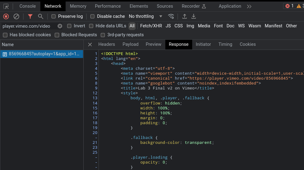

The response is quite big. Not sure exactly what should I look for. I found the same playlist.json I had when I inspected the video window. Probably not it, right?

Uploading the headers and the Response to player.vimeo.com
Thank you very much for your help. -
