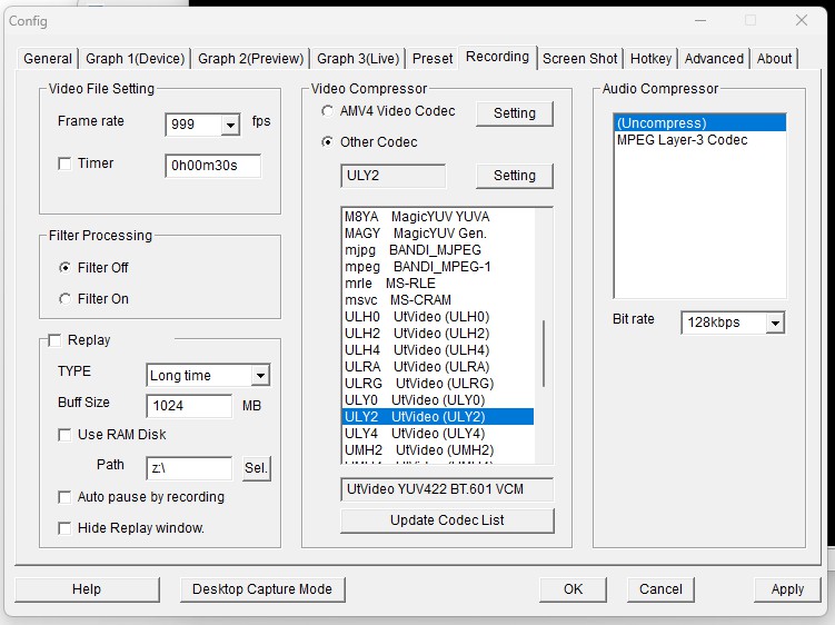

    I managed to record well with amarectv the only thing i wonder is if i must record 25fps or 50fps to capture the 50 fields from interlaced signal
    Mar 2008
    Set it to 25 and use a lossless codec, such as UT codec
    https://www.videohelp.com/software/Ut-Video-Codec-Suite
    May 2005
    Australia-PAL Land
    For UTVideo, use the YUV422 BT.601 VCM (ULY2) codec:
    [Attachment 80319 - Click to enlarge]
    How do i make it record in 16:9, the video is squeezed in 4:3 and there's no such settings the codec settings
    And about the other codec of the suite, differents results or essentially the same ?
