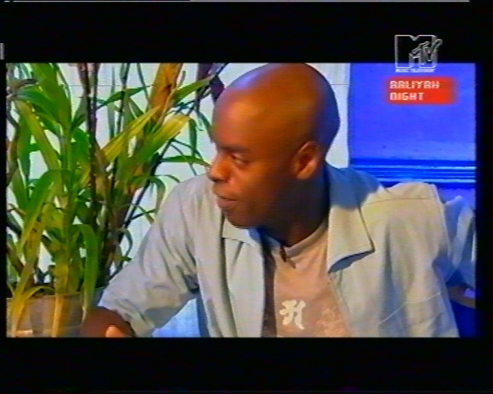

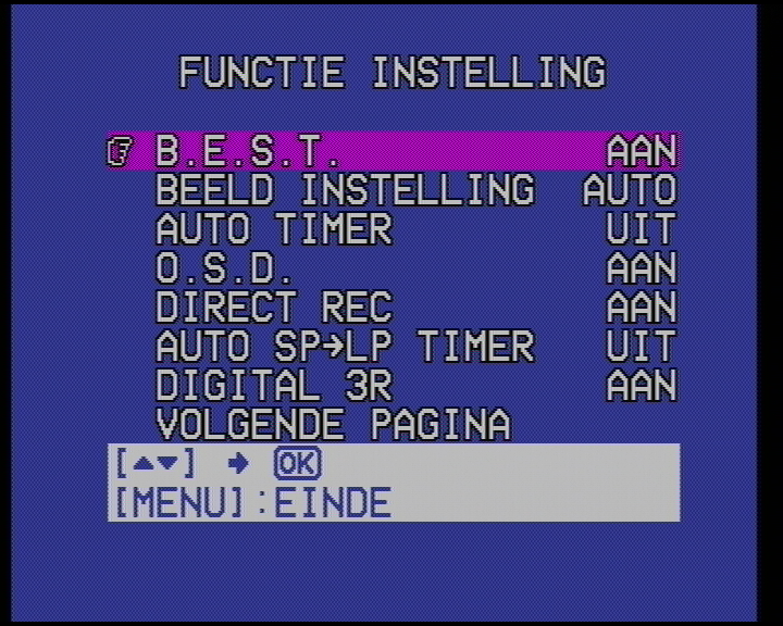

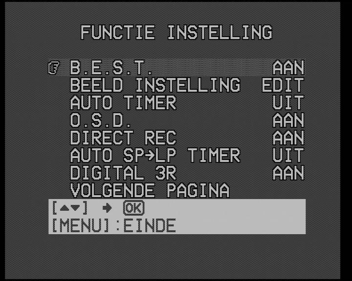

  1. I've recently acquired a JVC HR-S7700 and have been transfering some of the tapes I have left with an S-Video cable I recently got.
    I've noticed that there's a "checkboard" pattern present on the capture that is not present when I use Composite. You can find some screencaps from the same capture down below.
    Any clues of what's causing it?
    Much appreciated
    Kenny

    What's the hardware workflow and is the S-Video cable is coaxial type and well shielded, If you bought it from a Chinese market chances are a crappy S-Video cable.

  6. Originally Posted by kenator18 View Post
    Much appreciated
    Kenny
    It is most likely caused by a poorly screened S-Video cable which "converts" S-Video to composite by its crosstalk between the Y an C wires. As there is no luma/chroma separating filter in the S-video path one gets the dotcrawl, similar as known from (poor) composite. Hence a poor S-video cable clearly spoils the benefit of S-Video.
    See my explanations here:
    https://forum.videohelp.com/threads/403635-Panasonic-DVD-recorder-passthrough-settings...12#post2714801
    https://forum.videohelp.com/threads/411872-SCART-to-S-Video-adapter-strange-problems#post2708738
    In the composite setup you have a Y/C separating filter (comb filter) in the loop which makes the composite capture look better than the spoiled S-video with the cheap cable.
    Bottom line: Replace the crappy S-video cable by a decent one, and don't make it longer than needed (up to ~3...5 feet is normally ok for a well screened cable).

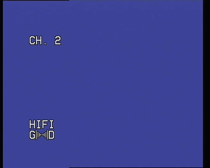

    I captured a few JVC's (PAL) here connected with S-Video to a Dazzle DVC100 (sharpness 0) and also with a Sony DCR-TRV120E DV camera.
    HR-S6700 SVideo connector Dazzle DVC100:

  10. The only models that'll not have this problem (on the menu) are the D-vhs and if you use YPrPb (pretty sure if you use s-video on these it'll be the same mess)
  11. Originally Posted by kenator18 View Post
    That's what the player is putting out. Internally the player use a composite character generator and they don't bother to filter the chroma carrier out of the s-video luma signal. And the capture device isn't expecting the chroma carrier on the luma signal so it doesn't bother to filter it out.
    You don't see this problem when capturing via composite because the capture device is expecting to see the chroma carrier there -- and knows to filter it out.

    Interesting. Nevertheless one can get a similar checkerboard effect on the video with poor S-Video cables causing crosstalk between the Y and C wires.

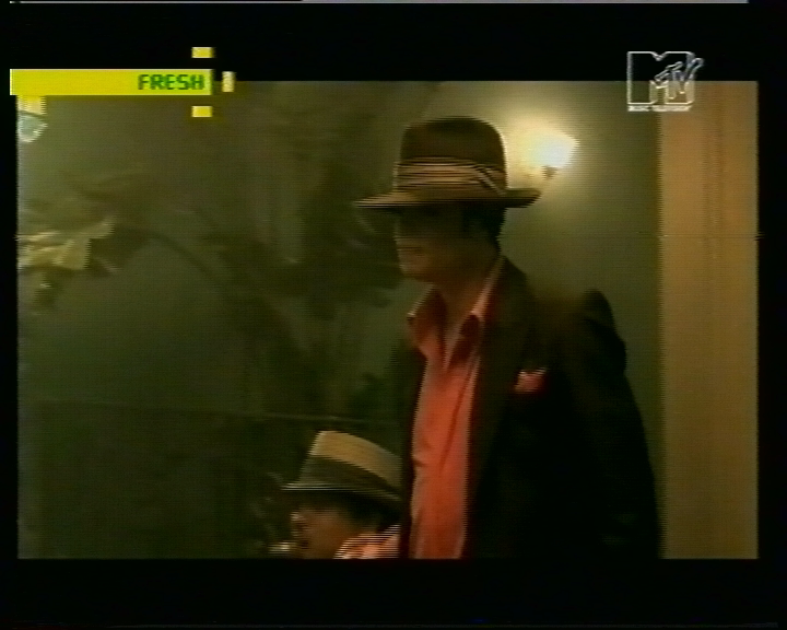

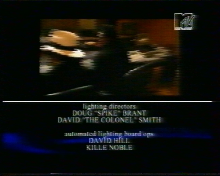

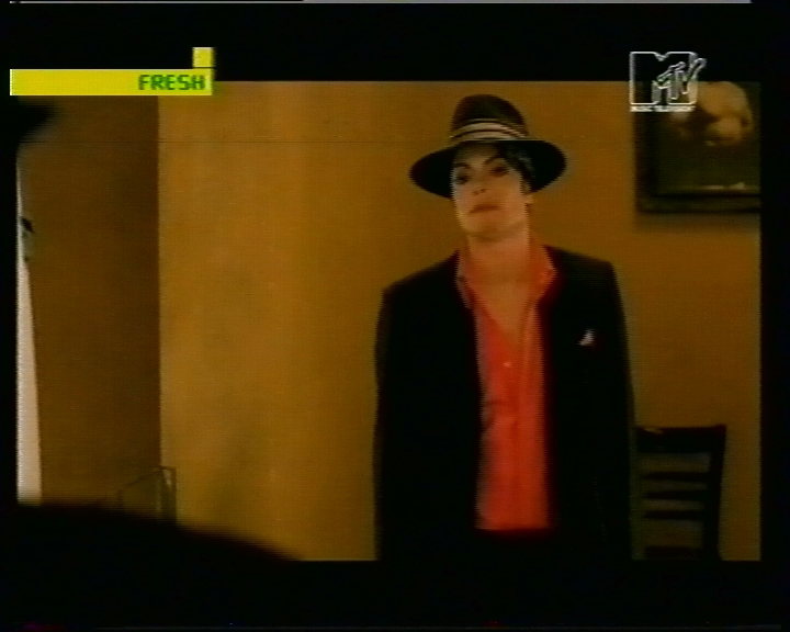

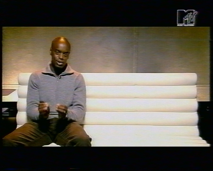

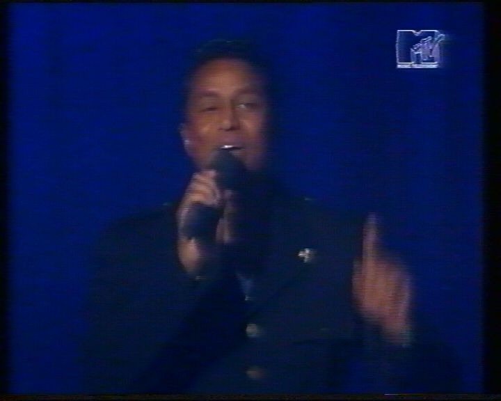

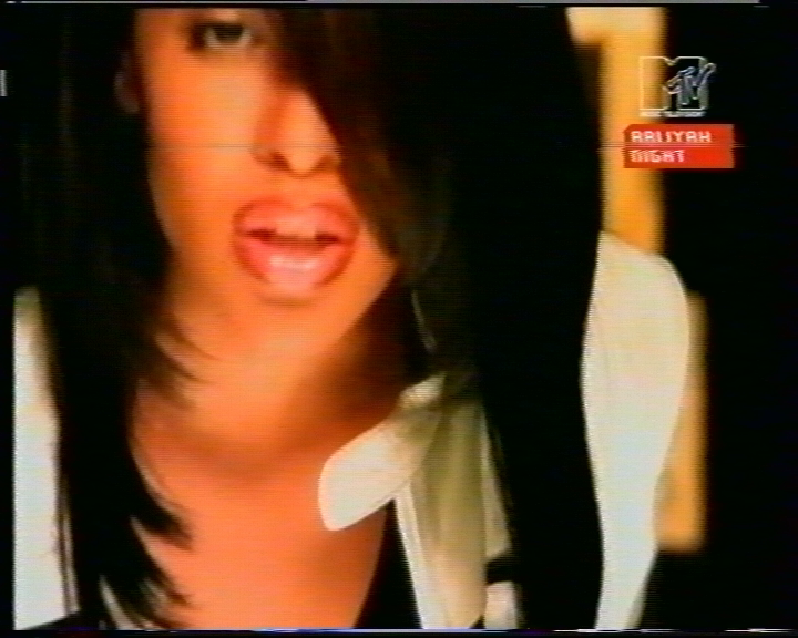

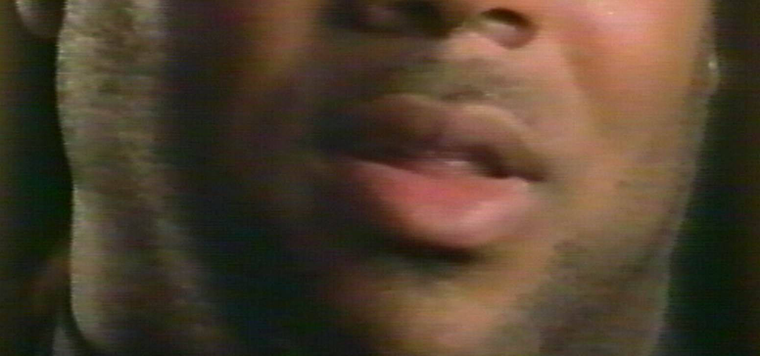

    Can you guys see something on those frames? (all from one same transfer)
    I think I do see a pattern on it, but I need other eyes to confirm lol

  18. Originally Posted by lollo View Post
    Post a sample of the video, please
    Second clip
  19. Capturing Memories dellsam34's Avatar
    Jan 2016
    I don't see any dot crawl in the video for my aging eyes, I see interlacing artifacts because MPC-HC tends to screw with interlaced contents at default setting.
  20. Captures & Restoration lollo's Avatar
    Jul 2018
    Italy

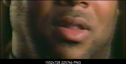

    I do not see a clear checkerboard pattern as well:

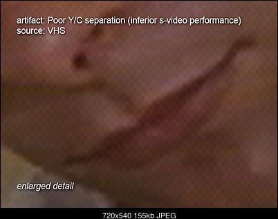

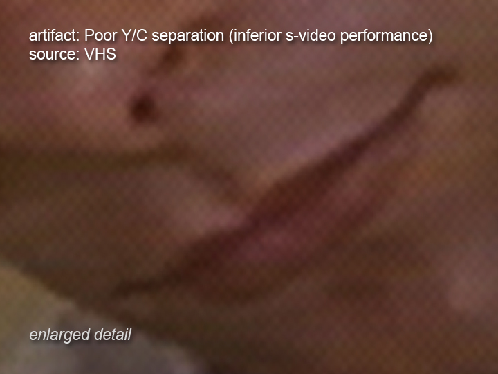

    As reference (https://www.avartifactatlas.com/artifacts/poor_yc_decoding.html):

    I have the lower model JVC and I basically observe the same thing. It's not the S-Video cable's fault, because I have 2 good quality ones.
    If you accidentally connect/configure your cables wrong you possible also can get similar effects/interference.

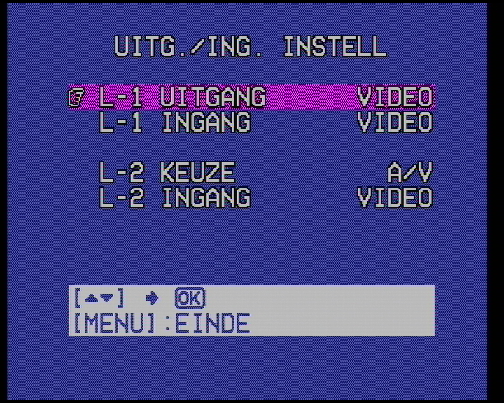

    This can be a potential source of problems with the European JVC models when you are using a SCART to S-Video connection.
    Some models (E.g. HR-S6850) annoyingly don't have a dedicated S-Video connector, so you have to use a SCART/S-Video adapter/cable.
    The older models have a physical switch to set the SCART output to COMPosite or Y/C video and if you set it up incorrect it is of course easy to notice directly.
    HR-S8600 SCART to SVideo Dazzle DVC100 and AV1 SCART switch set to COMPosite:
    [Attachment 79677 - Click to enlarge]

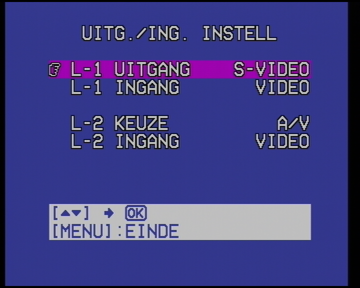

    The newer models do not have a physical switch for the SCART output, so you have to configure the output correctly from the SETUP.
    Internally they are using a different connection method it seems.
    If you set it wrong the resulting effect is not directly so obvious to notice from the setup menu.
    HR-S6850 SCART to SVideo DazzleDVC100 L1/SCART output set to S-Video:
    [Attachment 79645 - Click to enlarge]
    HR-S6850 SCART to SVideo DazzleDVC100 L1/SCART output set to Video:
    [Attachment 79678 - Click to enlarge]

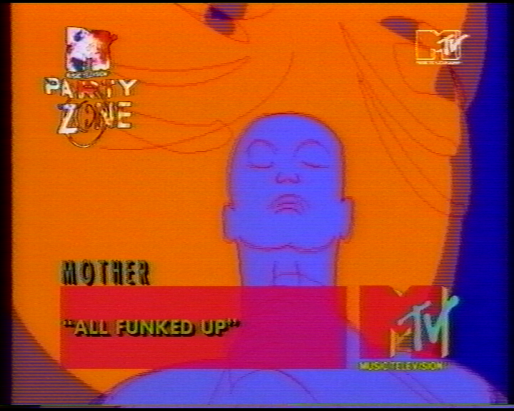

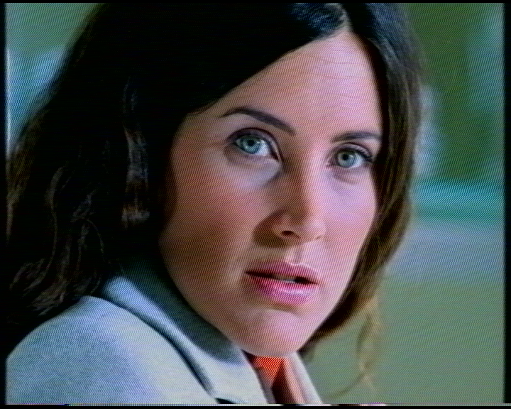

    But if you playing video (regular VHS used here) it sure will be noticeable, specially with strong saturated colors.
    [Attachment 79681 - Click to enlarge]
    [Attachment 79682 - Click to enlarge]
    With a better/less saturated signal, it is already less obvious there is something wrong, specially if you are using a small/low quality monitoring display.
    [Attachment 79683 - Click to enlarge]
    [Attachment 79684 - Click to enlarge]
    I can imagine this potentially causing problems with people using SCART/adapter-cables and/or are less experienced with their video equipment.
