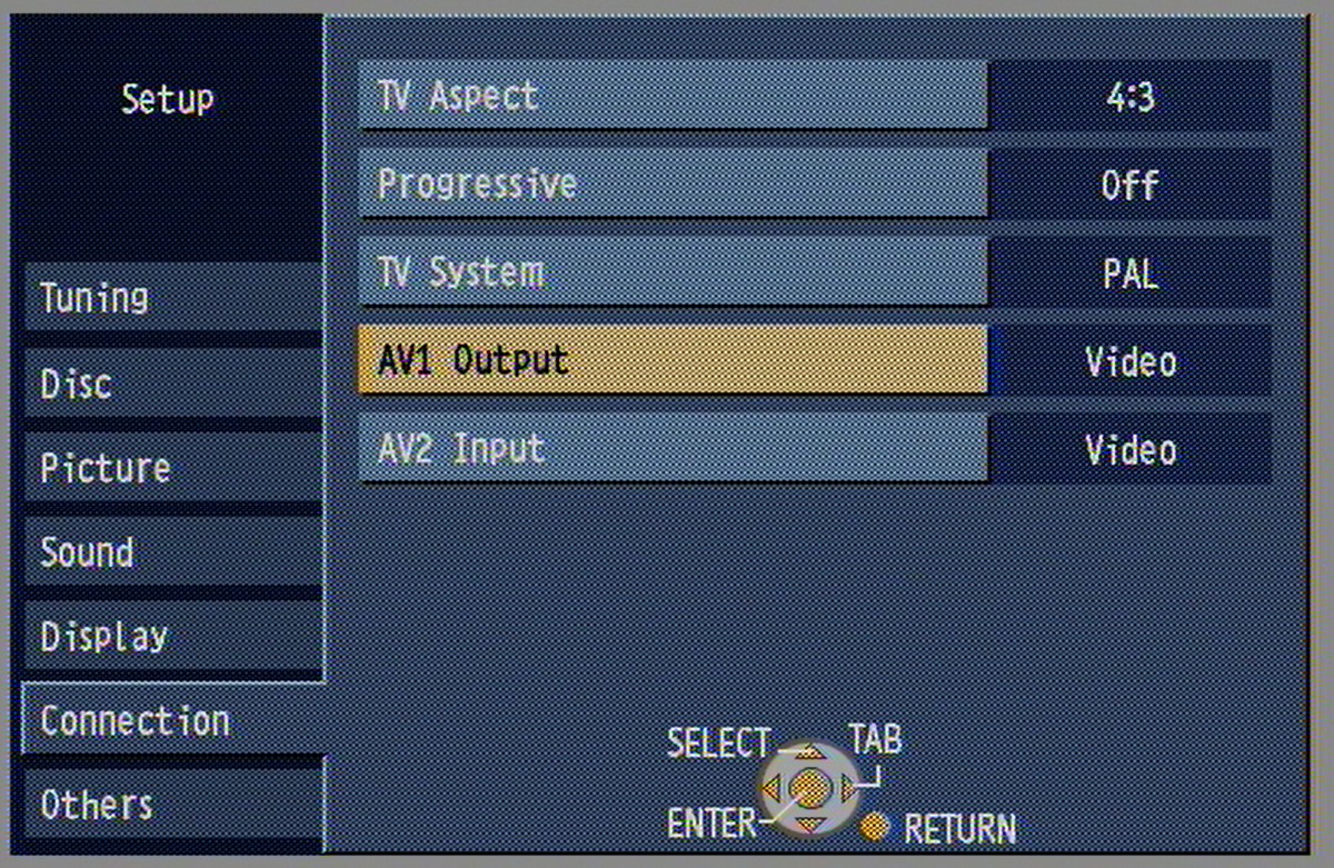

  6. SCART pin 19 is shared for both composite and s-video luma. So you have to tell the DVD recorder which type of signal you want it to output. If you don't tell it you want s-video output it will continue to output composite on that pin and you will get a black and white recording.

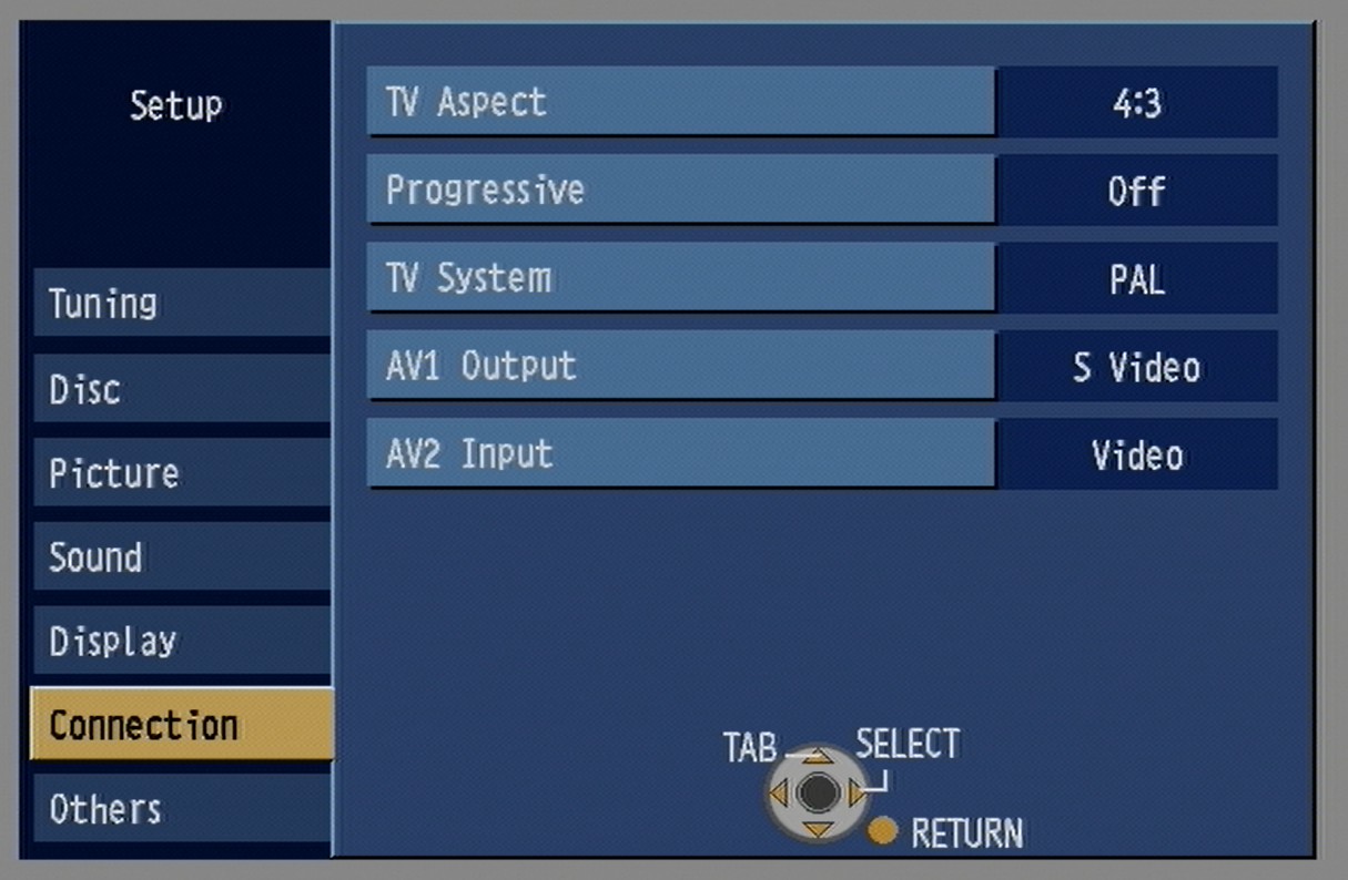

    However, I have a different kind of issue when using the SCART to S-Video & Composite adapter: it introduces a noticeable noise, like small but annoying diagonal white lines.
    Probably an incorrect DVD Output setting for AV1 (as pointed out by Jagabo).
    These are using a Scart connector/adapter on AV1 and S Video cable to the digitiser:
    With output set to "Video (with Component):
    [Attachment 74287 - Click to enlarge]
    With output set to S Video:
    [Attachment 74288 - Click to enlarge]

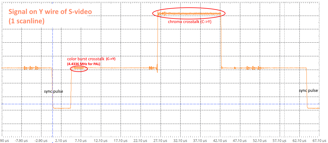

  10. A reminder of caution regarding these SCART adaptors: Internally they are open wired using wire straps of say 1....3" length, and sometimes a PCB and an IN/OUT switch. Due to capacitive coupling between the unshielded wires the Y signal will be contaminated by the color carrier (C, modulated chroma) which is present on the C wire (and vice versa). Means the luma signal is no longer a clean grayscale signal but rather a "muddy" composite signal which represents a low saturated pale "colored" picture.
    Attached oscillogram shows the Y at the output of a SCART adaptor. One can clearly see the residual chroma (C) which is superimposed on the luma due to capacitive coupling (crosstalk) happening within the SCART adaptor. It's like a "weak" composite signal.
    Same (even much worse) happens with low quality poorly screened SCART-to-S-video adaptor cables. It can also be a source of "ghosts" due to the phase shift between the true signals and the crosstalk interference.
