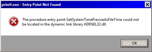

    I tried to bulid a newer version for Windows 7 32-bit with libfdk-aac.
    Using media-autobuild_suite-master.
    It failed with this error:
    [Attachment 86490 - Click to enlarge]

  14. Gentlemen, I have Windows 7 x64 and CPU without AVX and SSE4.
    FFMPEG 7.0.1 compiled in September 2024 by autodidact serves me well and I am grateful for it. But 7.1.1 compiled in March 2025 crashes with the error 0xc000001d. However, AnimMouse recent builds still work fine, but they are static, whereas I prefer shared builds to save some disk space.
    Feb 2004
    @cholla
    I don't think current MSYS2 works on Windows 7 anymore so the m-ab-s build won't work.
    That particular error is for a function in Windows 8+. Maybe an older MSYS2 would still be useable, I don't know.

    @autodidact: I may be wrong, but I think the problem is not in MSYS2 itself, I think the problem is in the GCC executables downloaded and used by MSYS2. I have never liked those executables, so I always downloaded and used the GCC files provided by nevcairiel, OR I myself compiled them by using his modified build scripts.
    Besides, MABS really is not Windows-7 friendly or 100% compatible, I agree, but it's mainly because it depends on the "latest and greatest" PowerShell, which definitely was not designed/optimized for anything below Windows 10.

    I had read the error was for Windows 8 so IDK why it displays in Windows 7.
    I tried a "Fix" I found involving Windows Updates.
    I uninstalled the suggested KB & installed the other suggested KB & installed the older KB afterwards.
    Per instructions of the "Fix".
    This did not work.

    1)]@autodidact: I may be wrong, but I think the problem is not in MSYS2 itself, I think the problem is in the GCC executables downloaded and used by MSYS2. I have never liked those executables, so I always downloaded and used the GCC files provided by nevcairiel, OR I myself compiled them by using his modified build scripts.
    I have read that mintty is the source of the "entry point GetSystemTimePreciseAsFileTime not found" error and I'm sure you are right about the PowerShell and GCC issues with MABS/MSYS2. I have made use of the nevcairel scripts as well. I guess the options are few for the Windows 7 user without much compiling experience.
