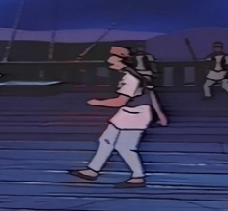

    I went ahead and ran the entire video with your line, and it looked really good. I couldn't see any ghosting (with my amateur eyes) but funny enough, I did see some ghosting with the ASTDR solution in another scene:
    [Attachment 79286 - Click to enlarge]
    Setting ASTDR's edgemask to true (vs the false default) does get rid of some of it, but there was still this tiny bit left. I do like your solution a lot more though since it doesn't seem to introduce any new problems. Thank you again!
