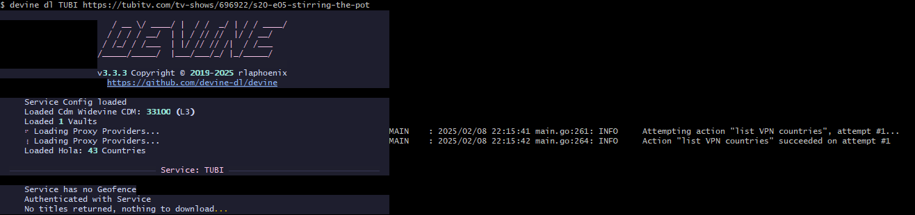

  2. Originally Posted by stabbedbybrick View Post
    Originally Posted by SummerArk View Post
    A couple of days ago, on TUBI, I downloaded and my downloads worked fine. Today I am trying, and anything that I download fails with the error below. I downloaded "passengers" a couple of days ago and it worked fine. Right now, I retry to download it from TUBI and the download fails:
    HTTPError: 403 Client Error: Forbidden for url:
    https://tubitv.com/oz/videos/100032304/content?video_resources=hlsv6_widevine_no
    nclearlead&video_resources=hlsv6
    Any ideas?
    Looks like Tubi's made some changes to their API. I'll look into it.
    TUBI has been updated. Authorization with cookies no-longer required and slightly better bitrate than before (still 720p, though). Geofence has been removed, so as long as you connect from the region where the title is available it should work. If not, the error will tell you what region(s) the title is available in. And due to requests downloader not giving any output, and n_m3u8dl_re can't handle the DASH for some reason, Aria2c has been set as downloader in the service itself.
    The update caused the search to break, though. I might look at that some other time, but at least the important stuff works for now.

    git -C "W:\APPLICATIONS_DESKTOP\git_stabbedbybrick_devine-services" pull --ff-only; git -C "W:\APPLICATIONS_DESKTOP\git_stabbedbybrick_devine-services" fetch --force origin 'refs/tags/*:refs/tags/*'
    remote: Enumerating objects: 11, done.
    remote: Counting objects: 100% (11/11), done.
    remote: Compressing objects: 100% (6/6), done.
    remote: Total 6 (delta 3), reused 0 (delta 0), pack-reused 0
    Unpacking objects: 100% (6/6), 1.82 KiB | 45.00 KiB/s, done.
    From https://cdm-project.com/stabbedbybrick/devine-services
       b65c6b7..b4d7f7a  main       -> origin/main
    Updating b65c6b7..b4d7f7a
    Fast-forward
     services/TUBI/__init__.py | 169 +++++++++++++++++++++++++++-------------------
     services/TUBI/config.yaml |   4 +-
     2 files changed, 100 insertions(+), 73 deletions(-)
    devine env clear cache TUBI
    devine dl TUBI https://tubitv.com/movies/100032304/passengers
    Excellent! Thanks, stabbedybrick. TUBI downloads work again.

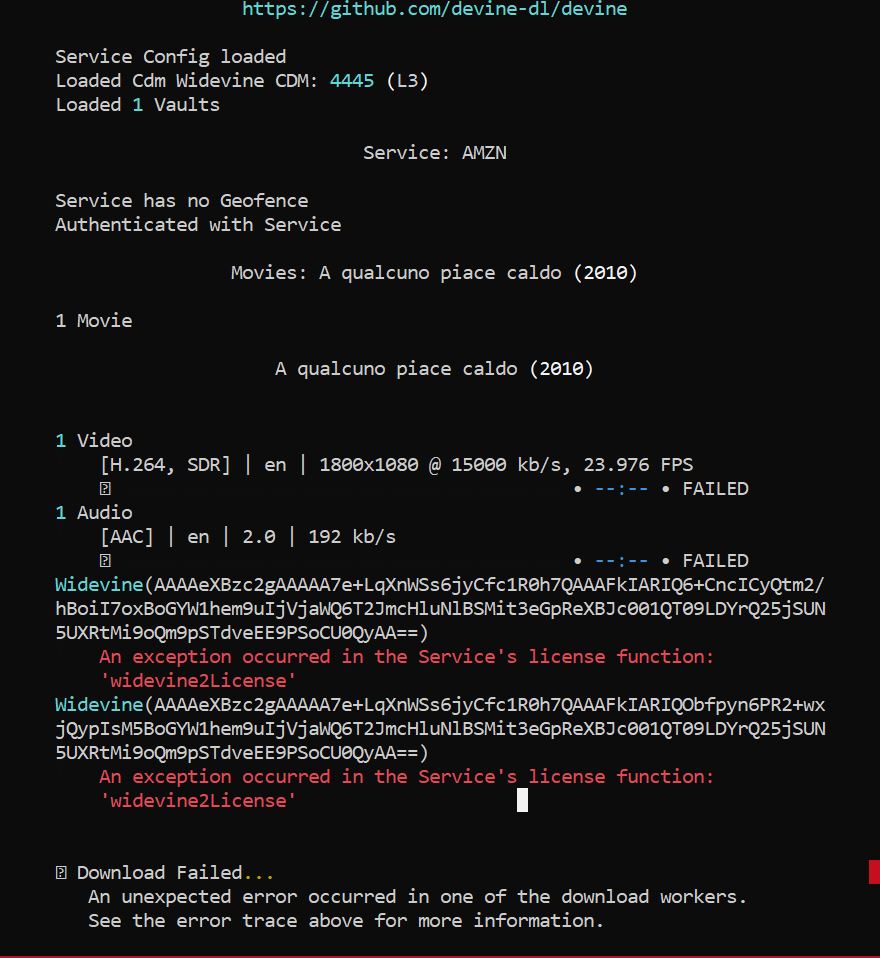

  9. │ _ ___ ____ __ │
    │ | | / (_)__ ___ / __/__ ___ ___/ /__ ____ │
    │ | |/ / / _ \/ -_) _// -_) -_) _ / -_) __/ │
    │ |___/_/_//_/\__/__/ \__/\__/\_,_/\__/_/ │
    │ A front-end for Devine │
    │ Copyright © 2024 A_n_g_e_l_a │
    https://github.com/vinefeeder
    │ python vinefeeder.py --help for options │
    [info] Loaded service: ALL4
    Searching for four-in-a-bed
    ╭──────────── info ────────────╮
    │ Data for Four In A Bed │
    │ Series are non-contiguous: │
    │ 2 3 4 5 6 8 9 │
    │ 10 11 12 13 14 15 16 │
    │ 17 18 19 20 │
    Series to download? 2
    / __ \/ ____/ | / / _/ | / / ____/
    / / / / __/ | | / // // |/ / __/
    / /_/ / /___ | |/ // // /| / /___
    /_____/_____/ |___/___/_/ |_/_____/
    v3.3.3 Copyright © 2019-2025 rlaphoenix
    https://github.com/devine-dl/devine
    Service Config loaded
    Loaded Cdm Widevine CDM: 22589 (L3)
    Loaded 0 Vaults
    ────────────────────────────── Service: ALL4 ───────────────────────────────
    Service is not Geoblocked in your region
    + Using cached Tokens...
    Authenticated with Service
    ────────────────────────── Series: Four in a Bed ───────────────────────────
    1 Season, 1 Episode
    ────── Four in a Bed S02E01 Mon 30 May 2011: Robertsbrook Guesthouse ───────
    Cached 1 Key to 0/0 Vaults
    [Widevine]: ERROR: Unknown command line flag
    'enable_raw_key_decryption' ERROR: Unknown command line
    flag 'keys'. Did you mean: v ? ERROR: Unknown command line
    flag 'temp_dir'
    1 Video
    └── [H.264, SDR] | en | 1920x1080 @ 2986 kb/s, 25.000 FPS
    ⠏ ━━━━━━━━━━━━━━━━━━━━━━━━━━━━━━━━━━━━━━━━ • --:-- • Decrypting
    1 Audio
    └── [AAC] | en | 2.0 | 130 kb/s
    ⠏ ━━━━━━━━━━━━━━━━━━━━━━━━━━━━━━━━━━━━━━━━ • --:-- • FAILED
    1 Subtitle
    └── [VTT] | en
    ⠏ ━━━━━━━━━━━━━━━━━━━━━━━━━━━━━━━━━━━━━━━━ • --:-- • SKIPPED
    3 Chapters
    ├── 00:00:00.000 | Chapter 01
    ├── 00:09:35.000 | Chapter 02
    └── 00:23:05.880 | Credits
    Widevine(AAAANHBzc2gAAAAA7e+LqXnWSs6jyCfc1R0h7QAAA BQIARIQAAAAAAAAAAAAA
    AAAAzYoVQ==)
    ├── 00000000000000000000000003362855:d127d5c9228264bd0 e24e4bc2d4c4945*
    └── An exception occurred in the Service's license function: License
    request failed: The token has already expired (te value)
    ╭───────────────────── Traceback (most recent call last) ──────────────────────╮

  14. Hi can someone help me i'm going crazy,Image
    [Attachment 85372 - Click to enlarge]
    i get these errors
    "An exception occurred in the Service's license function:
    'widevine2License'
    ❌ Download Failed...
    An unexpected error occurred in one of the download workers.
    See the error trace above for more information. "
    my config.yaml is adapted for prime italy.
    thanks for all the suggestions
    Dec 2021
    england
    you use Andriod l3 cdm, can not getting 1080p, only upto 540p
  16. Unforgotten? Series 6 - STV beats ITV slightly with video-bitrate except episode 2 for some reason..
  17. Many thanks, iamghost. I set the video with -q 540, and now there are no errors in the video, only in the audio. What are the settings for audio with L3 CDM?"

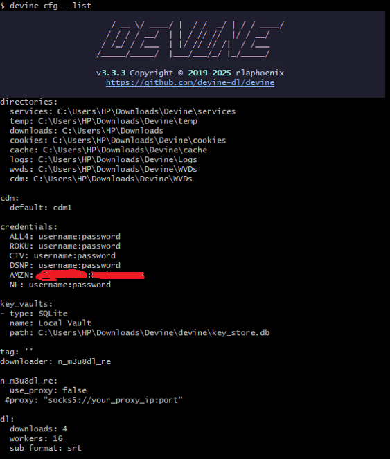

    I'm replying here because I can't see how to start a new thread!
    I'm trying to change the downloads directory in devine, but having no luck. Here is my devine.yaml
    directories:
    services: C:\devine-services\services
    credentials:
    ALL4: <all4user>:<all4pw>
    cdm:
    default: <cdm>
    downloader: aria2c
    n_m3u8dl_re:
    use_proxy: false
    dl:
    workers: 16
    sub_format: srt
    downloads: D:\Downloads
    temp: D:\Temp\devine
    but "devine env info" shows this, and downloads continue to go into the C: drive

    Any ideas?
  19. try with:
    directories:
      downloads: D:/devine/downloads
      temp: D:/devine/temp
    and create the folders before running devine again :fingers_crossed:
    Jan 2025
    England
    Thanks PunchDrunkL0ve!
    I've already got a "directories:" entry for "services", so I added "downloads" and "temp" under that and it worked! I'd already made sure that the directories were created, but on its own that made no difference. I've also looked at the temp directory, and can see the aria2 segments and how it can restart from cancellation or a temporary error.
    I now feel a bit stupid for not noticing the directories entry...
