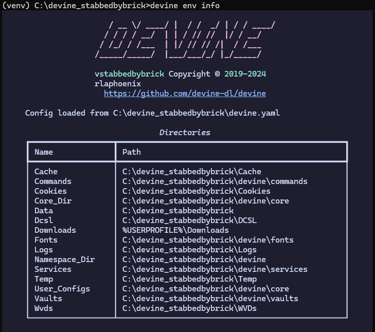

    Mar 2024
    Originally Posted by sipho View Post
    Originally Posted by stabbedbybrick View Post
    All right, for those that've been asking for it, I've added an experimental N_m3u8DL-RE branch to my Devine fork here:
    https://github.com/stabbedbybrick/devine/tree/n_m3u8dl_re
    Confirm we have to create a separate env for this?
    That is how I've gone about it. Force changed the code to use local directories to the venv - probably a far better way, but it'll do for now
    [Attachment 82444 - Click to enlarge]
    Final update for a while: @stabbedbybrick this seems superb as expected! Will keep testing and feedback!
  30. Originally Posted by PunchDrunkL0ve View Post
    Using the latest MY5 service and N_m3u8DL-RE branch in a venv but getting constant connection drop-outs as soon as it's done with the video and moves on to grab the audio. Tested with aria2c and still getting the same error. Easy to do only the audio with -A and mux manually afterwards but wondered if anyone else has seen the same behaviour? Many thanks.
    ❌ Download Failed...
    ('Connection aborted.', RemoteDisconnected('Remote end closed
    connection without response'))
    An unexpected error occurred in one of the download workers.
    See the error trace above for more information.
    Edit: Everything has returned to normal - prob just a glitch with the MY5 servers -phew!
    Hmm I spoke too soon. The issue described above is back
    Seems to be related to anything on MY5 labeled as S00E00, like this one https://www.channel5.com/show/the-abduction-of-milly-dowler
    Could someone with access to MY5 please try using the link above? Many thanks.
