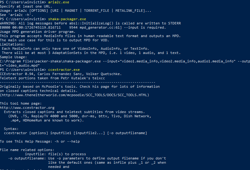

    im getting the same error on windows.
    I tired different downloaders(default and aria2c) and different paths to temp/cache etc.. but no luck. tired different VPNs and different vpn endpoints but still the same. The logs files dont seem to shed any light on whats going on.
    I confirmed all the prerequisites are installed and path are valid as i can auto complete and run the commands in powershell. I renamed all shaka-packager and ccextractor from the repo names to just shaka-packager.exe and ccextractor.exe
    [Attachment 82322 - Click to enlarge]
    my config

    Error i am seein. I dont understand why i am getting error "WindowsPath('C:/Users/WINVIC~1/AppData/Local/Temp/devine')]' returned non-zero
    exit status 1."
    HTML Code:
    C:\Users\winvictim\AppData\Local\Programs\Python\Python311\Lib\site-packages │
    │ \devine\core\drm\widevine.py:291 in decrypt                                  │
    │   288 │   │   │   p.wait()                                                   │
    │   289 │   │   │                                                              │
    │   290 │   │   │   if p.returncode != 0 or had_error:                         │
    │ > 291 │   │   │   │   raise subprocess.CalledProcessError(p.returncode, argu │
    │   292 │   │   │                                                              │
    │   293 │   │   │   path.unlink()                                              │
    │   294 │   │   │   if not stream_skipped:                                     │
    CalledProcessError: Command
    '['input=C:\\Users\\WINVIC~1\\AppData\\Local\\Temp\\devine\\Audio_18c4dafb.mp4,s
    tream=0,output=C:\\Users\\WINVIC~1\\AppData\\Local\\Temp\\devine\\Audio_18c4dafb
    _decrypted.mp4,output_format=MP4', '--enable_raw_key_decryption', '--keys',
    'label=0:key_id=fd3f12e5ce87b118e02111141c6cf48f:key=4f398a28d85a3b1f2543843bb54
    5e119,label=1:key_id=84b9d4747155f216cc022107ea9cee2a:key=1c23f8d407882245e0dcb6
    cd984eafb3,label=2:key_id=727f6690e69d915c22208caba3c7b089:key=d0d662127a60b09e6
    b13b8f16bafa360,label=3:key_id=00000000000000000000000000000000:key=4f398a28d85a
    3b1f2543843bb545e119,label=4:key_id=00000000000000000000000000000000:key=1c23f8d
    407882245e0dcb6cd984eafb3,label=5:key_id=00000000000000000000000000000000:key=d0
    d662127a60b09e6b13b8f16bafa360', '--temp_dir',
    exit status 1.
         ❌ Download Failed...
            An unexpected error occurred in one of the download workers.
            Binary call failed, Process exit code: 1
            See the error trace above for more information.

  6. @grimeire:
    If you read the output from calling shaka-packager, it clearly says that you've downloaded mpd_generator and not packager.
    PSA: I've updated the MY5 service to no longer make use of any hmac keys. Nothing should change for the end user, but it means I don't have to maintain anything in the background. It just seems silly to use old methods when it's not needed. Just pull the update and you should be ready to roll.
    And since I know there are other projects here who're using my github for the hmac, I'll leave it up until the current keys are dead so you have a chance to update your code before it breaks. Feel free to use my code if you want.

    Just seen the first windows release in the list and downloaded that. you need to expand it to get the actual windows release.
    For anyone else having the issue make sure you download packager-win-x64.exe. I renamed it to shaka-packager.exe but not sure if thats needed. You have to add the path too.
  8. Originally Posted by grimeire View Post
    im an idiot.
    Thank you for your answer and all your work with the services.
    If it makes you feel better I did exactly that not long ago
