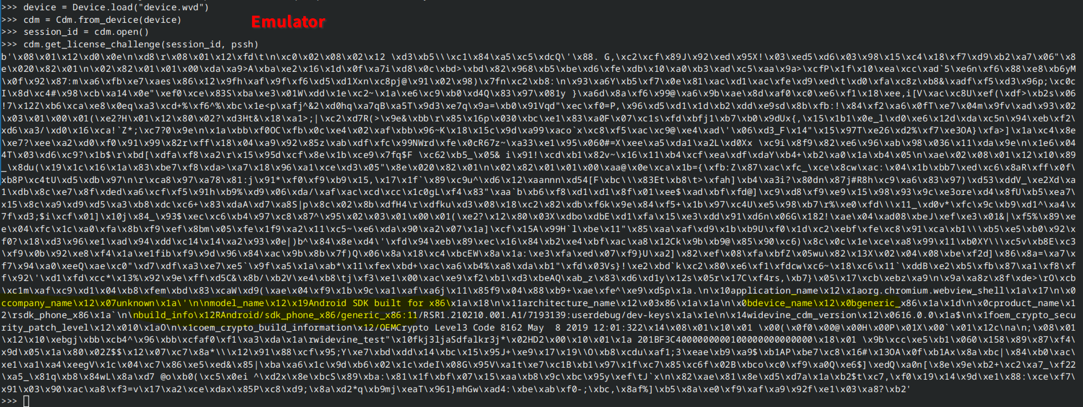

    Android Studio is an emulator

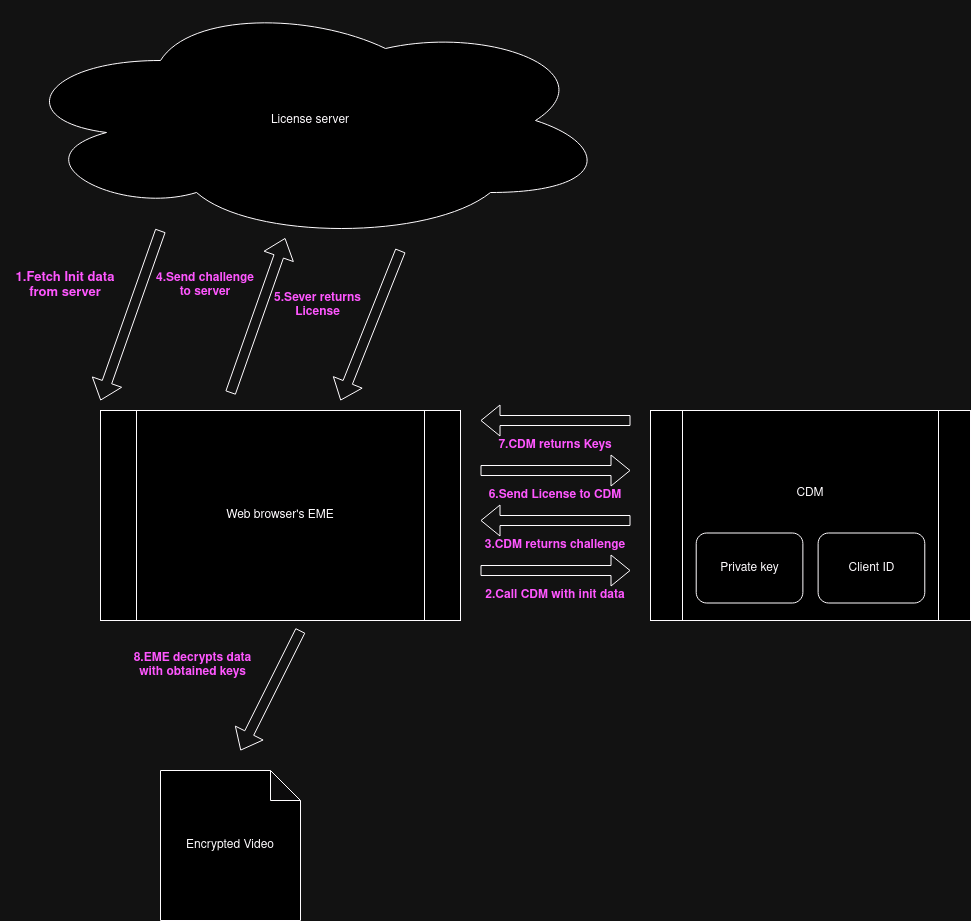

  9. @jack_666
    Thanks for reporting this bug.
    I fixed this in 8a12fb6.
    I will explain why this error occurred.
    First of all, inject.js retrieves Init data by overriding functions defined inside the browser.
    The mechanism for obtaining Init data is the same as that performed by the EME Logger.
    Next, the getPssh() function in inject.js converts init data to PSSH.
    Often, Init data and PSSH are identical, but when Init data is long (so-called Long PSSH), only the necessary part needs to be parsed so that Pywidevine can parse it.
    This means that the getPssh() function automates the method described on this site to detect only Widevine's PSSH and extract only the parts necessary for Pywidevine to parse.
    https://lxlit.dev/posts/cdm-tools/obtaining-pssh/
    As I said at the beginning, inject.js works by overriding the behavior of functions originally defined in the browser.
    The original-function then needs to pass the Init data it gets to another internally defined function in order to perform EME processing.
    Therefore, the original "MediaKeySession.prototype.generateRequest()" function must be backed up in the "originalGenerateRequest" variable, and the overridden-function must call it and return the original value.
    However, on the site you provided, the getPssh() function was causing an error because it was not Widevine's, although it was using EME's function.
    Therefore, the bug was caused by the fact that the return was not performed on the data needed to be processed by another function within the overridden-function.
    This fix ignores the getPssh() function error in the overridden-function, so that when a non-Widevine EME is used, it will correctly return the result of the original-function.

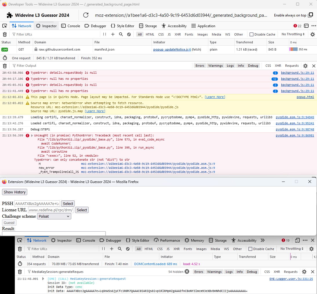

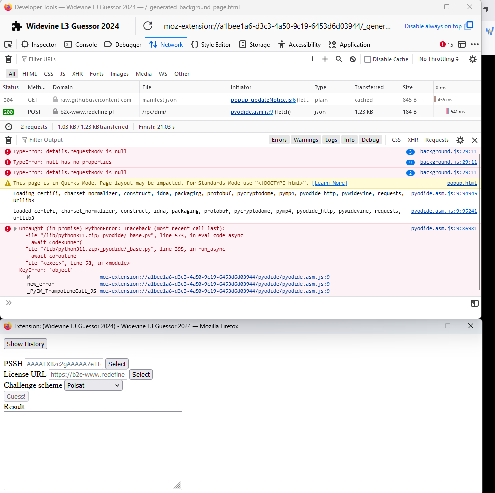

    I also have a problem with Polsat on Win11 platform in latest version of FF.
    I'm loading the plug-in as advised:
    1. Navigate to "about:debugging#/runtime/this-firefox"
    2. Load temporary add-on (240507.1|8a12fb6)
    3. Select ""manifest.json" -> Open
    Then I select "Inspect" and another Windows opens up.
    I would log-in to PolSatBoxGo and play a movie.
    If I have "uBlock Origin" enabled, I get a message:
    Widevine content hasn't detected in this page.
    Open widevine-protected website and try again!
    When I disable it "uBlock Origin", WV is still not detected on the page.
    Only when I enable ABP, the plug-in finds WV on the page.
    Selecting Polsat and pressing "Guess" results with the following error
    in the console:
    [Attachment 78899 - Click to enlarge]
    Sorry, missed post #300 :(

  11. @pssh
    Hmm..., Thank you for providing a log that contains properly useful information.
    I'll do some research later.
    Also, I have created a Polsat.py that includes debugging symbols, so if you have time, could you try this script as well and provide logs?
    EDIT:
    If you get a message that Widevine was not detected, it means that Widevine's PSSH could not be obtained and is most likely another problem than the one described above.
    Please check the console on the Video window for logs beginning with "[PSSH]".
    If not, the extension is not getting Widevine's PSSH correctly.
    In this case, please make sure that the EME protocol is indeed Widevine and not Playready, etc.
    It is also possible that there is simply a lag in the transfer of information from the content script to the popup, so when this problem occurs, closing the popup and reopening may has possibility of display the information correctly.

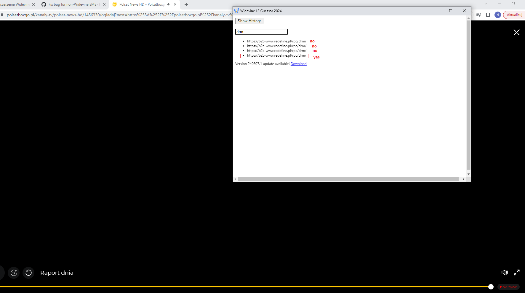

  12. Originally Posted by pssh View Post
    I have re-read #1 post.
    #301 also reports PolSat not working.
    License url select drm but the last line
    [Attachment 78902 - Click to enlarge]
    it works for me
    [Attachment 78903 - Click to enlarge]

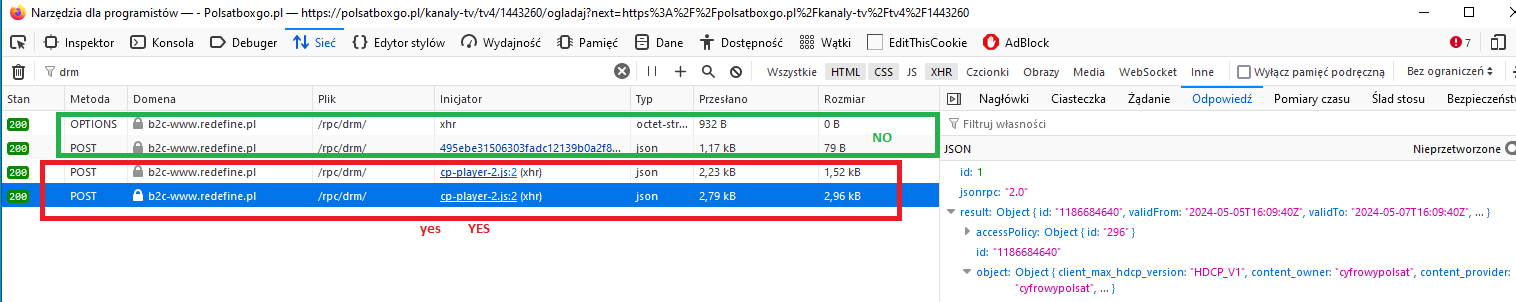

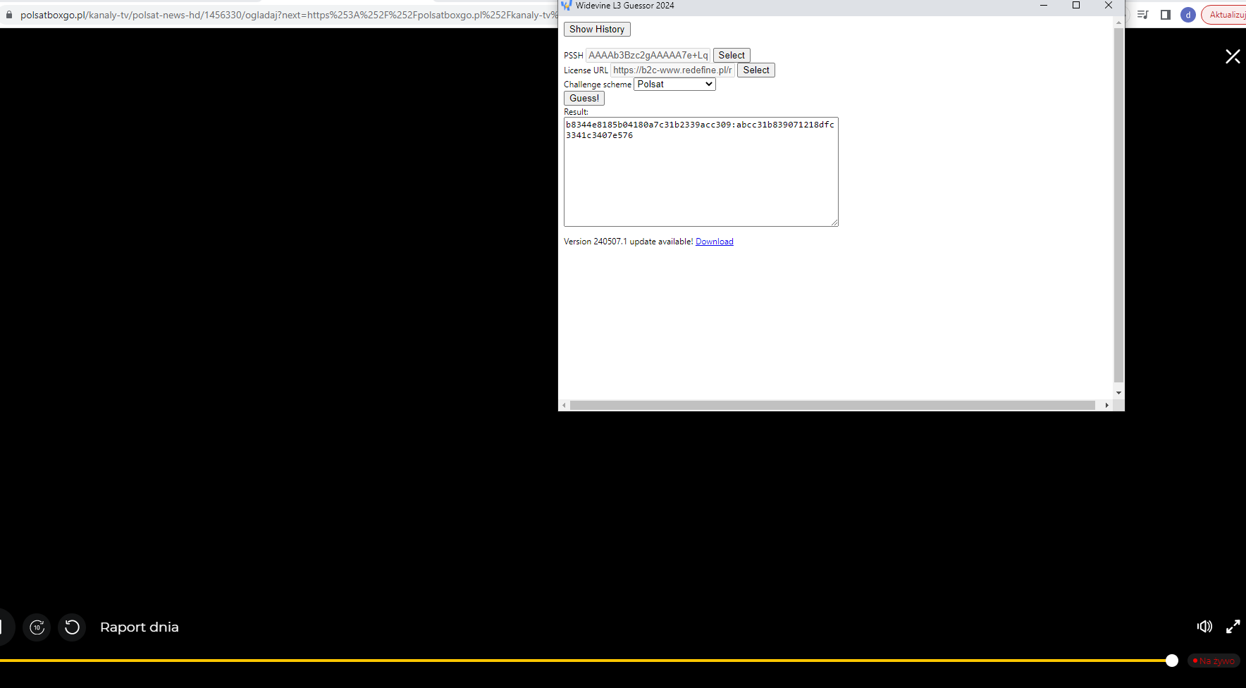

  13. I also had a problem with Polsat, but it turned out that the moment at which you run the plug-in is important
    you need to do this when the movie starts (dots are flashing) and then it shows the correct window
    the second thing is the appropriate URL license, you need to expand the tab and select the first one from the bottom:
    https://b2c-www.redefine.pl/rpc/drm/
    and then just guess! and wait a while

  22. Originally Posted by pik View Post

    Can you please confirm you have the latest version #240507.1 | #8a12fb6?
    Just tried,
    1. Reload +
    2. "Play the movie from the start" open up the plug-ing and select Polsat/GUESS and nothing,
    same error ...
    21:41:21.975 Loading certifi, charset_normalizer, construct, idna, packaging, protobuf, pycryptodome, pymp4, pyodide_http, pywidevine, requests, urllib3 pyodide.asm.js:9:94945
    21:41:24.306 Loaded certifi, charset_normalizer, construct, idna, packaging, protobuf, pycryptodome, pymp4, pyodide_http, pywidevine, requests, urllib3 pyodide.asm.js:9:95241
    21:41:29.927
    Uncaught (in promise) PythonError: Traceback (most recent call last):
      File "/lib/python311.zip/_pyodide/_base.py", line 573, in eval_code_async
        await CodeRunner(
      File "/lib/python311.zip/_pyodide/_base.py", line 395, in run_async
        await coroutine
      File "<exec>", line 58, in <module>
    KeyError: 'object'
        M moz-extension://a1bee1a6-d3c3-4a50-9c19-6453d6d03944/pyodide/pyodide.asm.js:9
        new_error moz-extension://a1bee1a6-d3c3-4a50-9c19-6453d6d03944/pyodide/pyodide.asm.js:9
        _PyEM_TrampolineCall_JS moz-extension://a1bee1a6-d3c3-4a50-9c19-6453d6d03944/pyodide/pyodide.asm.js:9
    p

    Originally Posted by FoxRefire View Post
    @jack_666

    Just tried to select the "License Server" /drm/ manually "last one - only 4 are showing"
    (With the latest version of the plug-in)
    and no luck .....
    Also tried to Reload + Start the movie again and quickly select
    plug-in and Guess and no luck .....
    And also tried Reload + Start the movie again and quickly select
    plug-in and the DRM license server and "only 2 are showing - selected the second one"
    and press Guess and no luck either ....
    Is there any way you could "please" check which version do you have?
    #EDIT
    I replied too hastily.
    Indeed,
    selecting 3rd or 4th /DRM/ License URL spills out the kid:key without any error in the console ......
    Thank you

  25. Originally Posted by pssh View Post
    Just tried,
    1. Reload +
    same error ...
    21:41:29.927
        await CodeRunner(
        await coroutine
    KeyError: 'object'
    p
    Yes, I have the latest plugin, I installed it today #240507.1
    it is important to choose the right license address
    and you have to wait up to about 30 seconds

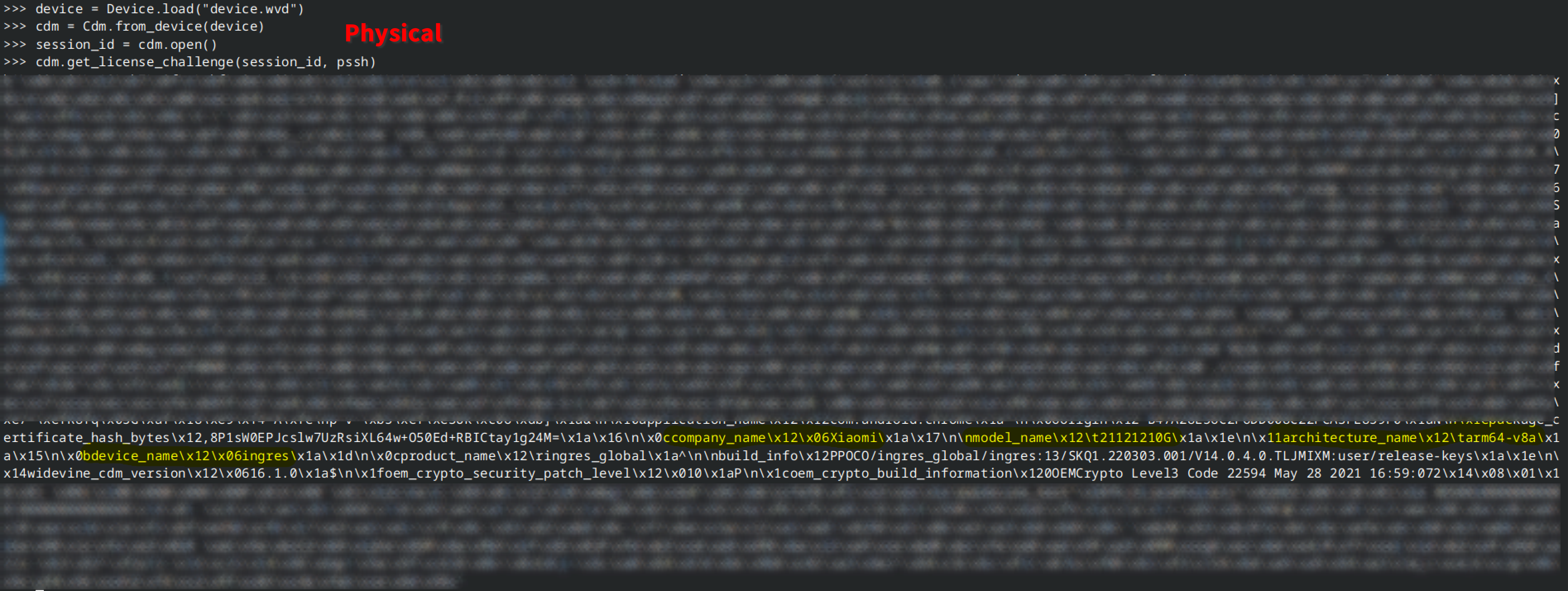

  28. First, this is the process EME goes through when it obtains the content key.
    This diagram has been simplified to make it easier for the noobs to understand and contains a few errors and misrepresentations.
    [Attachment 78910 - Click to enlarge]
    The point to focus on here is step 3.
    In this step, CDM generates a challenge based on its own client information.
    This client information includes unique identifiers and device hardware information.
    The EME sends a challenge generated from these informations to the server, so that the server can block CDMs that indicate that it is an emulator, or Big Brother can revoke a particular CDM.
    This can be confirmed by actually checking the challenge generated by Pywidevine.
    [Attachment 78911 - Click to enlarge]
    [Attachment 78912 - Click to enlarge]
    As a way of mentioned above, some license servers like A****n block CDM for emulators.
    Most people here are so ignorant about Widevine's DRM technology that I'm planning to create an online course that will explain it in detail.
    And my course also should be protected with Widevine as well as don't want it copied :P
    Obtaining that key is the final practical assignment of the course.
    Don't be stupid.Use your brain and Google.
    Read the rules and documentation before asking for support about my extension.
    waw super easy understand
    ps: is was for me i think
    anyway big big respeckt and thanks for this nice perfeckt lesson
