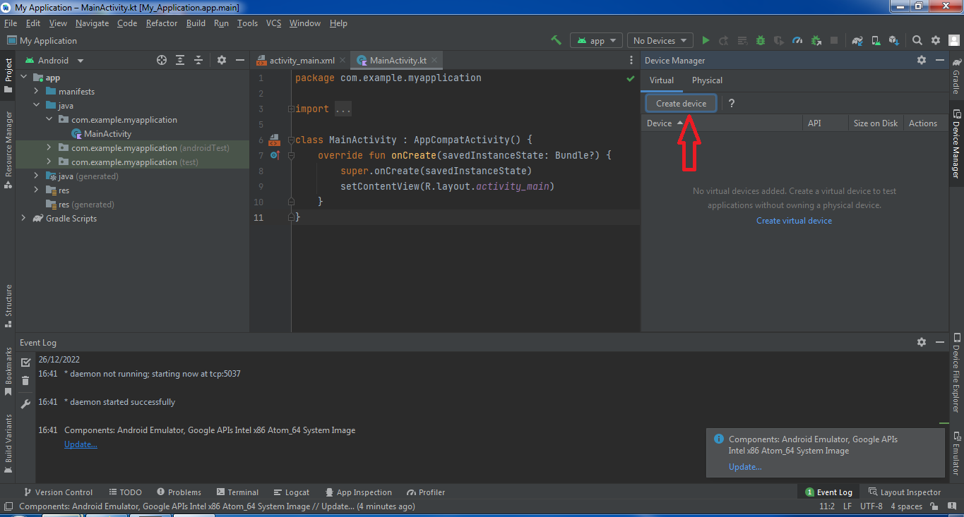

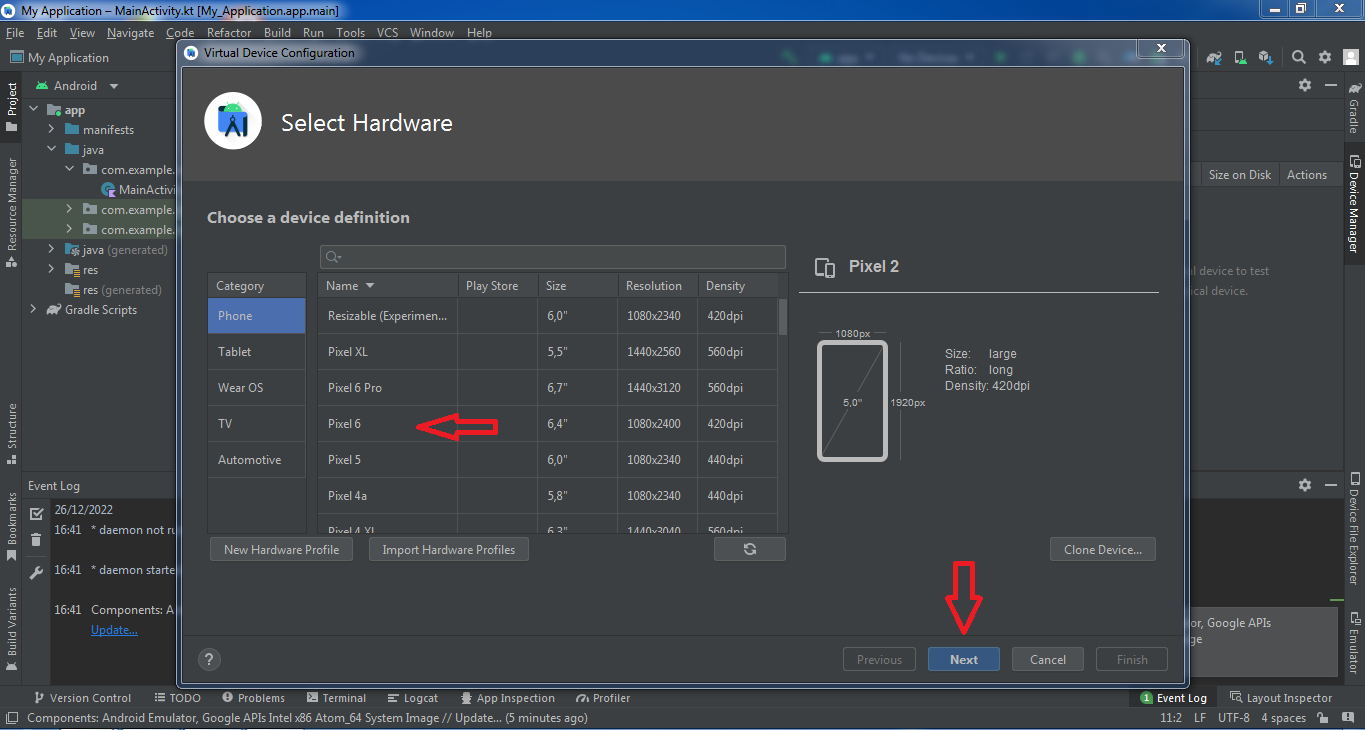

    We Want to create a Virtual Android Device ....So click on "Create Device"
    I have not tested with all Android Devices but the first three work fine
    [Attachment 68345 - Click to enlarge]
    Choose for example "Pixel 6" and click on "next"

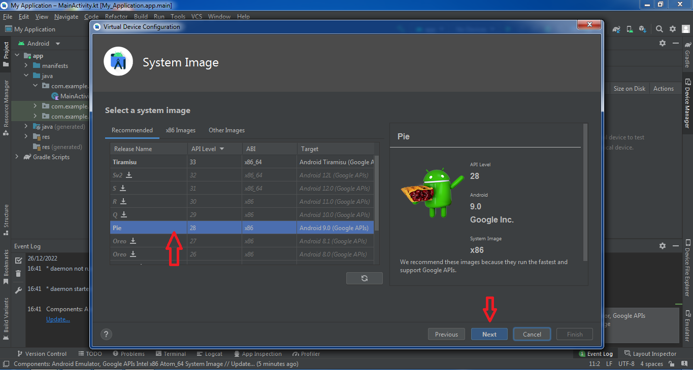

    Here again I have not test all the Version of the OS but Android Pie works fine.
    Download the Android Version you want for your virtual device, choose it and click on "next"

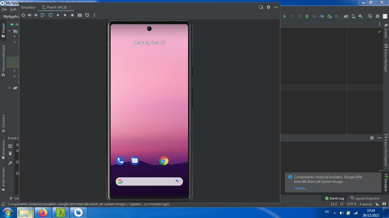

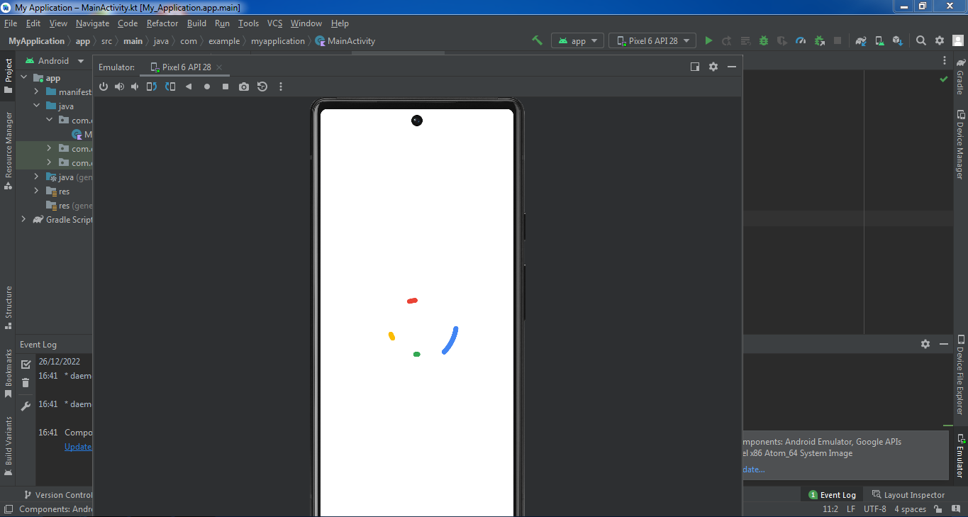

    Your phone is going to be created...It make takes a long time to be created and to boot...
    [Attachment 68349 - Click to enlarge]
    Your beautilful and free Phone is ready !

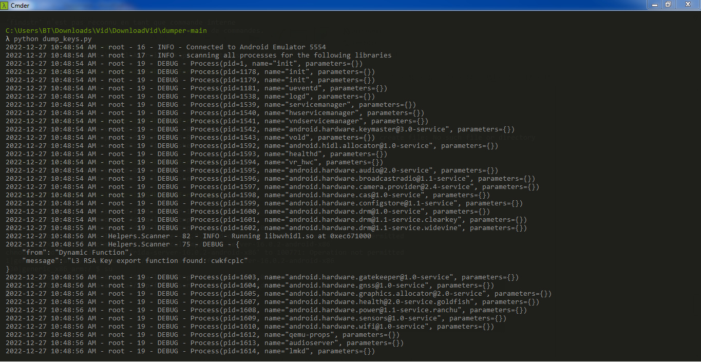

    As we can see, the video on Bitmovin is launch and dumper-main do his job.
    Let's have a look in dumper-main directory.
    You will find a directory (private-keys) containing the 2 files

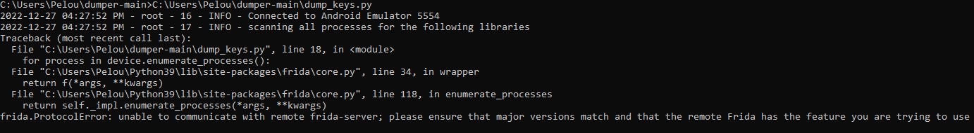

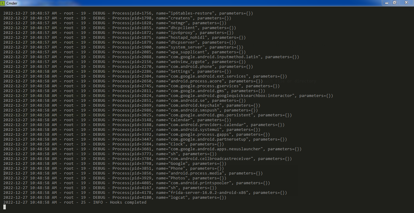

  8. Hello
    First of all, thank you for this tutorial.
    I just tried it but I have a problem at the dumper step (see picture). Any idea how to solve this problem?
  9. Hello Pouki2,
    you have Frida 15.2.2....Have you downloaded the same version on Github...
    Try to update frida-tools also
    pip install --upgrade frida-tools
  10. Thank for your answer.
    Yes, it was a problem of version, I had just followed the tuto without taking care of that like the noob that I am ^^
    It worked now.
  11. I had not specified the taking into account of the different versions...
    Thank you Pouki2

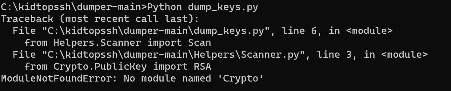

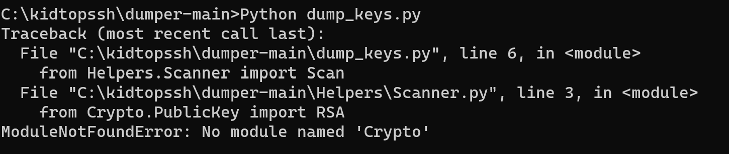

  19. Hey Cedric8528,
    Many thanks for the guide. But seem to be running into problems with the dumper step. I think I have verified my version of Frida server is the same as the one I downloaded via pip install. Any idea how to solve this?
    C:\kidtopssh\dumper-main>Python dump_keys.py
      File "C:\kidtopssh\dumper-main\dump_keys.py", line 6, in <module>
        from Helpers.Scanner import Scan
      File "C:\kidtopssh\dumper-main\Helpers\Scanner.py", line 3, in <module>
        from Crypto.PublicKey import RSA
    ModuleNotFoundError: No module named 'Crypto'

  20. Hello
    pip install pycryptodome

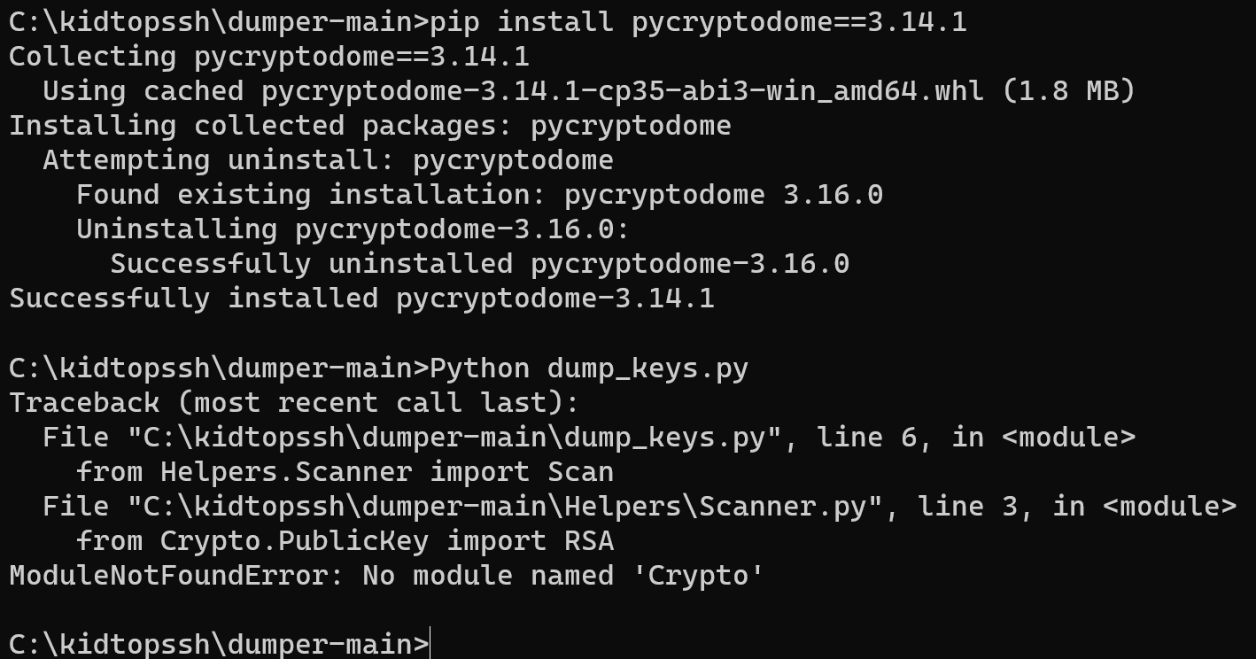

  22. Code:
    pip install pycryptodome==3.14.1
  23. or maybe this
    pip install pycryptodomex

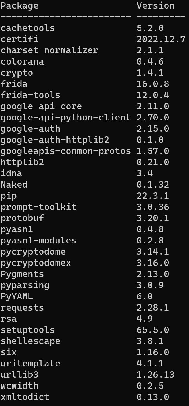

  24. Originally Posted by cedric8528 View Post
    Unfortunately the same outcome:

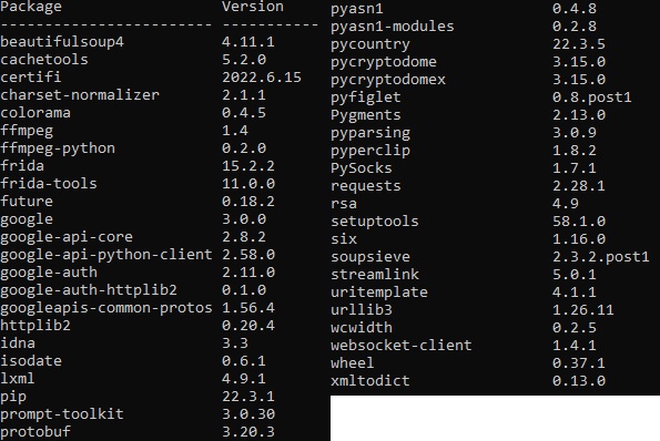

  26. Not sure if this will help but here is my pip list:

    I'm using Python 3.10.7 with the following modules, the script works with them without any problems.
    pycryptodome       3.15.0
    pycryptodomex      3.15.0
    If the problem persists, uninstall with the help of the installation file of the same version the python from your computer and install it again
    Would you recommend downgrading my python like mrmyst suggested?
  30. Yes I don't know where is the problem ....So as mrmyst
    says , downgrade your version of Python.
