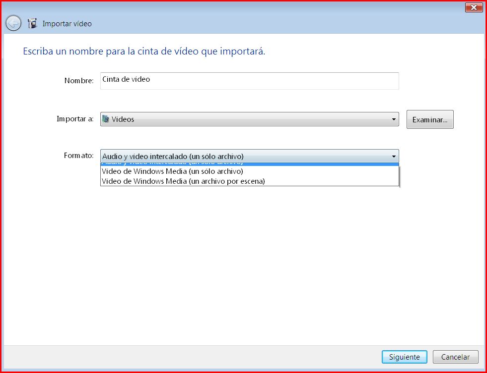

    Now that the camera can interface with the computer, the question becomes: Which program is best? To my knowledge, there are three options:
    1. WinDV seems like the most straight forward option, no idea how the quality compares to other programs.
    2. SCLive looks well featured, no idea how different it is from WinDV. Needs a key?
    3. Windows Vista's Built-In Tape Video Recorder?!?!?! This is apparently a thing, image attached further below.
    My goal is mainly to get the best quality possible. These are precious memories for me and my family, and I am willing to go to great lengths to ensure that they are preserved digitally as well as possible. Storage space is very cheap nowadays, and I'm not afraid to use it.
    It would also be nice if the program can be left to run on its own while I work or do whatever else. I might still choose to do some light or looseless compression after the fact.
    Here is the Windows thing I mentioned (apologies, it is in Spanish, translation below):
    [Attachment 80646 - Click to enlarge]
    It says:
    IMPORT VIDEO
    (name, location, etc)
    FORMAT:
    • Audio & Video Interlaced (only one file)
    • Windows Media Video (only one file)
    • Windows Media Video (one file per scene)
    Folks, we are on the last stretch, all hurdles are clear, and only the million-dollar question of what software to use remains.
    I leave the decision up to your wisdom and experience.
    Thank you to everyone who has helped me make it this far.
    Last edited by Hugo Cortell; 11th Jul 2024 at 19:29. Reason: Removed [CENTER] tag for aesthetic reasons

    Woo hoo! Well done.
    Scenalyzer has more features, mainly in that you can edit (split, join) your clips after you've transferred them. Otherwise, it and WinDV are exactly the same quality-wise; they both simply "transfer" the video files from your camcorder to your PC. I'm not familiar with the Windows apps; I would steer clear. I have guides for using WinDV and Scenalyzer on my site.
    Note that you can set either to transfer every scene, scenes for each day, or one huge scene of the whole tape.
    DV is 13GB per hour.
    Re the Scenalyzer key, see post #12 by Dellsam43.
  22. Originally Posted by Alwyn View Post
    Woo hoo! Well done.
    Most excelent, thank you for the information! I'll be reading the guides on your website too.
