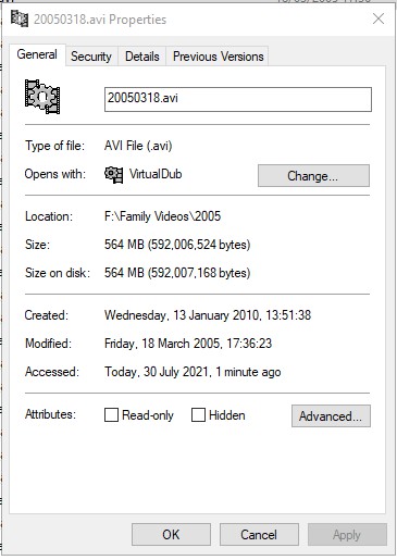

A quick question if anyone knows. When capturing is the date and time saved in metadata in the digital file? -
Could be. This info is from a DV file of mine shot back in the day (2005). I can't recall if it was captured with WinDV or Scenealyzer.When capturing is the date and time saved in metadata in the digital file?
Mediainfo:
Windoze:General
Complete name : F:\Family Videos\2005\20050318.avi
Format : AVI
Commercial name : DVCAM
File size : 565 MiB
Duration : 2 min 43 s
Overall bit rate mode : Constant
Overall bit rate : 28.9 Mb/s
Recorded date : 2005-03-18 18:36:23.000
[Attachment 60116 - Click to enlarge] -
