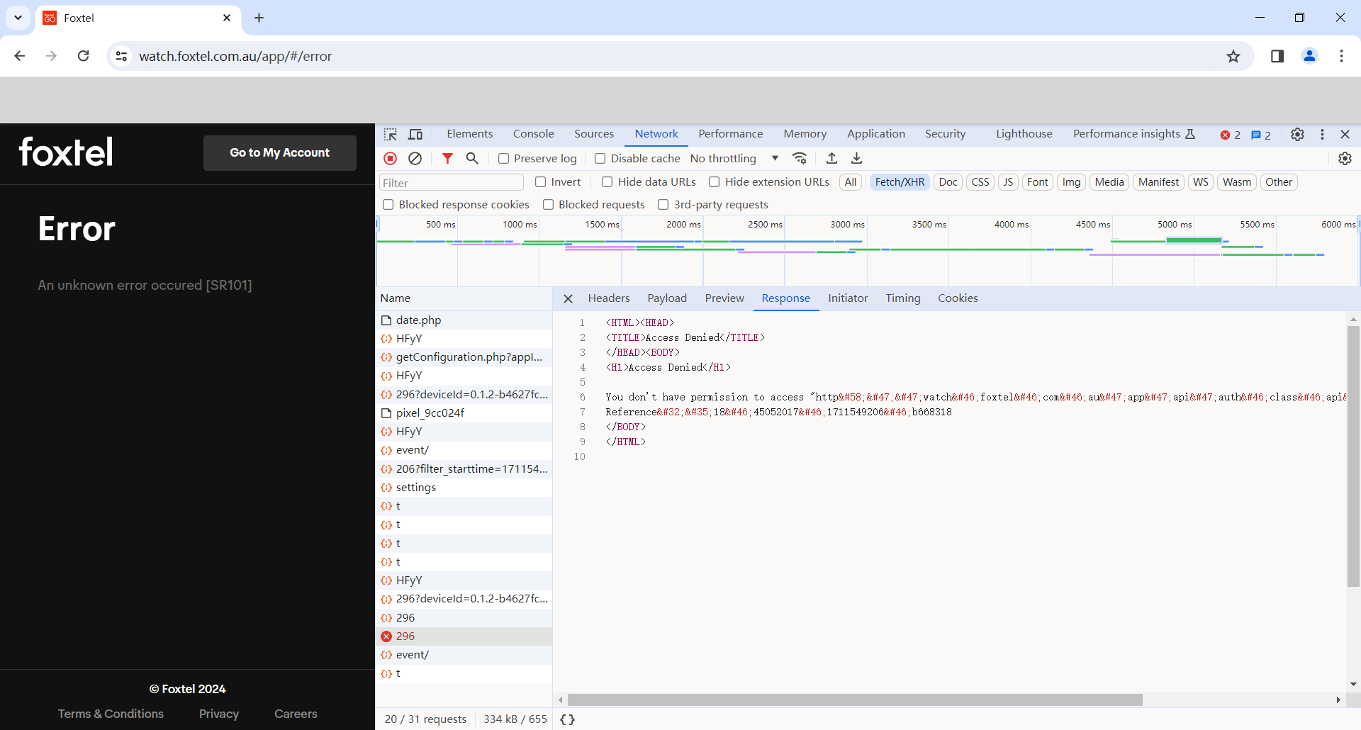

    1. Using selenium to create a Chrome window and then tried to log in:
    Returned 403
    [Attachment 77970 - Click to enlarge]

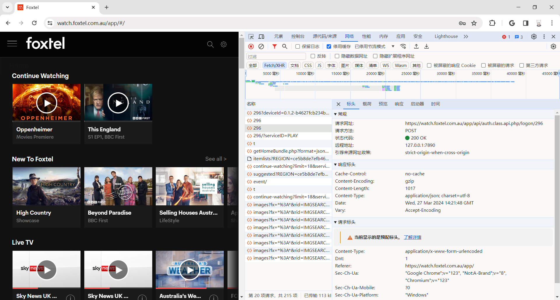

    2. In a normal Chrome window:
    Returned 200
    [Attachment 77971 - Click to enlarge]
    Wh...why? This is so strange��.
