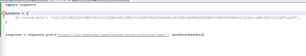

  2. You need to use custom data as only header, and append a missing section to the license:
    headers = {
        "Dt-Custom-Data": "TOKEN",
    License:
    https://lic.drmtoday.com/license-proxy-widevine/cenc/?SpecConform=True

  5. your key
    11abd93b658147d99c44c08371b2e06c:eca26cc41a7d5f8176c8645bb0d105d4
    my headers
    [Attachment 77100 - Click to enlarge]
