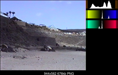

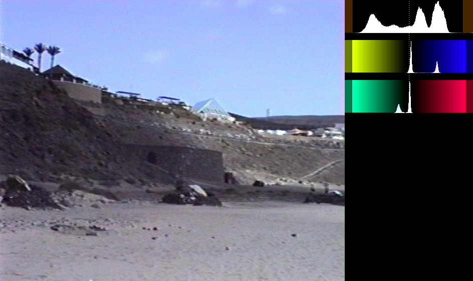

    When you "transfer" a miniDV tape is just a bit-by-bit copy of what is there.
    When you use a Camera as digitizer have little/no control, except addign an external procamp into the analog path.
    The levels in your Analog to DV capture "Seq1_amarec.avi" are ok. No deep blacks or high withes, related probably to the nature of the scene.
    What is imortant is that you do not have accumulations (i.e. high spikes) in the histograms ranges 0-16 and 250-255 levels, where the cards, more or less, start to cut.

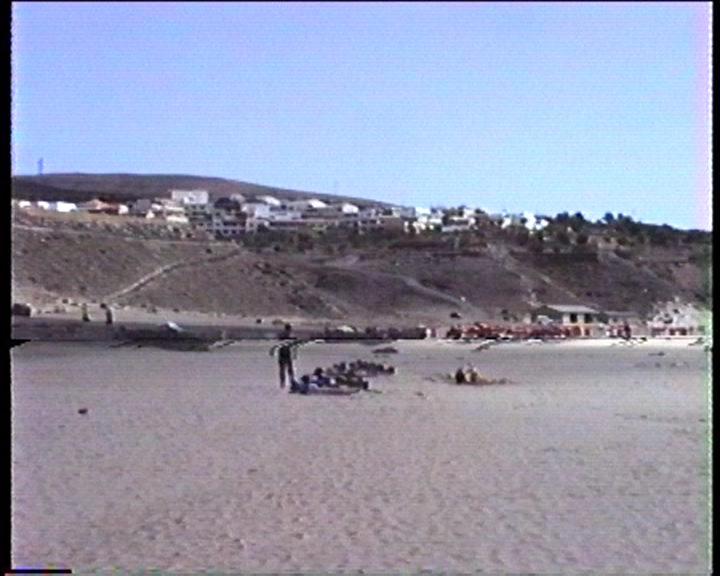

  8. Not sure why the DV version would have this horizontal glitch near the center , but the new uncompressed transfer does not. If it was a problem on the tape, I would expect it on both versions
    These use bob() - essentially a field resized to a frame . If you check a few fields before/after, no similar glitch appears on the uncompressed version
    (It's not a DV decoder issue; I checked a few different ones)

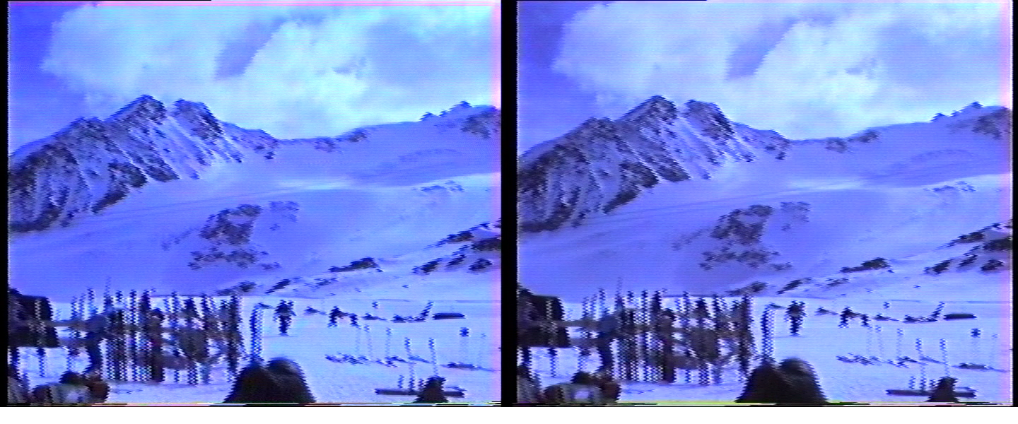

    OK,
    so here's another selection of nature shots. This time not beach and summer, but snow and winter. A lot of white and blue elements because of snow and sky. Again, my own capture with AmaRecTV and the 2008 DV one made with unknown equipment. Because of my capture chain I can't influence brightness and contrast levels manually but have to take it as it comes from the cam, just like with DV.
    What can you see?
    DV 2008 file in attachment, AmaRecTV file here due to size: https://we.tl/t-uGujYQCick
    Thanks a lot
  16. Haven't we been discussing this blue mess before, in this and the other thread?
    Aug 2018
    Wrocław
    MiniDV looks a bit denoised (probably in a rather simple way). You can probably extract more from the amarec version, but the final results should be similar.
    In such cases, good postprocessing has greater effects.
