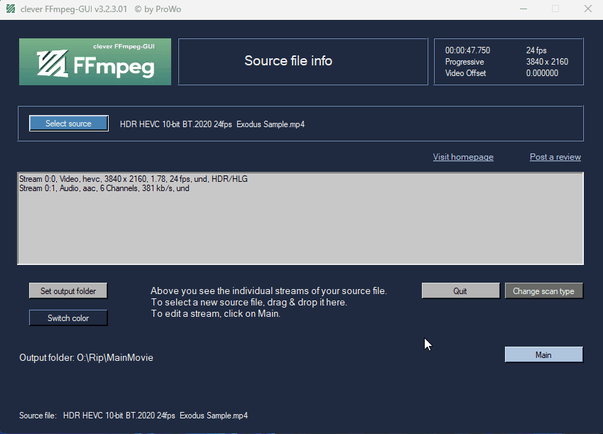

    Does Clever FFmpeg Gui do the tone mapping?
    Have you thought about implementing 2-pass into your program?
  6. Originally Posted by davexnet View Post
    Yes for the tonemapping (with LUTs too), no for 2 pass encoding, i prefer CFR.

  17. Last edited by ProWo; 30th Jan 2024 at 02:41. Reason: attachment changed
  18. Member
    Mar 2008
  19. Member Lathe's Avatar
    Nov 2007
    Sunny Southern California
    Thanks, I'll check it out!
