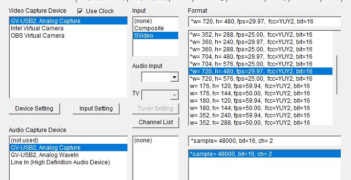

    Thanks for your response! I actually don't have a 29.97 fps option in amarec. I just have the 59.94 and 60 fps options listed. I've tried looking for a solution but couldn't find it!
    Oh that's weird. It seems the capture format options are determined by the digitiser and the GV-USB2 definitely captures at 29.97:
    [Attachment 75465 - Click to enlarge]
    I'm on the 1.1.0.93.5 driver (on Graph 1 Tab, click Device Setting).

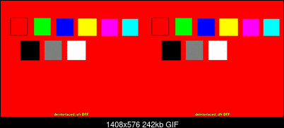

    Better than trying to describe: You can try out the various deinterlacing options with the attached file which contains 2 static distinct fields representing 2 individual pictures (no motion).
    Having said this, I would discourage the OP from single rate deinterlacing unless he has a specific reasons to justify it. One throws away 50% of the temporal resolution. What a waste of a good capture

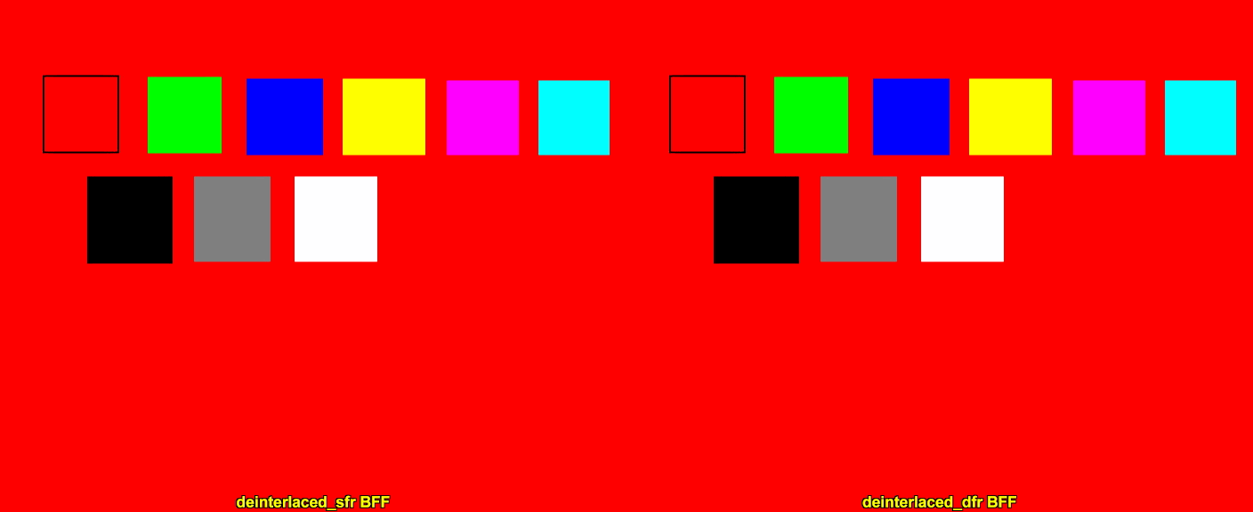

  6. Captures & Restoration lollo's Avatar
    Jul 2018
    Italy
    Nice example Sharc!
    I just added the output of your files using a simple script to show the outcomes:
    video_org=AviSource("0) 422i_.avi")
    ### de-interlacing
    deinterlaced_dfr=video_org.AssumeBFF().QTGMC()
    deinterlaced_sfr=video_org.AssumeBFF().QTGMC(FPSDivisor=2).SelectEvery(1,0,0)
    f_stackhorizontal(deinterlaced_sfr,deinterlaced_dfr,"deinterlaced_sfr BFF","deinterlaced_dfr BFF")
    function f_stackhorizontal(clip c1, clip c2, string t1, string t2)
    stackhorizontal(\
    subtitle(c1,t1,size=20,align=2),\
    subtitle(c2,t2,size=20,align=2)\

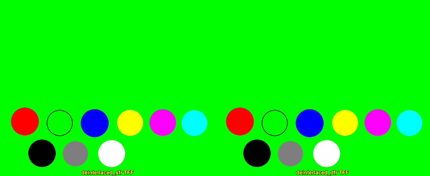

    ### de-interlacing
    deinterlaced_dfr=video_org.AssumeTFF().QTGMC()
    deinterlaced_sfr=video_org.AssumeTFF().QTGMC(FPSDivisor=2).SelectEvery(1,0,0)
    f_stackhorizontal(deinterlaced_sfr,deinterlaced_dfr,"deinterlaced_sfr TFF","deinterlaced_dfr TFF")
