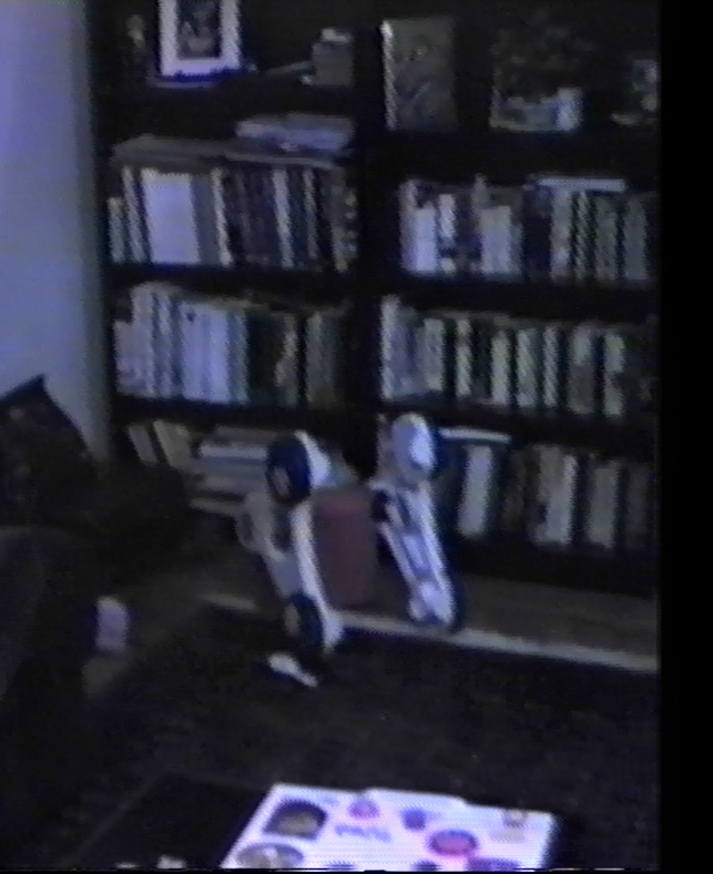

    So I finally managed to get everything working with a Diamond VC500 for converting VHS tapes. The TBC I have is a Panasonic EH-55. The problem is nothing is clear. People's faces are not clear. On the bookshelf image, there are dots on the books themselves, rather than showing the books as actual books. On the bottom image the dots outline even the cups and tables. I've read about rasterization and interlacing, but it seems it's neither of those. I tried deinterlacing in VLC and it makes things even worse and more blurry. What is the issue I am seeing?

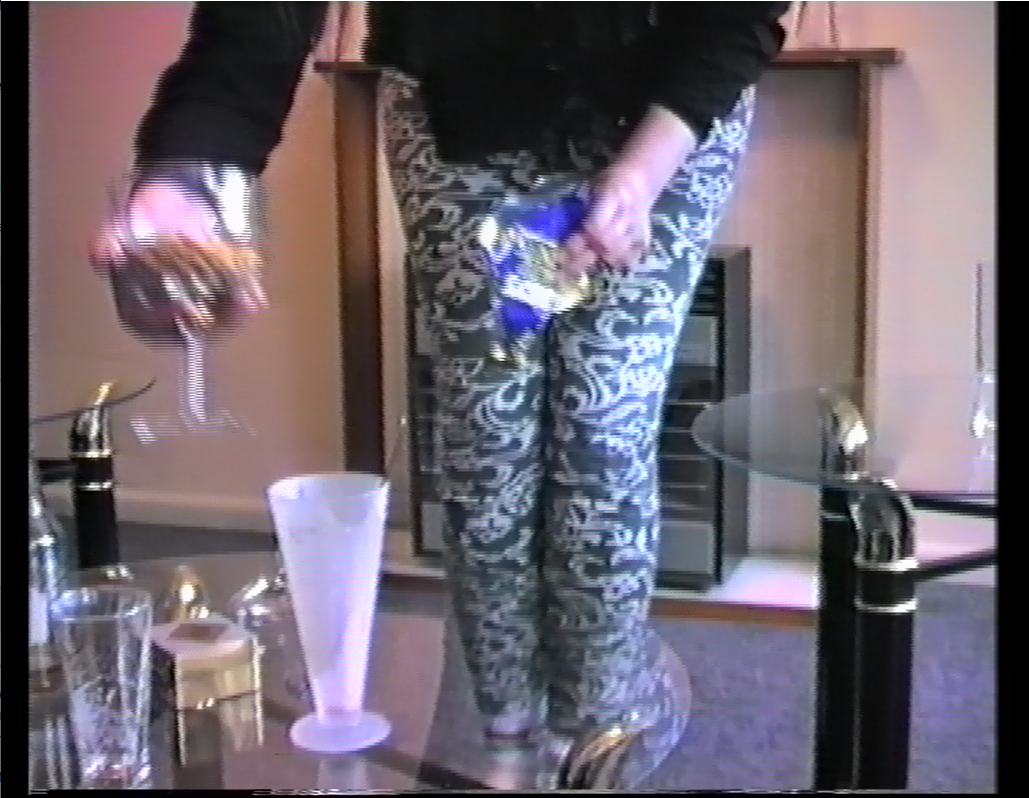

    [Attachment 75073 - Click to enlarge]
    [Attachment 75074 - Click to enlarge]
    [Attachment 75075 - Click to enlarge]
    [Attachment 75076 - Click to enlarge]

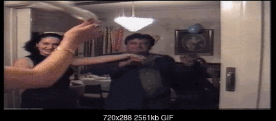

    Your frame grabs are combed. As for the speckles, I've seen them on the footage from old 1980s camcorders in low light.

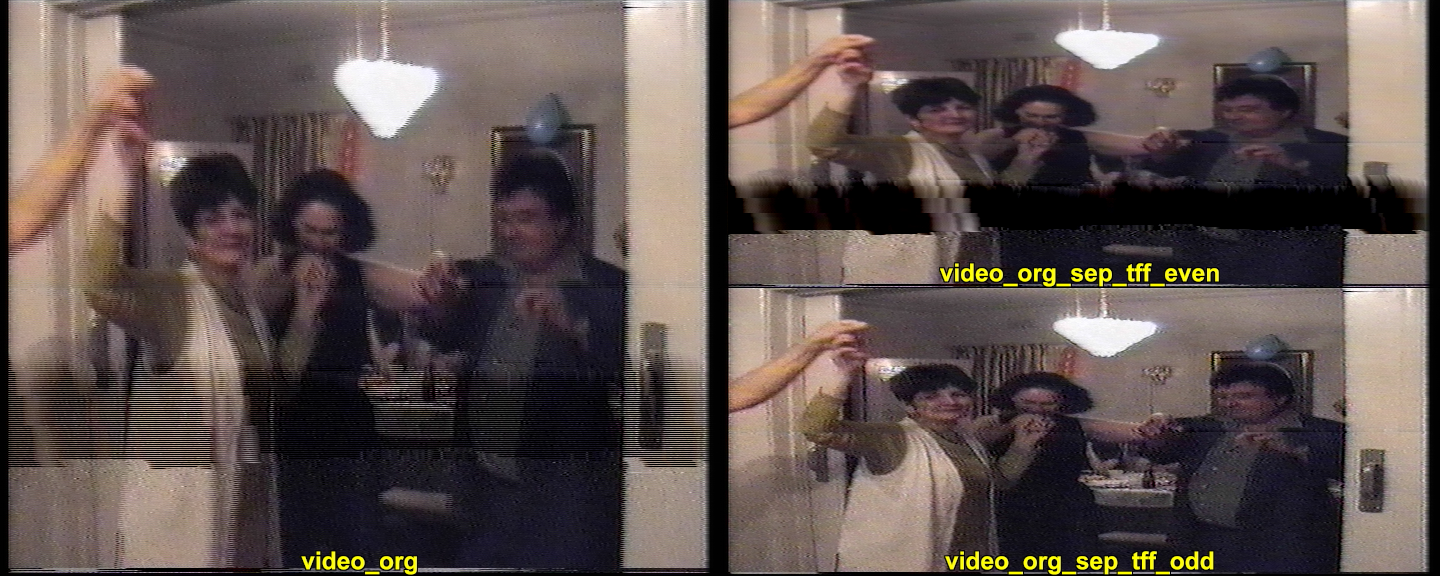

  6. One field of the interlaced capture is ok, the other field is very noisy.
    Options to fix it are for example:
    a) Single rate deinterlacing based on the good field -> loosing temporal resolution
    b) Bob deinterlace and denoise
    c) Denoise the separated fields individually using different strenghts
    d) Keep the good field only and synthesize the bad field from the good field
    a) and b) are easy
    c) and d) are more difficult

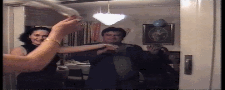

    Example for a) attached:

    Important is to analyze the root cause of the problem and think about ways how to solve it. For interlaced stuff the first step should ALWAYS be field inspection. The code is secondary. In my example for case a) it was as simple as
    AVISource("Sample Video.avi")
    BWDIF(field=1)    # ignoring field 2
    McDegrainSharp()  # or some other denoiser to taste here

    The fields can be checked with a simple script like this, loaded in VirtualDub:
    FFmpegSource2("Sample Video.avi", atrack=-1)
    assumeTFF()
    separateFields()
    Once the problem has been identified, the solutions proposed by Sharc are pertinent, being the odd fields all bad.
    Frame 175 is bad also in even field:
    To OP, try to recapture this tape. Does this field problem only happen with this tape?

    @Bigbadben, you can easily see the issue in Virtual Dub: apply the Deinterlace filter with "Double frame rate, top field first", then step through the video frame by frame.
    If you then choose "Keep Top" or "Keep Bottom" you'll remove the dodgy fields (but only get 25 frames/s, not as smooth as 50fps when you export).
